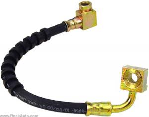

Well, I lost my notes for the extended front brake lines! Grrrrr...
From off the top of my head, I know that F-250 or SD lines will work, and are less than $20/pc. What I cant remember is the years of the F-250 or SD.
Anyone remember off the tops of their head?
The lines on it now feel kind of soft, and they are just a tad too short. They get bent inwards and end up rubbing on the calipers, which will lead to failure soon. So, If they are getting replaced, I want longer lines. The F-250 lines are a few inches longer.
i would get the braided type, i have them and the difference is major,, the feel of the pedal is far superior to rubber lines, and pedal to caliper control is awesome,,
Arent the braided ones non-DOT approved though? I have a vague recollection that they fail the "whip" test.
i saw d o t approved ones on a website today,
Ah well there you go.
Some are dot approved but most arent. Especially those found at a speed shop which os what I use.

any better??
i think they would do the job quite well
and seeing as they list them for this application they will probably have the right fittings for them as well ,
Summit Racing carries the entire Russell (owned by Edelbrock) line.
You can go on Russell's site, and determine which part numbers you need, then order them from Summit.
I much prefer going to the manufacturer's site to look at product - the retailers usually don't have as much product info on their sites...
For the record, the DOT-approved lines have a Teflon sleeve (or collar) between the hose and the crimped-on fitting, protruding from under the fitting for about an inch.
I believe that change was made to pass the whip test.

The shops here want well over a hundred bucks for a custom pair. They do not make DOT approved either, so, it just makes sense to me to get some already made for cheaper.
Right now, the stock lines are rubbing on the bleeders. The banjo elbow gets bent, from pulling, and forces the line into the calipers. I have tried bending them back, but they return. I know thats not good to do, as I'm sure it weakens the metal. Good thing this rig doesn't get many miles on it.....lol
