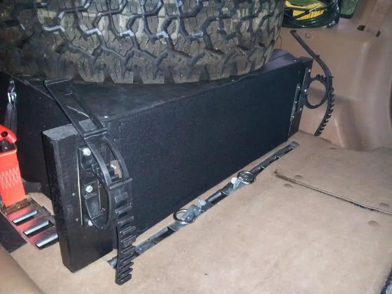

Finished up the cargo storage box, and got it installed.
E-Track is on all sides of it to secure the box itself, and misc items when needed. I have a small section of E-track, I might add to the top, of the front of the box, to secure the front drive shaft below the rear shaft. The rear drive shaft is secured by the large adjustable quick fist straps. They hold anything from 2.5"-9" in diameter. The back seat folds up and you cant see the shafts there. I do believe I figured out how to secure them safely. :)
If anybody was wondering what the big eyebolt was for... It is to hold the spare tire mount J-bolt. I added straps on it just for the heck of it, to see how well the E-track worked. I dig that stuff! :thumbsup:
The subwoofer box is coming out, and I will be installing a sub enclosure instead soon to replace it. Until then, no thumps. :thumbdwn:

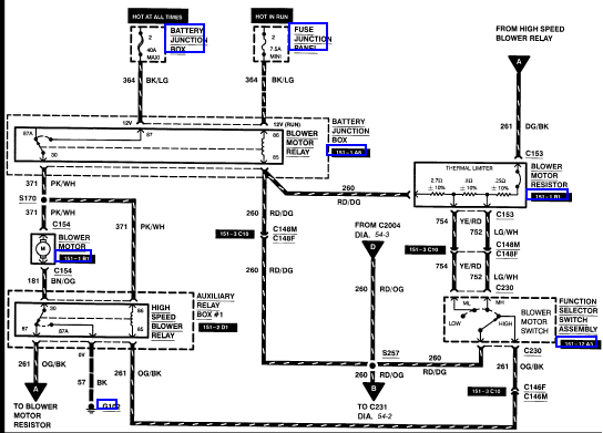

Windows were all fogged over so I turned on the defrosters, and the blower wouldn't turn on at any speed. Checked the fuses and all are good. It worked last time I used it back in November, but nothing now. I have no idea what to look for, or where to start ATM. :rolleyes:
We could use both heat & A/C in Moab. Any tips are appreciated!
The fact that it is not running at any speed tells me it can't be the resistor. If the resistor was bad it would still run at the highest speed.
Might just be a loose connection to the blower motor or resistor. Also, check the voltage at the connection to the blower motor and the connection to the resistor with the fan control in any of the on positions. If there is no voltage then there is something wrong with the wiring. If there is voltage then motor may have just gone bad.
Hope that helps.
Thanks, that is what I was going to do, as the connectors are on tight still. I will use another power source to the blower directly to check it. Swapping the blower is easy, but if it is the switch or something else in the dash......Not so easy for me.
Turn the switch to high and give the blower motor a few light taps with a hammer. Sometimes if the windings are corroded it will sit in a bad spot and you get a no go situation. If thats the case then a couple of love taps might free it up.
Tapped the blower and it started running. turned the selector switch from one side to the other, and it stopped. tapped it again, it didn't work. turned the switch, it came back on, until I turned the switch to the other side. So everytime I go pass the off position, it turns off, and won't come back on. That worked a couple times, then no matter what I did, it wouldn't come back on. Looks like a new blower motor is going in, if I can find one tomorrow.

I was thinking about the blower motor relay as well. The manual shows an arrow pointing to the pass side/underhood area for location. I glanced around, and didn't see squat. Autozone's repair section says the high & low blower relays are in a panel, in front of wheel well, pass side. I looked again... Umm...They be hiding on me, and doing a heck of a job at it too.
There's a small relay box under the air intake box. It should be attached to the inner fender down low on the front right behind(not behind, aft of) the radiator support. I can post up wiring diagrams if it would help. Let me know.
Here you go. Maybe this will help.
Thanks Al. That helps, and saves me some time. I am running out of time to prep for our big trip across country in 2 days. With all I still have to do, spending time diagnosing every individual part is just not in the cards for this issue. My only fear is it is the control switch.
Figures I have to remove more stuff to get at them. lol
