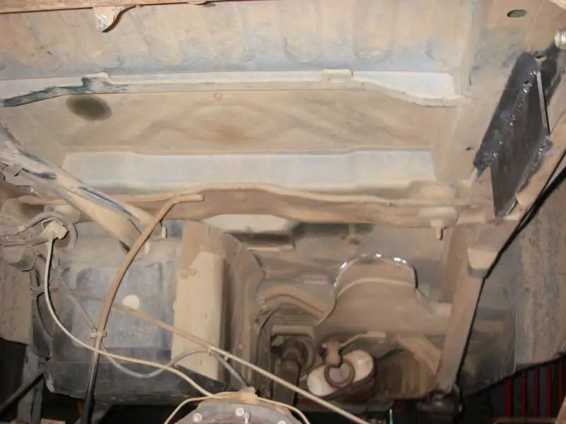

Last night we got the frame plated in on both sides and the lower shockmounts done. Today I'm going to try and get the uppoer crossmember done. Wish me luck!
Here is what it looked like before...

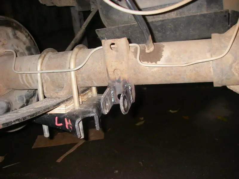

New rear shock tabs...I have the leaf pack taken apart down to the main leaf so I can cycle the axle. The plywood pieces help with not having to tighten down the u-bolts forever, and easier to line the axle up...

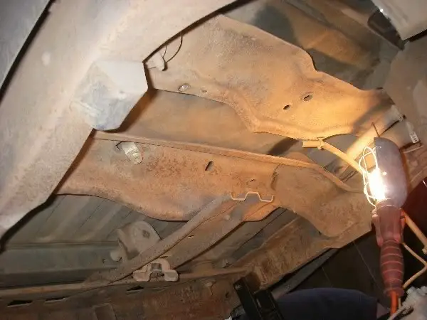

plated in frame, and a good shot of my pretty shackles, courtesy of the boys over at the Section525 fab shop...welding upside down on the frame with my lil 110 welder was a major PITA but it will work...
plenty of room to work with the stock rear crossmember and spare tire thingy removed...
