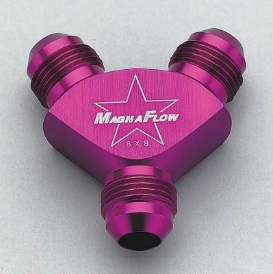

Ok, here is the list-
just to make the fuel lines look like they will work, instead of just working and looking ugly-
1) 3x -8 AN Y- block fitting ( to rid myself of the T)
2) -8 AN swivel coupler ( to couple the y to the "t" fitting with female fuel line fitting )
3) -8 AN cap ( to cap off spare "t" fitting)
4) -8 AN 45 degree swivel hose end qty 2 (supply connection at frame)
5) -6 AN union (regulator connection for return line)
6)-6 AN 45 degree swivel hose end ( return connection at frame)
7)-6 AN 90 degree swivel hose end (return connection at regulator union)
8) 3' -6 AN braided hose
9) 6' -8 AN braided hose
jeg's = $168.XX
summit= $153.XX
Did you find the "Y" blocks for about $24 each, that's what I noticed recently? They had other versions that were closer to $60 each. I just wanted two for trans cooler lines(PTF) ends.
They do have cheaper y blocks-however by the time you put 3 -8 an unions in them it adds 30.00 more---
so, I am opting for a purple colored tripple "AN" fitting Y-block
It is 36 bux-

That's very nice for fuel lines, good choice.
