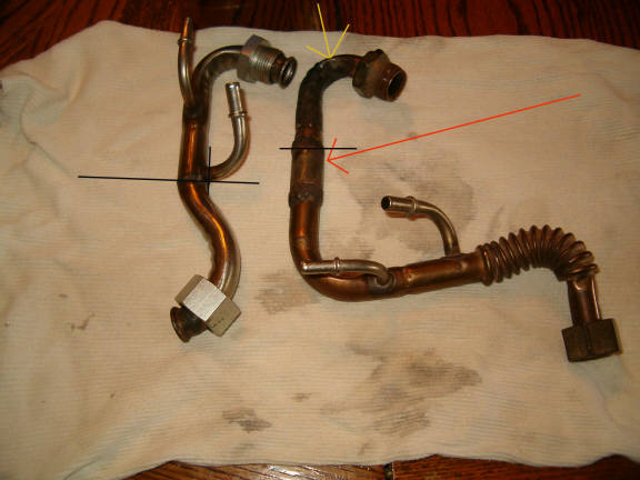

Well it looks like the best thing to do would be to start a new egr tube-the hole at yellow arrrow is huge--
Eric (techieman33) was very kind and left me an extra tube-
If you look where the red arrow points you'll see a larger tube used as a sleeve-
I'm gonna cut it off and try to get the opening cleaned out to accept the new tube-then weld up around it-
As you can see I have the upper neck angle bent in pretty well--
Black lines show where I plan to cut--sound good?
Then I'll need to cut the extra tube off and weld that hole shut-which is what started this whole mess-
My egr tube was "working fine" even though it had an extra capped off tube sticking out-I should have left it ugly--
