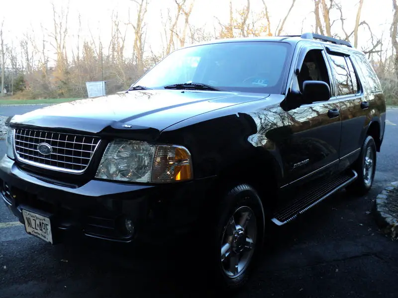

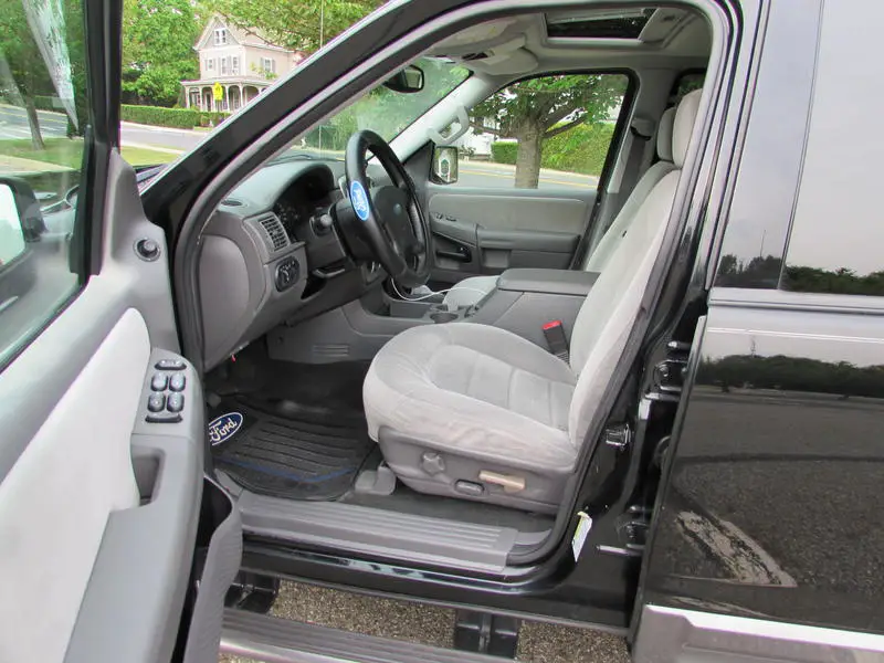

After the professional detail, the car is BRAND NEW. It looks even better in person.

Looks good Tyler. Does look new.

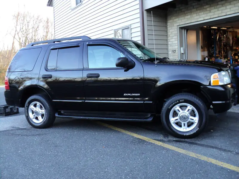

Gave my new to me 3rd Gen some love today. Good old fashioned hand wash and wax. Followed by some chrome and gray center caps, new window visors, bug deflector and floor mats.
Hopefully it'll stay this way for a day or two.
and 1 more very personal touch......
New bigger rubber next.....so much wheel well, so little tire.

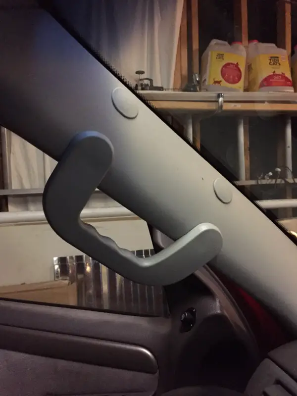

Finished up the drivers side grab handle. Installed it a year or so ago but left the hole plugs at the wrecking yard. Finally picked them up, finished the hole so they fit.

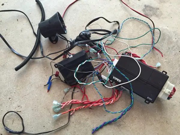

Apparently this discussion isn't as popular as on the 1st and 5th gens. Seeing as I was the last person to post back in March.
Anyway. In 2008 or so my '05 was mistakenly repo'd. Came out one morning to find it on the curb, facing the wrong direction. Should have been in the driveway. Wasn't until talking to the neighbor a couple days later that I found out what had happened. Repo truck took off with it and then brought it back after realizing they were idiots.

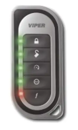

In the mean time, I paid $500 to have this Viper 5701 installed. Overall, the alarm was nice, I've had Vipers before. BUT, the key fobs were the biggest POS's I've ever had (to loosely quote Viper after I called them "these are our most popular fobs.")
More times than I can remember, we'd come back to the car only to find it running. Even if we utilized the "lock remote" function. In my pocket or my wife's purse, the remote start would get activated.
Now, almost a decade later, I finally removed the POS having not used it for some 7 or so years.
Why haven't I used it in 7 or so years? Because the remotes got intimately close to a 5lbs sledge hammer. Photo of what fob should look like attached.
