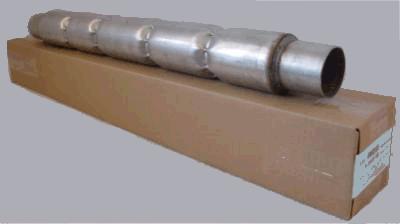

Teaser: I ordered this a week ago and hope it shows up soon!
Cool! What am I looking at here?
Classic Chambered Powerstick
2.5" IN/OUT with 2.5" core
30" Main Body Length with 2.5" long connections.
Model: TUNDRA
It should just barely fit up underneath the car in place of the factory muffler. And should (hopefully) make this thing actually sound like a V8 :cool:

Ok very cool. So this is meant to beef up your exhaust sound. Haven't heard of these before. You'll have to update us when you get it in!

Awesome! I'm really curious about this thing, since I foresee a bit of exhaust work in my own future. Does this go in place of a standard muffler, or is it in addition ?
Ok, got the muffler in Friday and I gotta get my exhaust tweaked a bit. Friday morning just sucked. It was grey, cold, and raining to start. Next when I got the exhaust shop the ugy was surprised that I came to an exhaust shop for a muffler swap...??? :crazy: Then just continued to be extremely rude. "why would you want to put that thing on? You know it's gonna be louder right?" "That thing won't fit at all, probably cant do it." "It won't fit unless I make a whole new tail pipe which is gonna be a pain in the ass cause the explorers suck to work on." "It would be $150 for the tail pipe, $75 from the cat to the muffler and $25 to install the muffler." "Oh you want me to do it? Well go take a walk cause it's gonna be a while." So I called my dad he headed down so we could run errands while the explorer was getting worked on. Right after I hung up: "Cancel your ride, we're gonna make it fit and have it done in 5 minutes." Three guys were horsing around on my exhaust piping and new muffler forcing it to slide onto the existing exhaust. Then when it was time to pay: "Alright it's gonna be $50 cash." Well I didn't bring $50 bucks in cash with me..:( "Well it's gonna $80 if you use a card. OK FINE, $80 it is then" Then continued: "You're gonna be back real soon. Better grab that old muffler cause either your gonna hate it, get plenty of tickets, and if that doesn't do it, your parents will make you come back and get it ripped out and the old one put back. You'll be back in just a few days I know it."
Just on and on with being rude.... Not one "Hi how are ya? I'm so and so" or "thanks for your business" Each three guys were annoyed that I was their only customer friday morning and had zero interest and befuddled as to why the hell I came to their exhaust shop for exhaust work... And on top of that, the guy welded a whopping two joints and the rear one LEAKS... BAD! There is welding wire sticking out all over each and they look like pure ****... So, do NOT ever go to B&D Exhaust if you are anywhere near. Just horrible..
Now for the muffler: Sounds a lot like a glasspack.. Which if you listen to countless youtube vids these are supposed to sound very different from galsspacks. It's probably having 3 cats doing that... But the DRONE... from 2000 to 3000 it just drones the inside worse than I was ready for.. Friday morning I worked up to be pretty horrific cause of everything leading up to that point but after a ride yesterday with my friend it wasn't near as bad as I thought it out to be but cruising @ 75mph running 2400 rpm I won't tolerate the drone for long. So I'm going to one of the better Monroe Muffler shops around and A) Getting those crap welds fixed up hopefully and B) addressing the drone. I'm currently hung up on three options: 1) J-Pipe resonator @ 21" or 22" to eliminate the 155Hz drone I have, 2) let Monroe install their usual resonator that use to fix drone for people, 3) try cutting 6" to 12" of my tail pipe off to change the resonance of my tailpipe. I'm keeping true to my usual madness of over thinking, deep researching, and analyzing each option to death....
