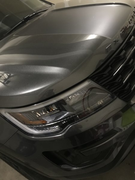

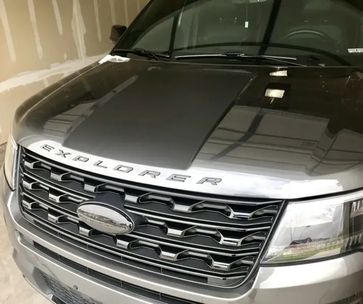

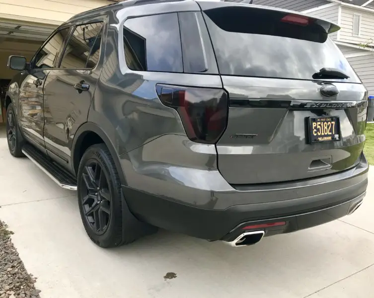

Just a quick update... Finished tinting the taillights, emblems, and fog lamps. Also, vinyled the center of the hood. All in all, a great day spent doing a little bit for the ride. Next up will be an led bar install...
