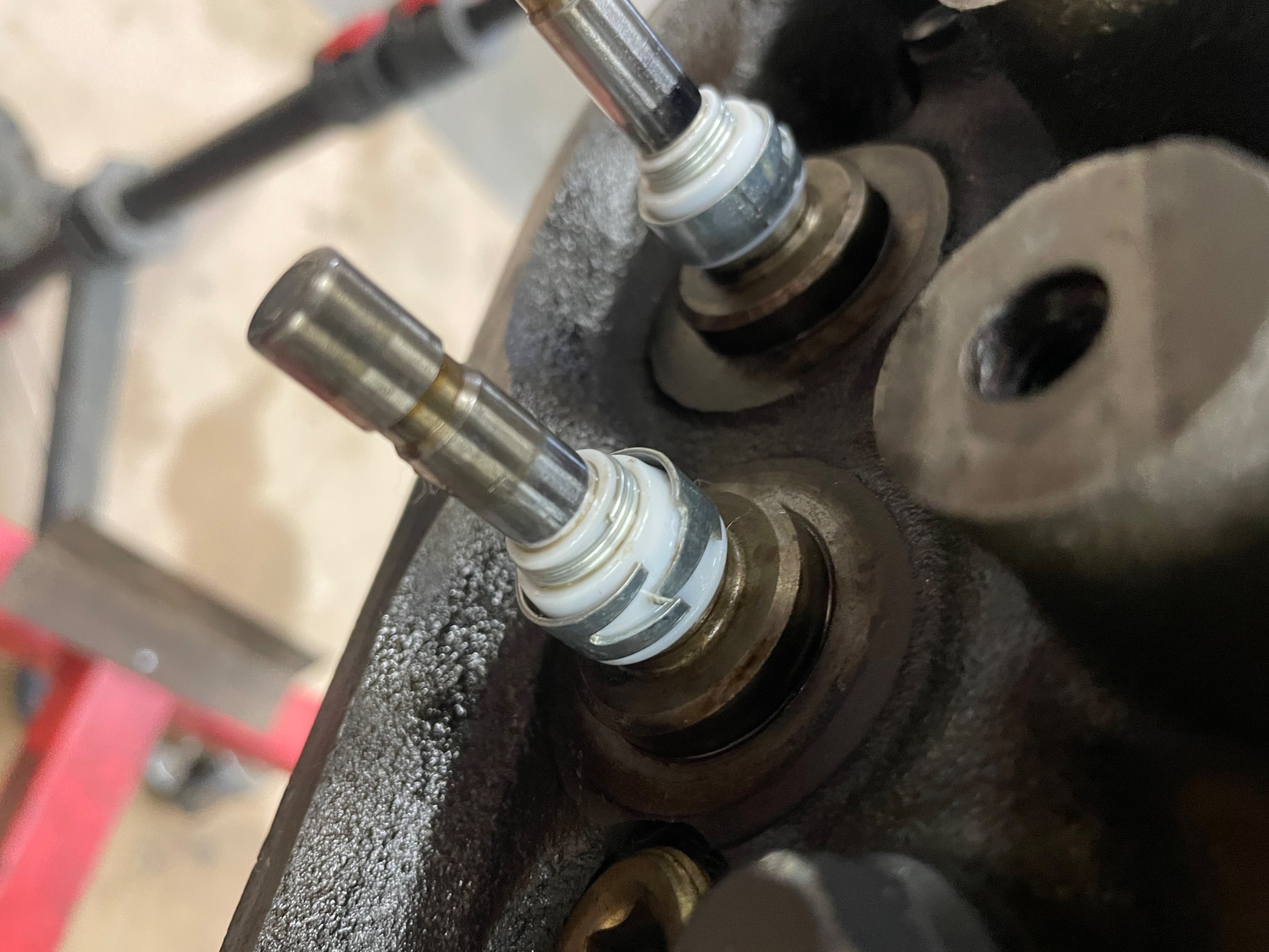

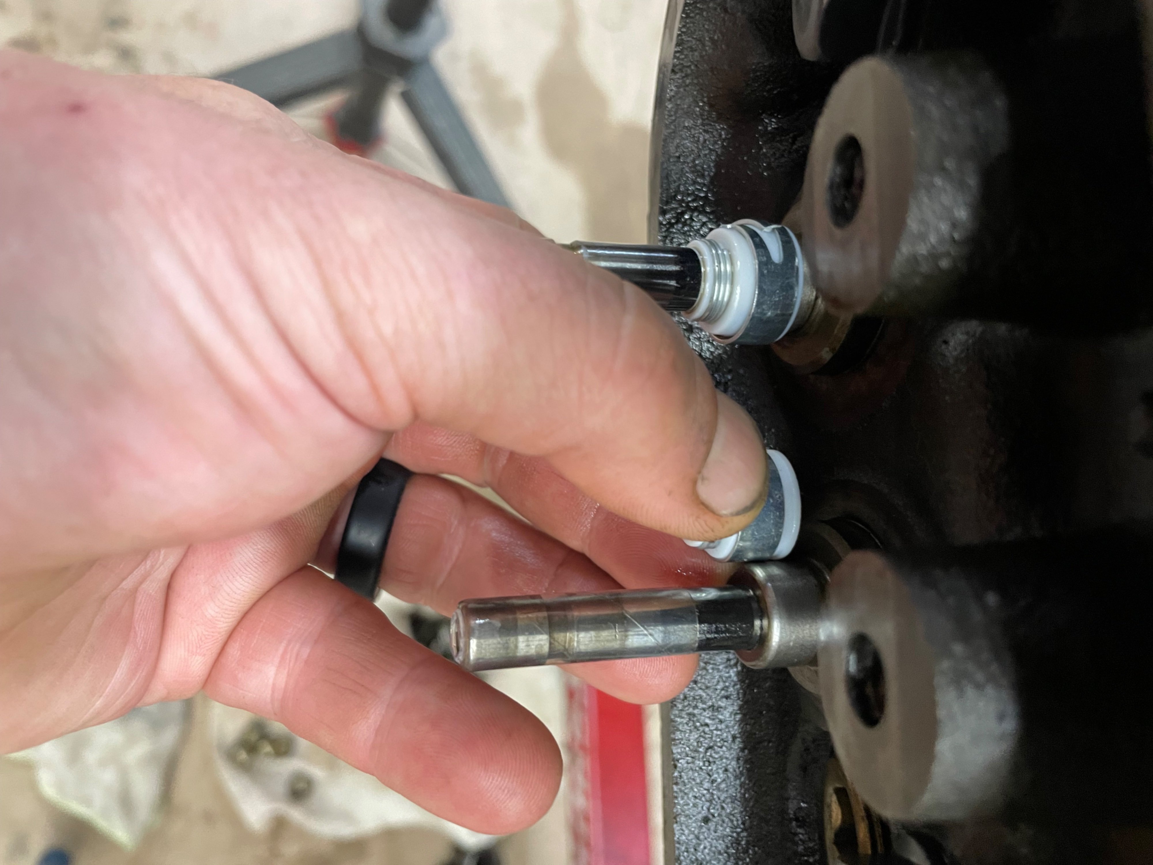

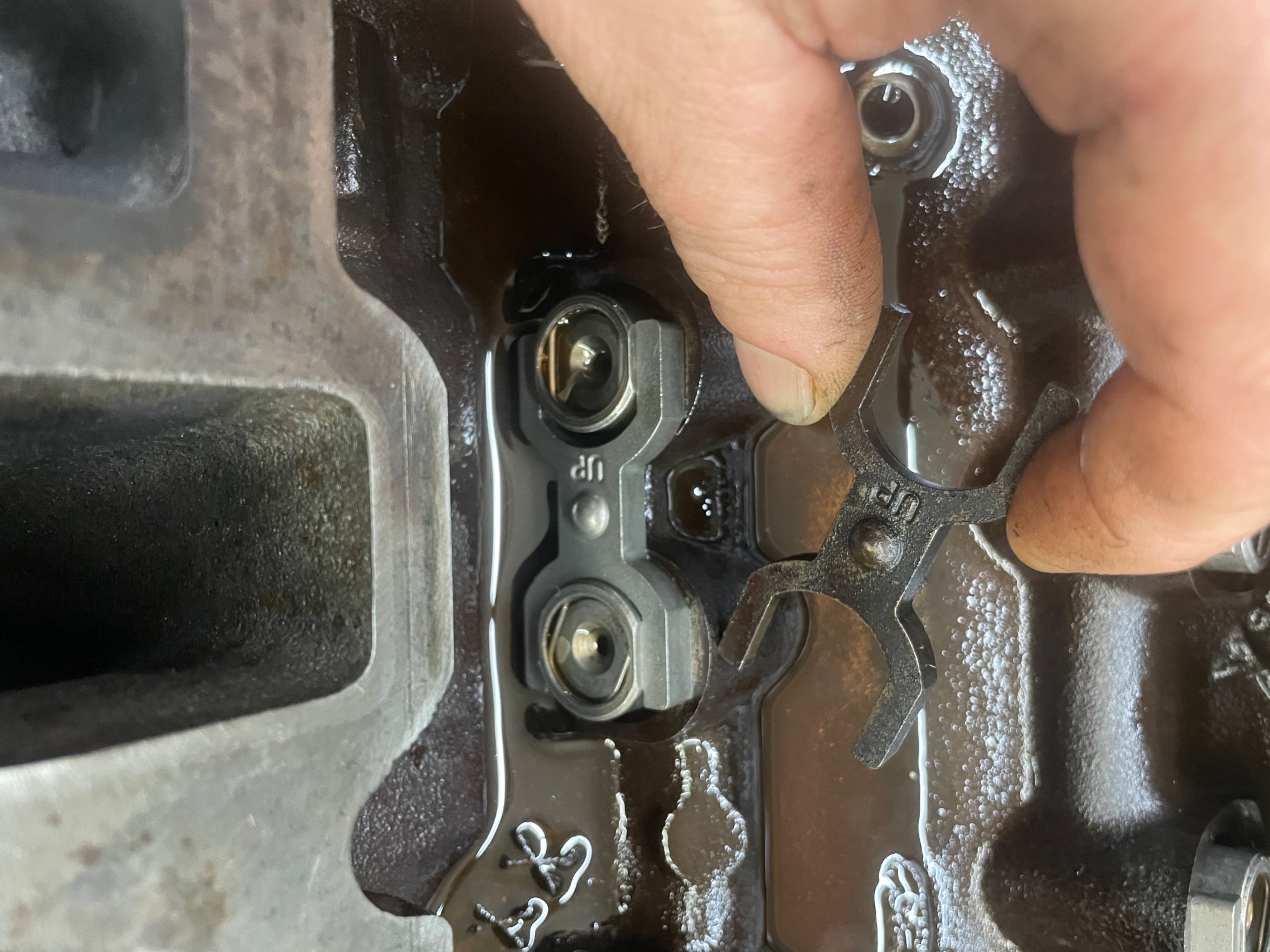

Depth check

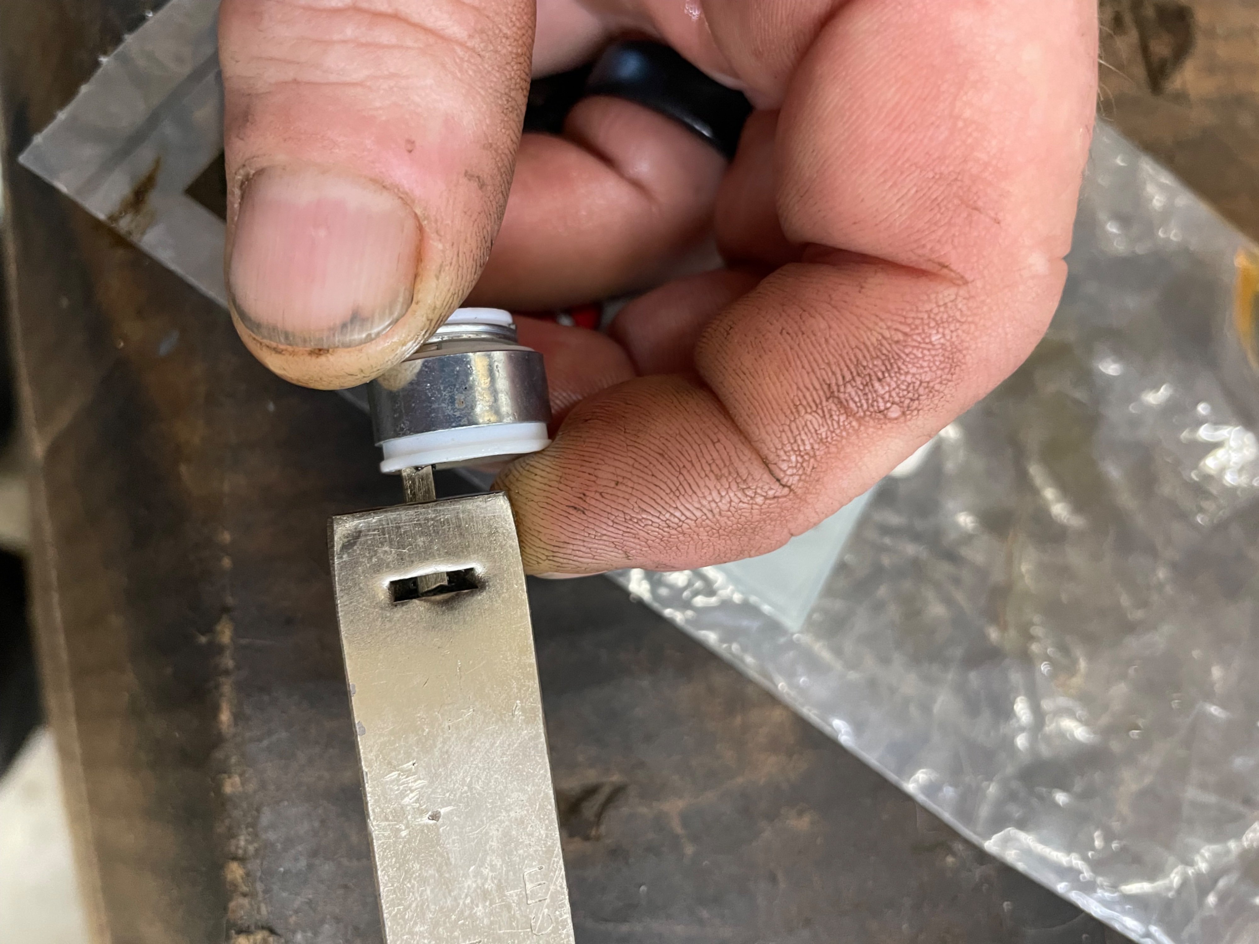

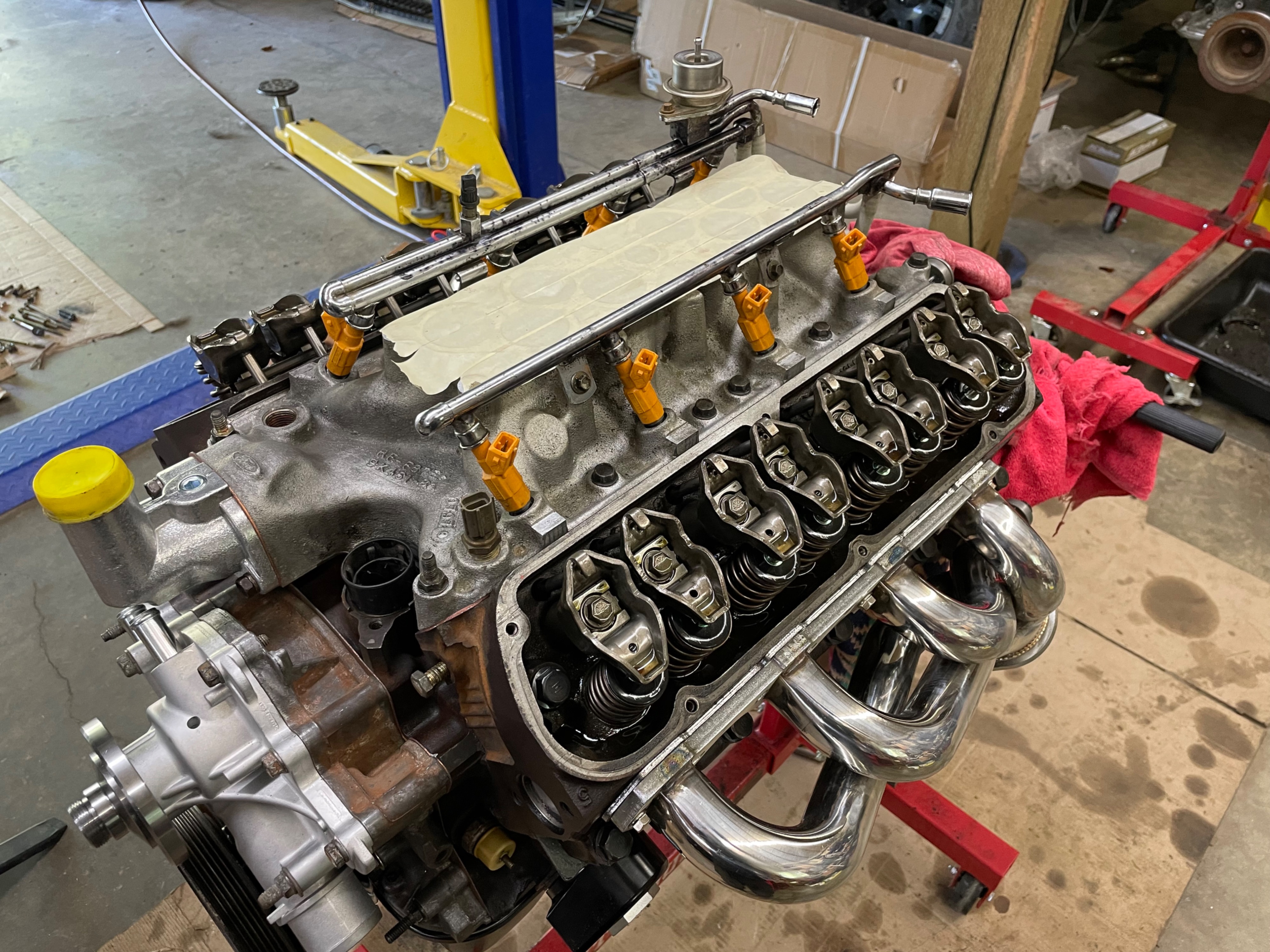

Not nearly as deep mounting surface as the stockers

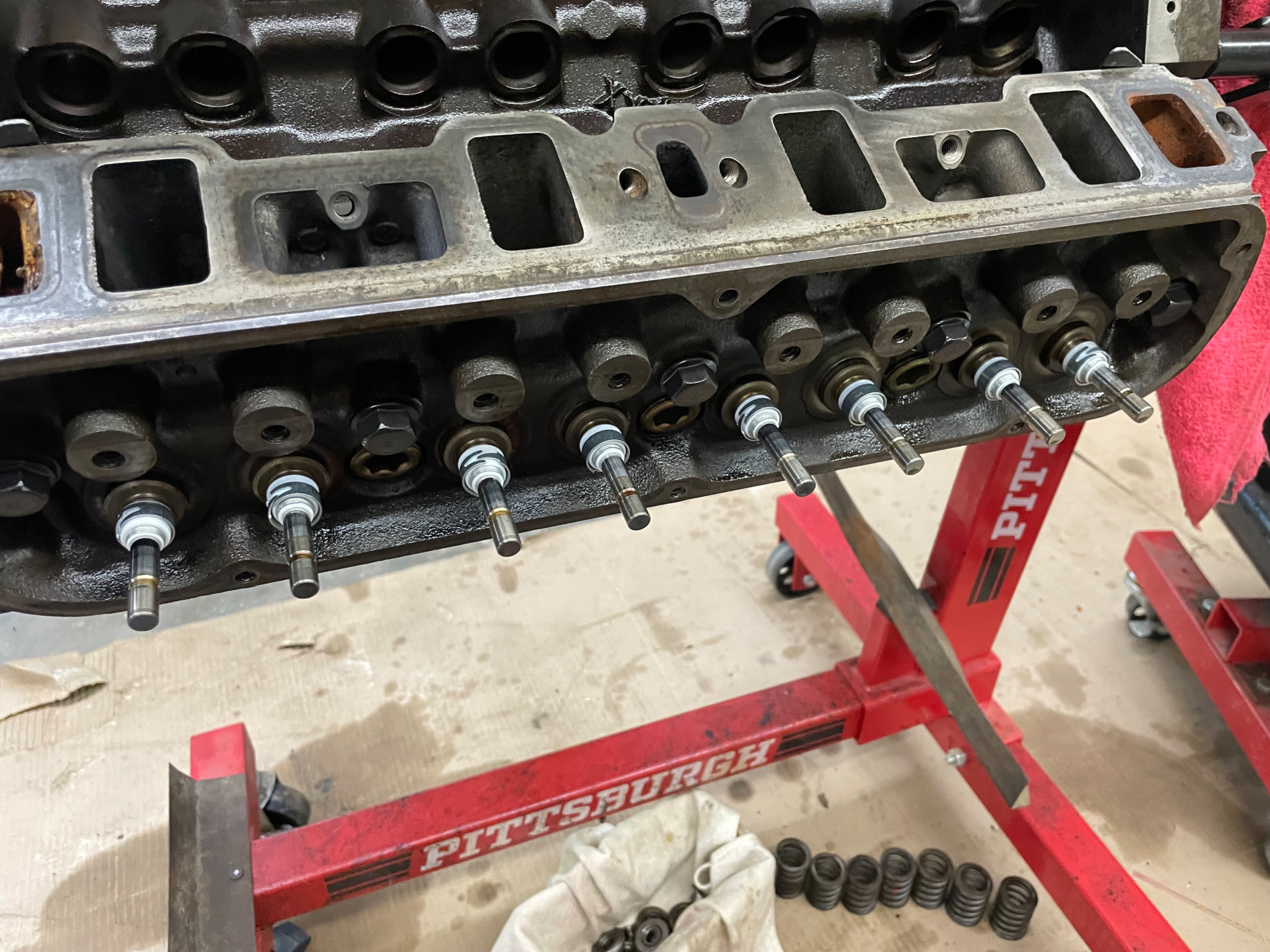

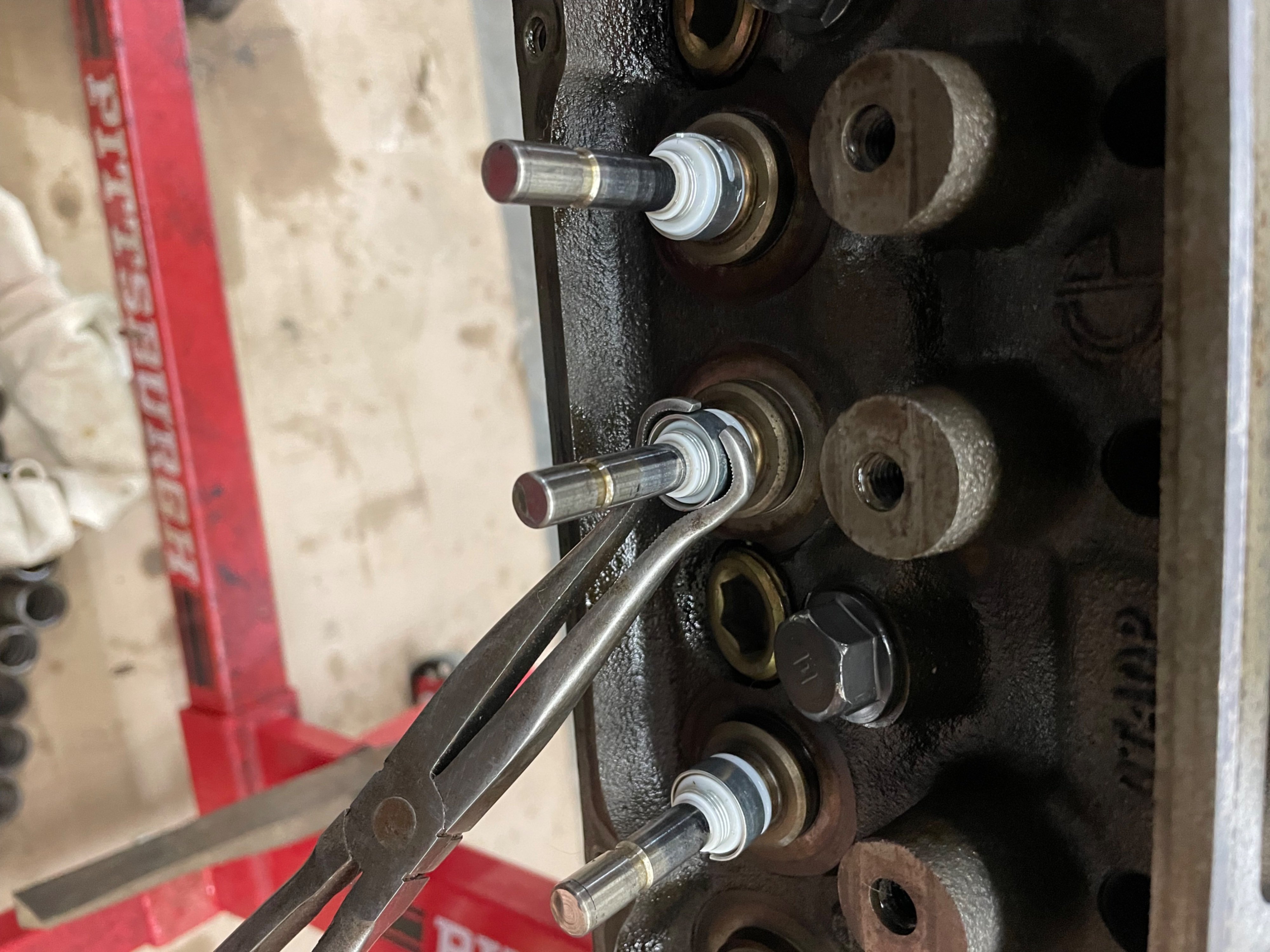

Making sure each on is pressed fully

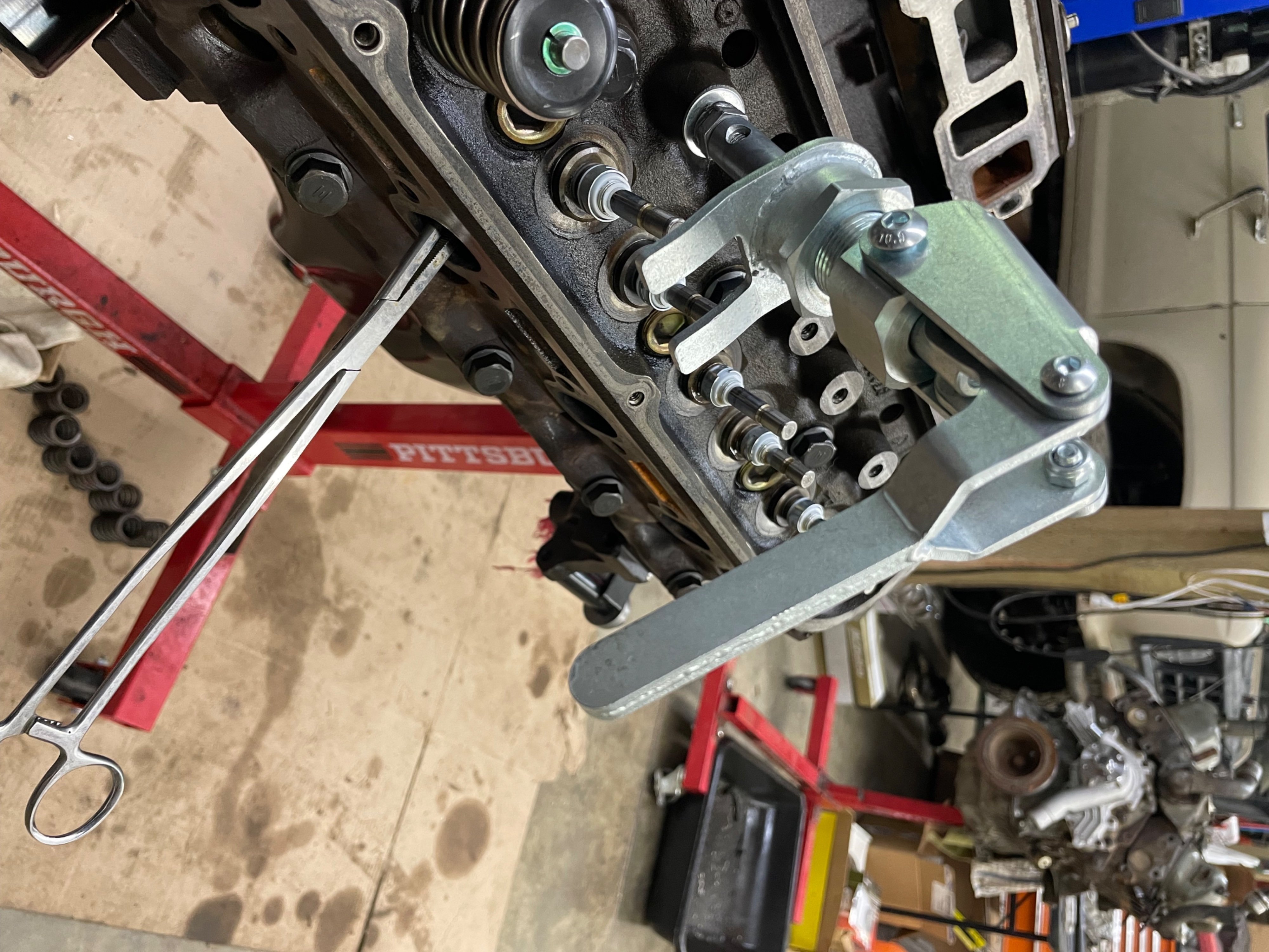

Then you have to go through and seat all the springs
Make sure they are pushed all the way on to the back lip
Like this

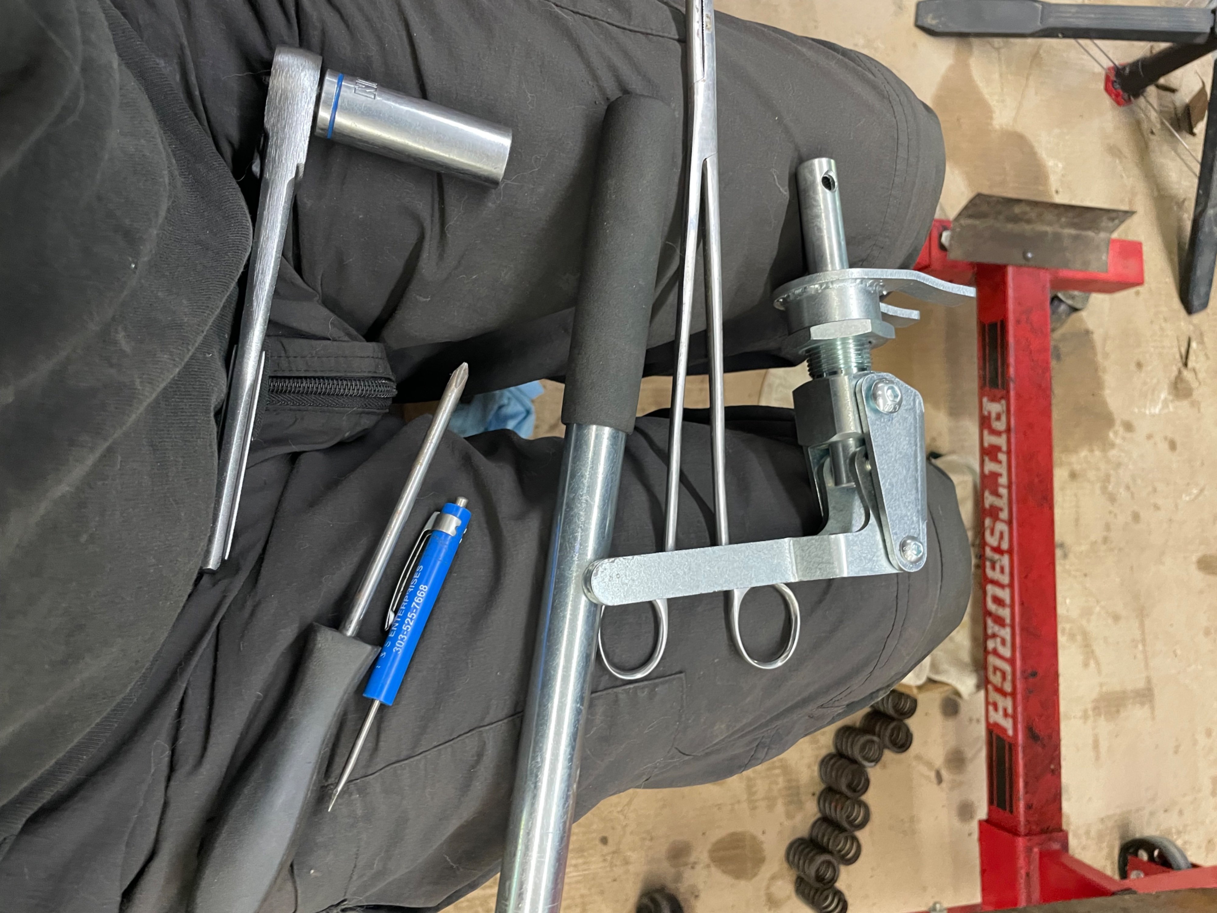

The magic pliers are used to seat the springs. I love having the right tool for the job

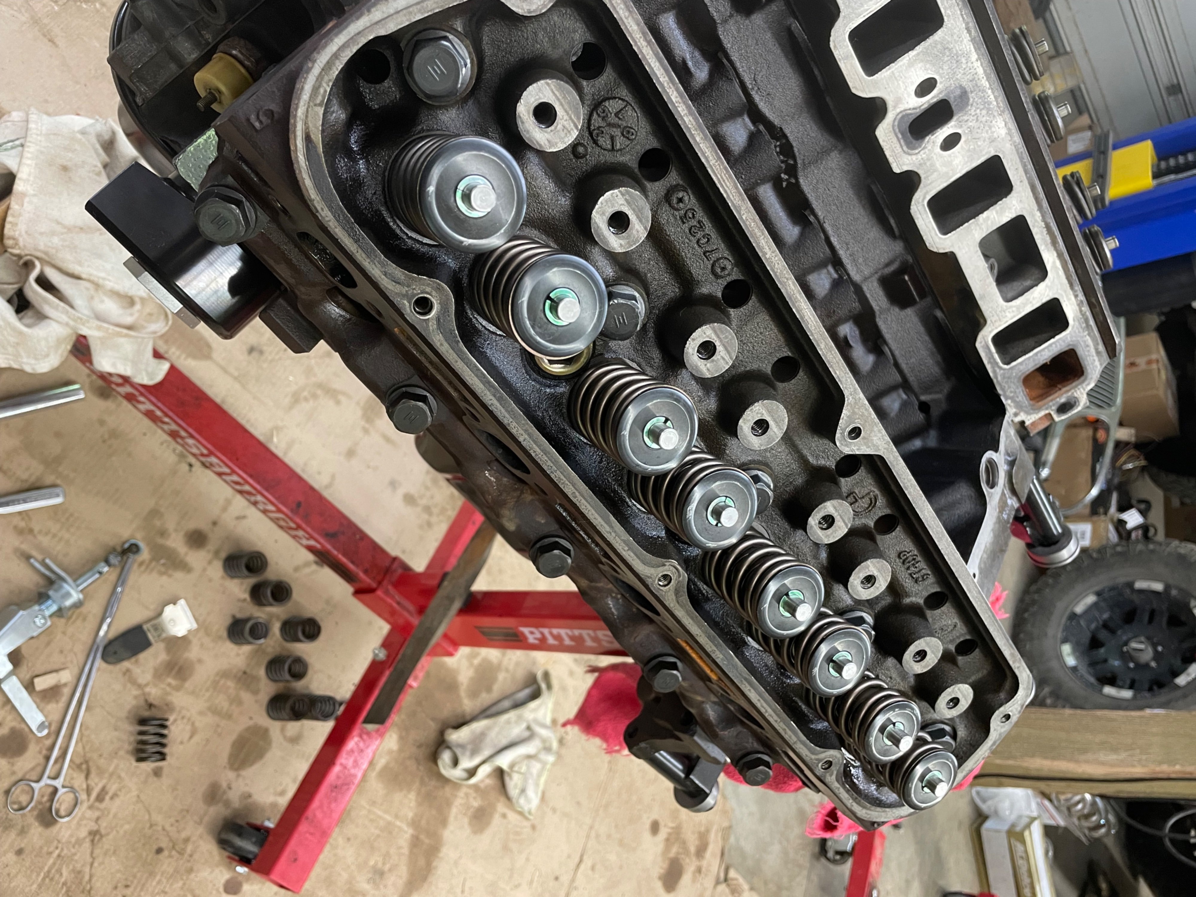

All 16 on this side done

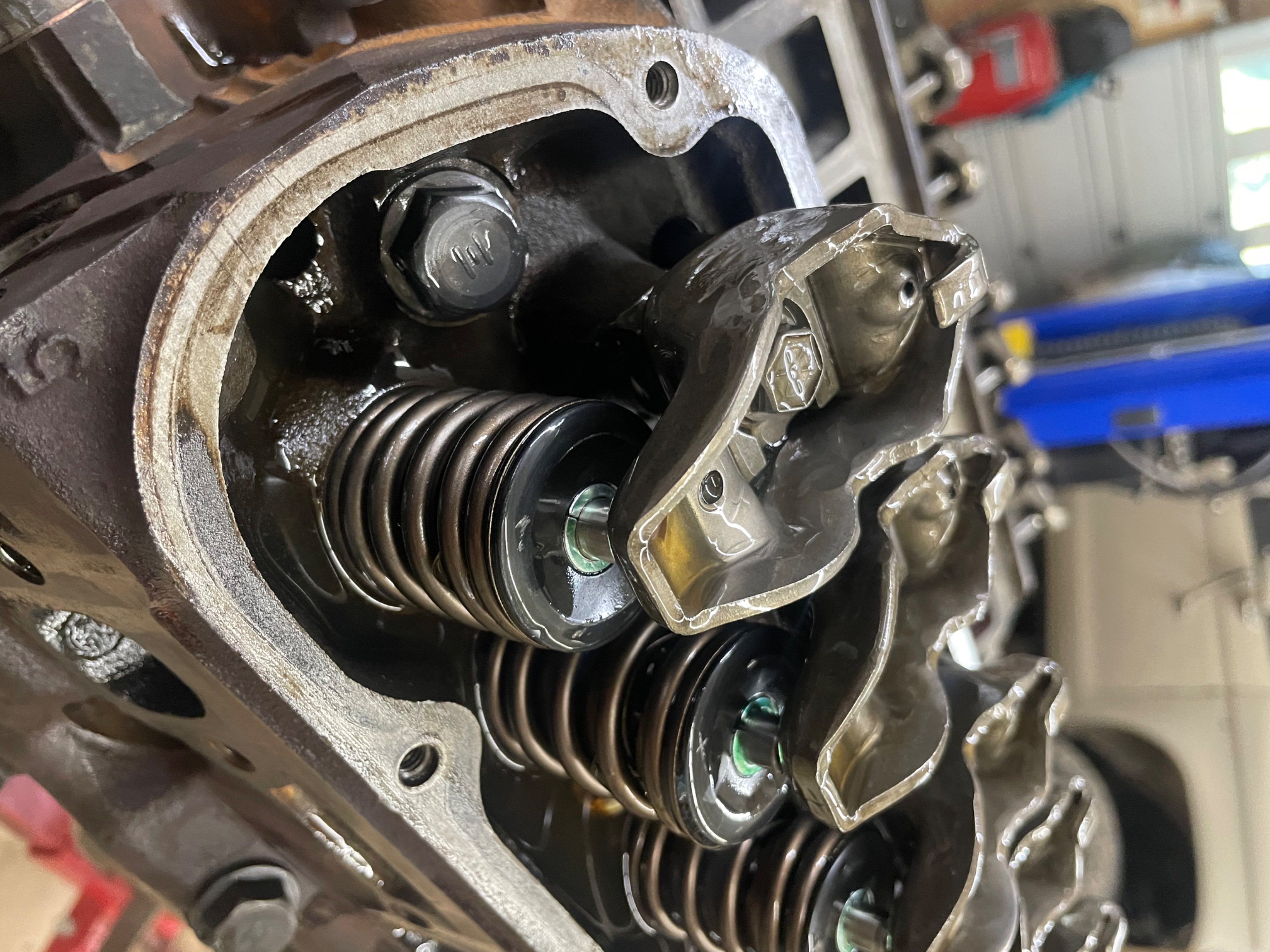

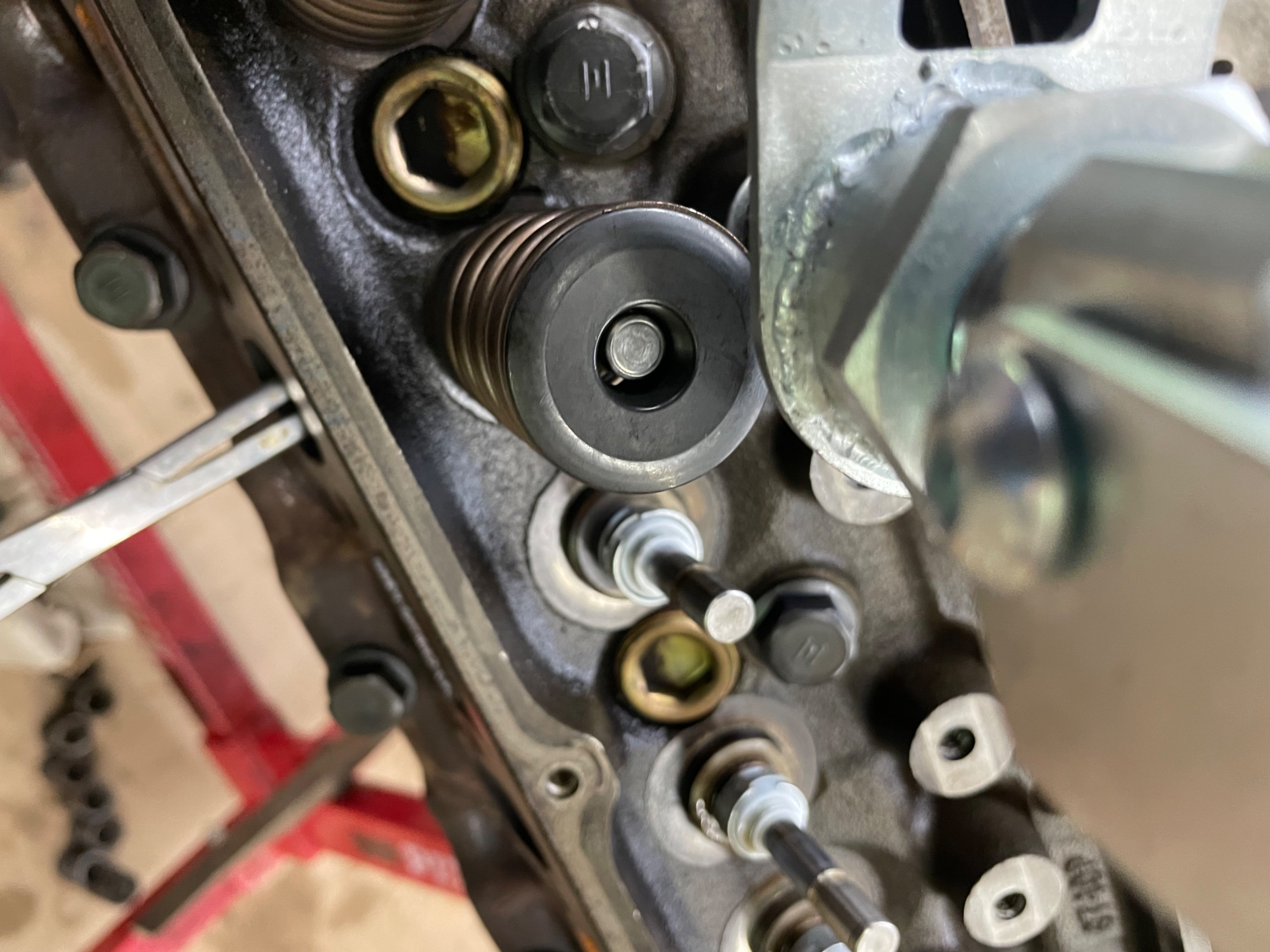

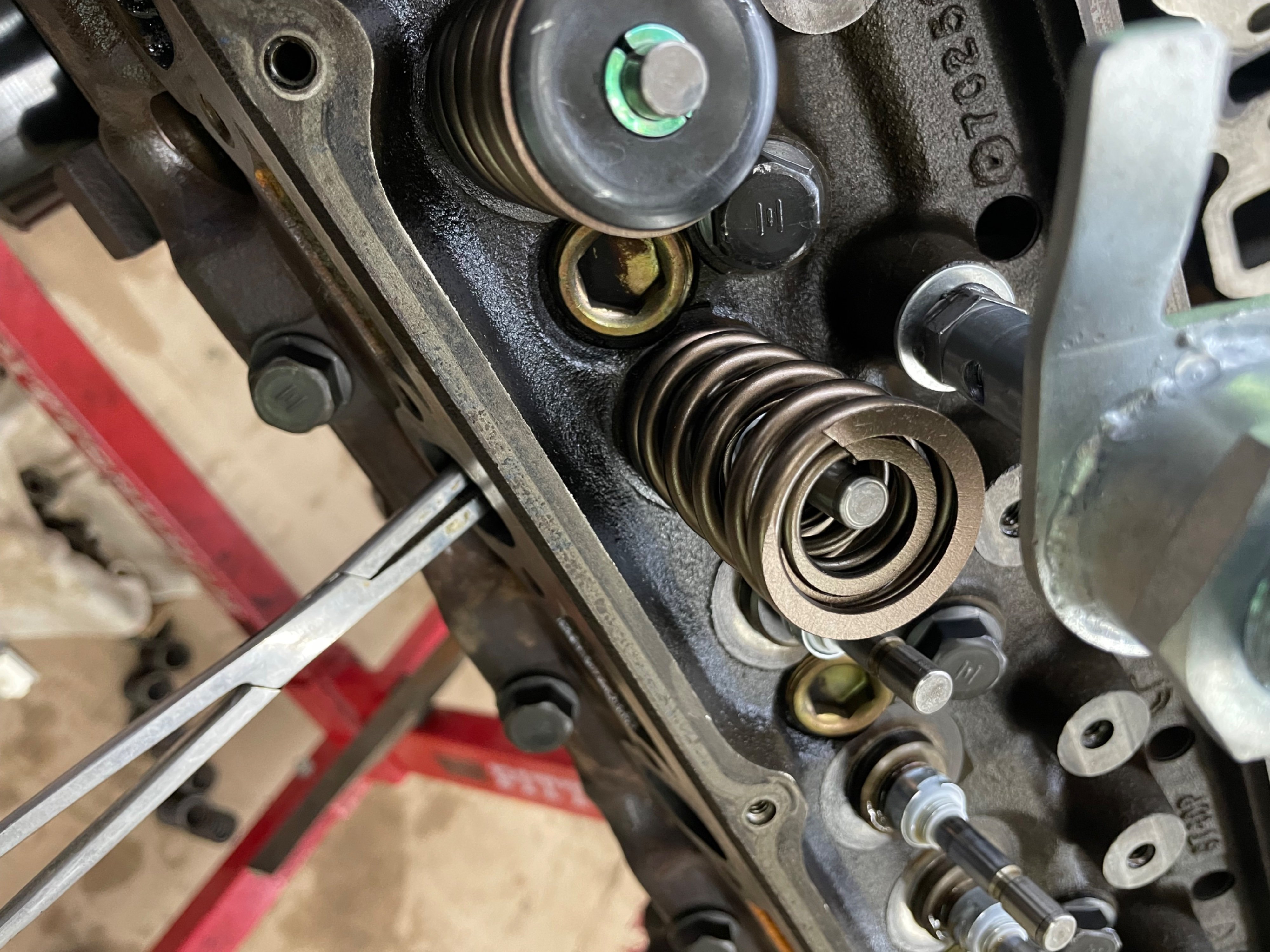

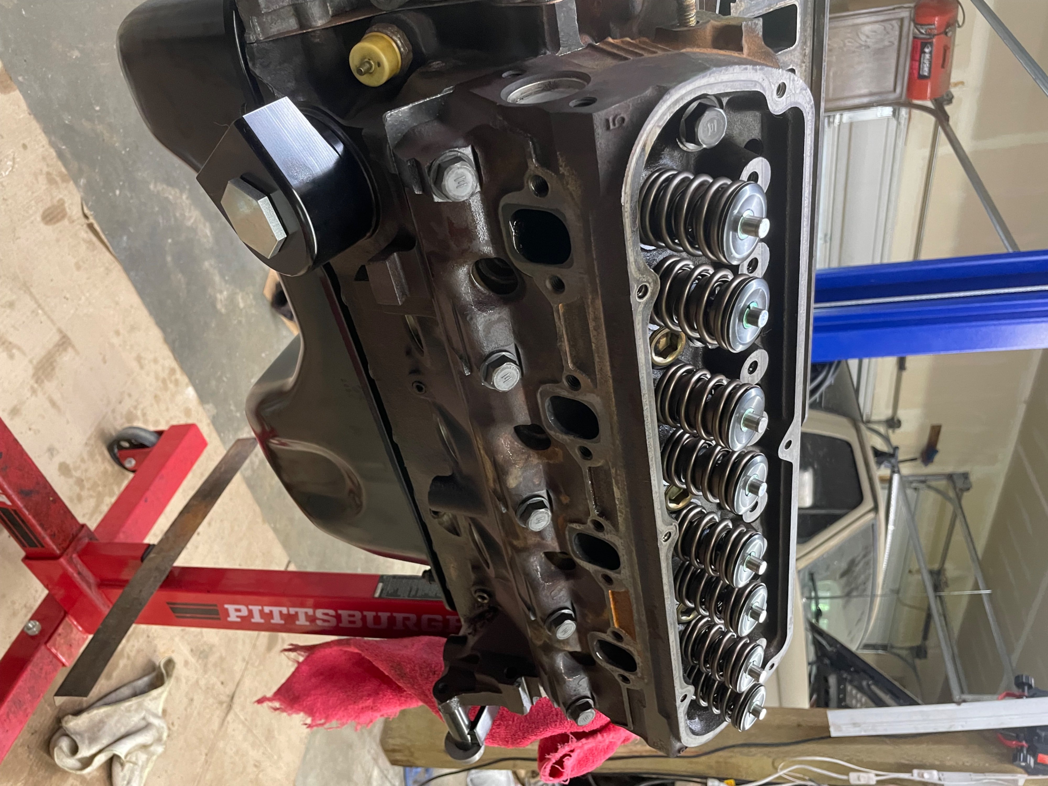

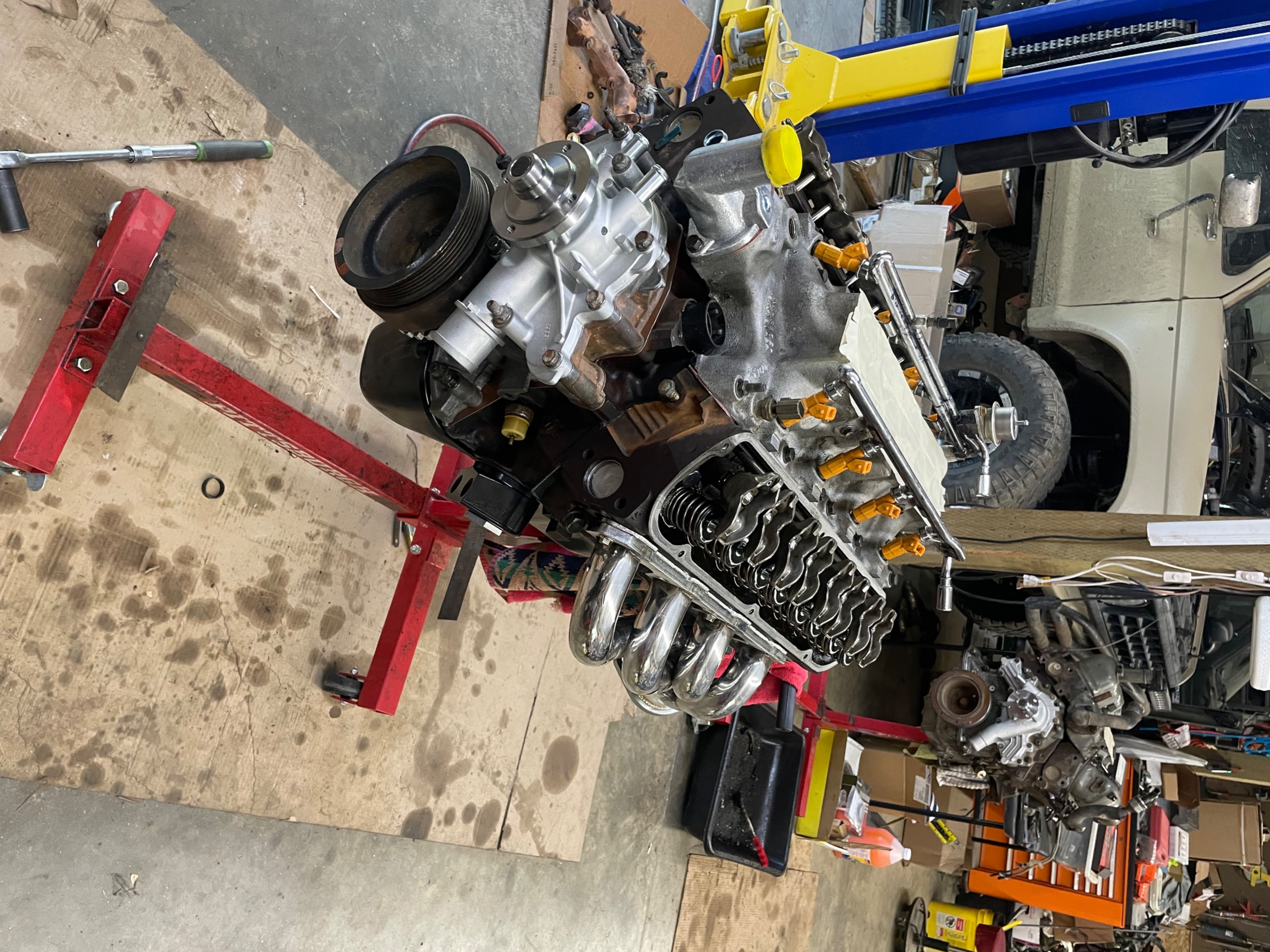

Time for new springs, spring cups and retainers

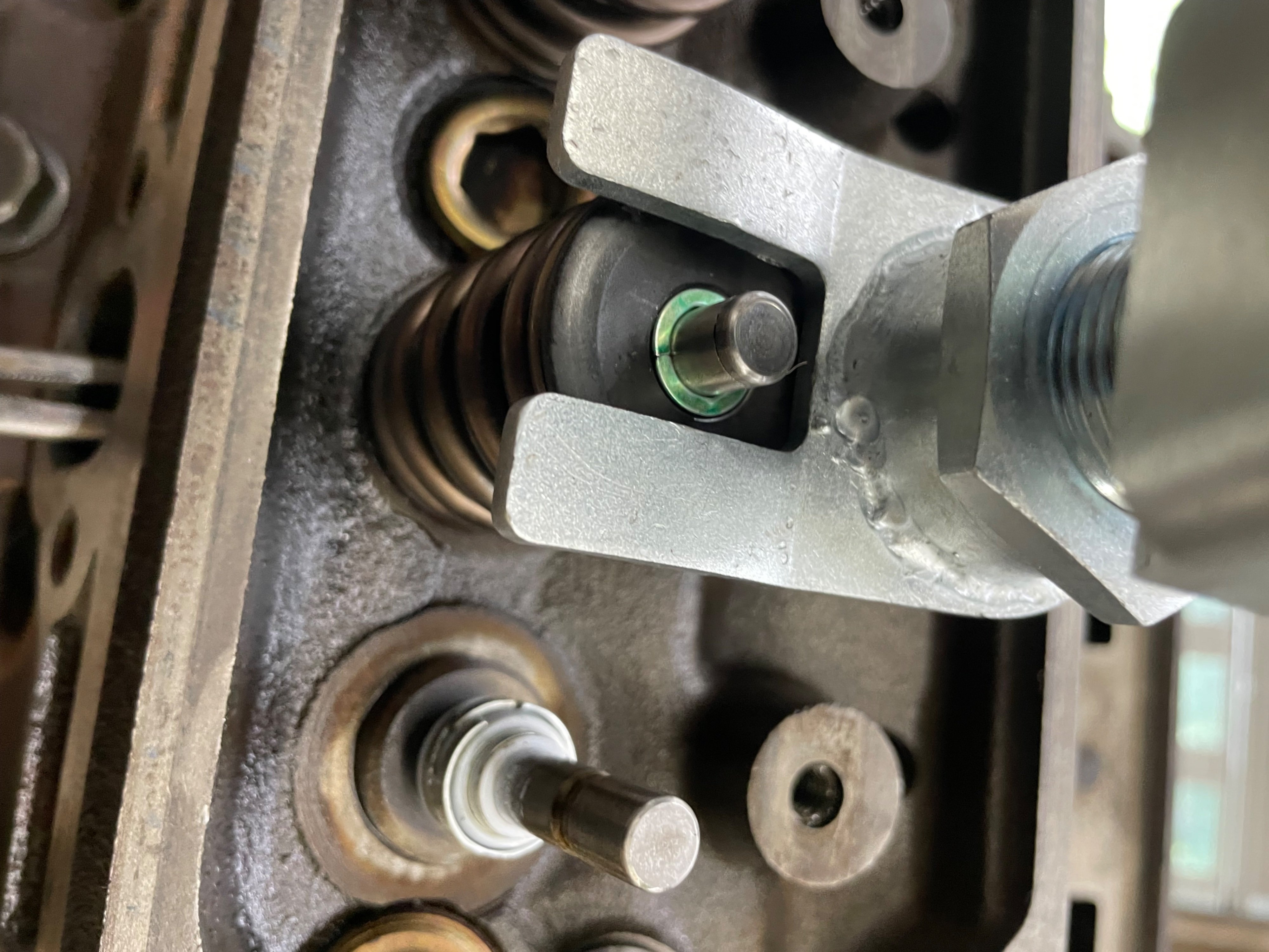

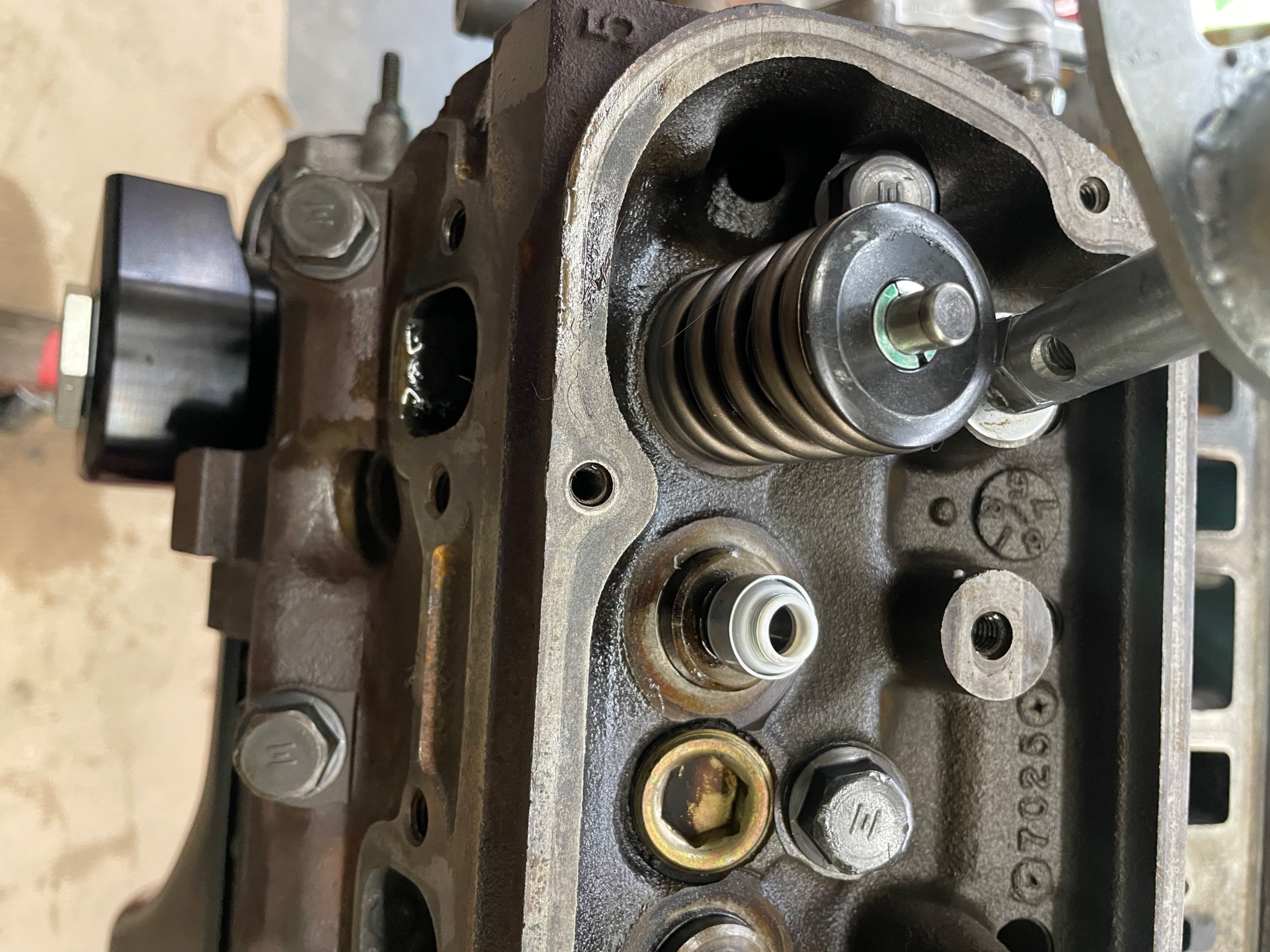

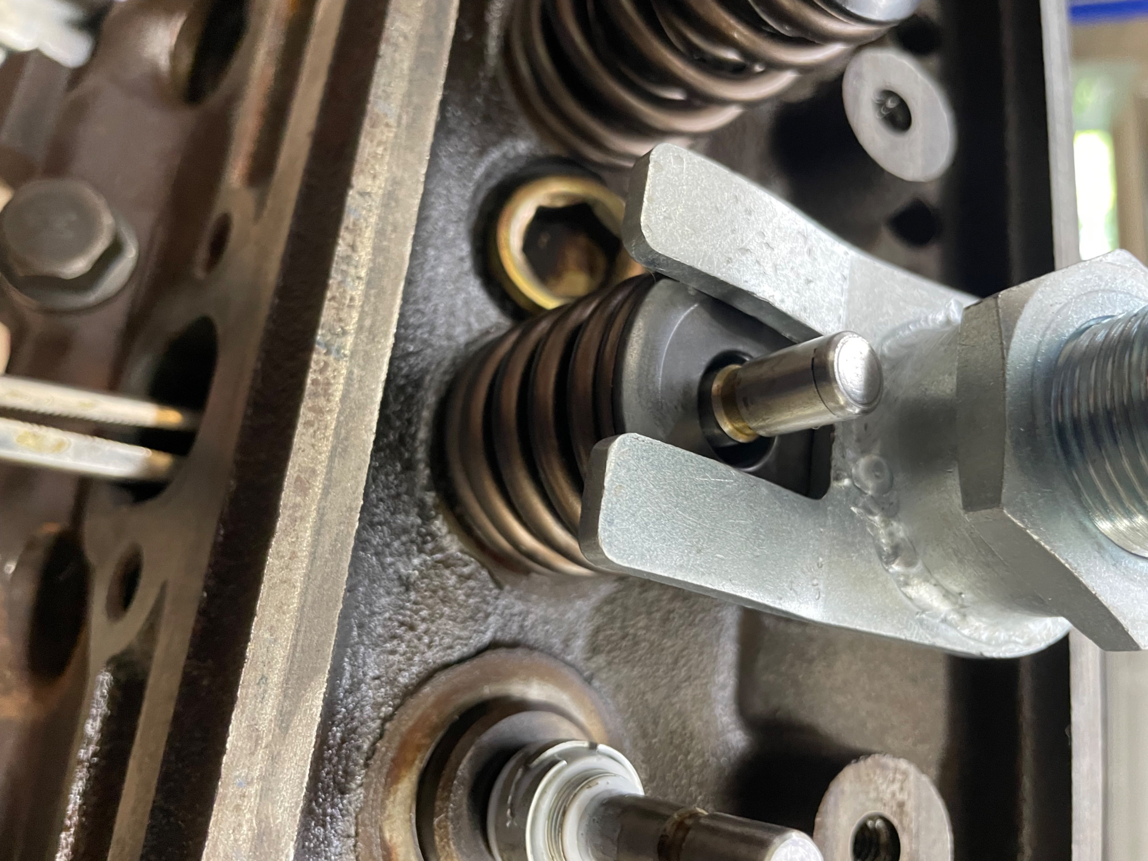

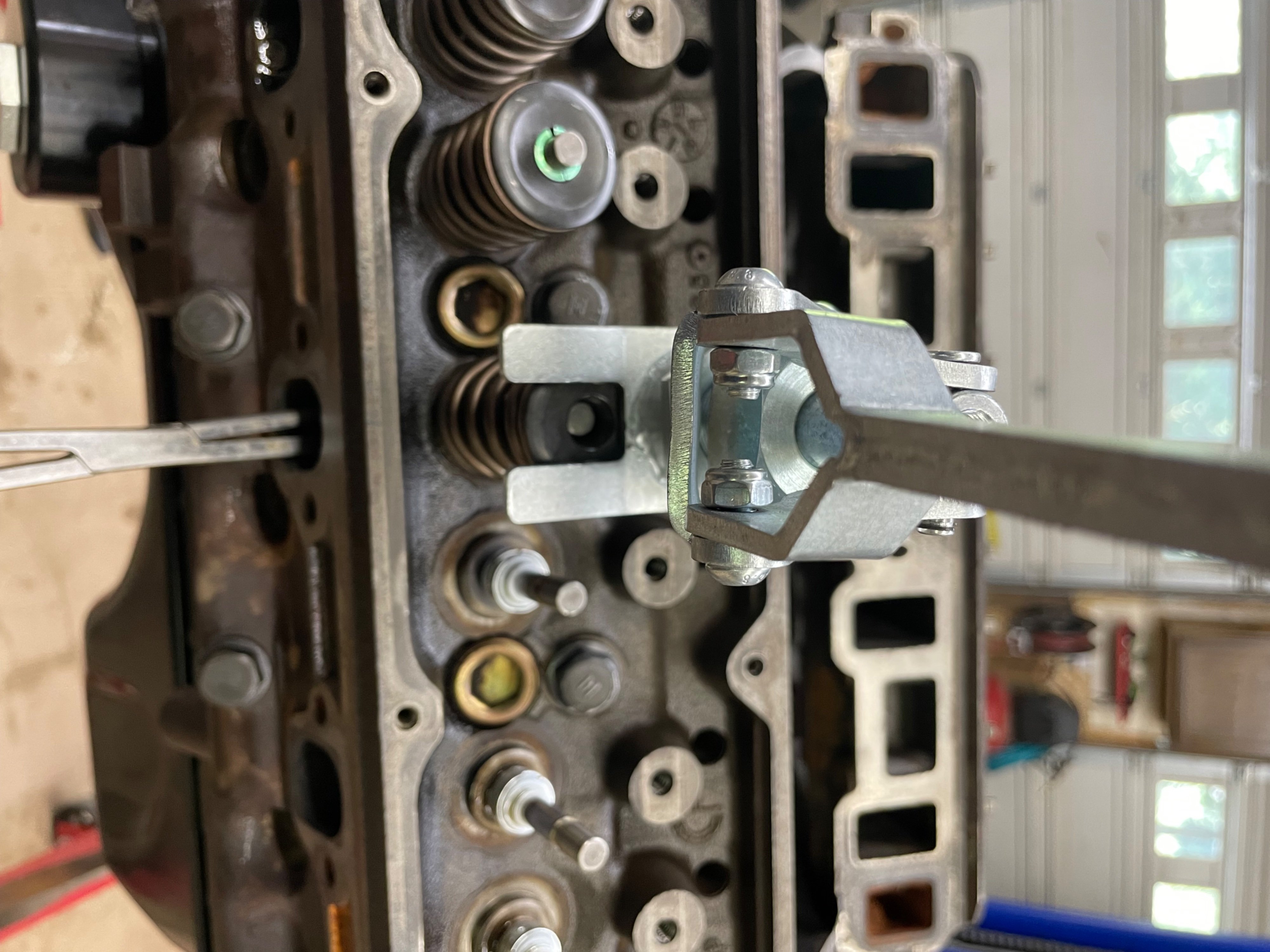

I have been asked “how do you install springs with the heads on?” Well Scott… carefully my friend!
With the spring compressor setup perfectly (had to do some bending of the tangs to get the angle just right) the spring and cup will actually collapse around the valve stem… so the valve just floats. All that is required iSight pressure from a screwdriver through the spark plug hole to keep the stem up tall enough so the retainers can be placed with a small magnet
Once I got a set of those hose-grip pliers, I never looked back. I use them for all kinds of things!
Comp cam springs cups and retainers
I cheated, I have large forcepts
As long as the spring is compressed around d the valve stem it has no desire to move
The screwdriver ensures it does not
My lap during all of this.
This is a one man show camera pics included.
In the future I will work on a way to add compressed air to the combustion chamber. That would hold the valves closed better then my screwdriver method lol

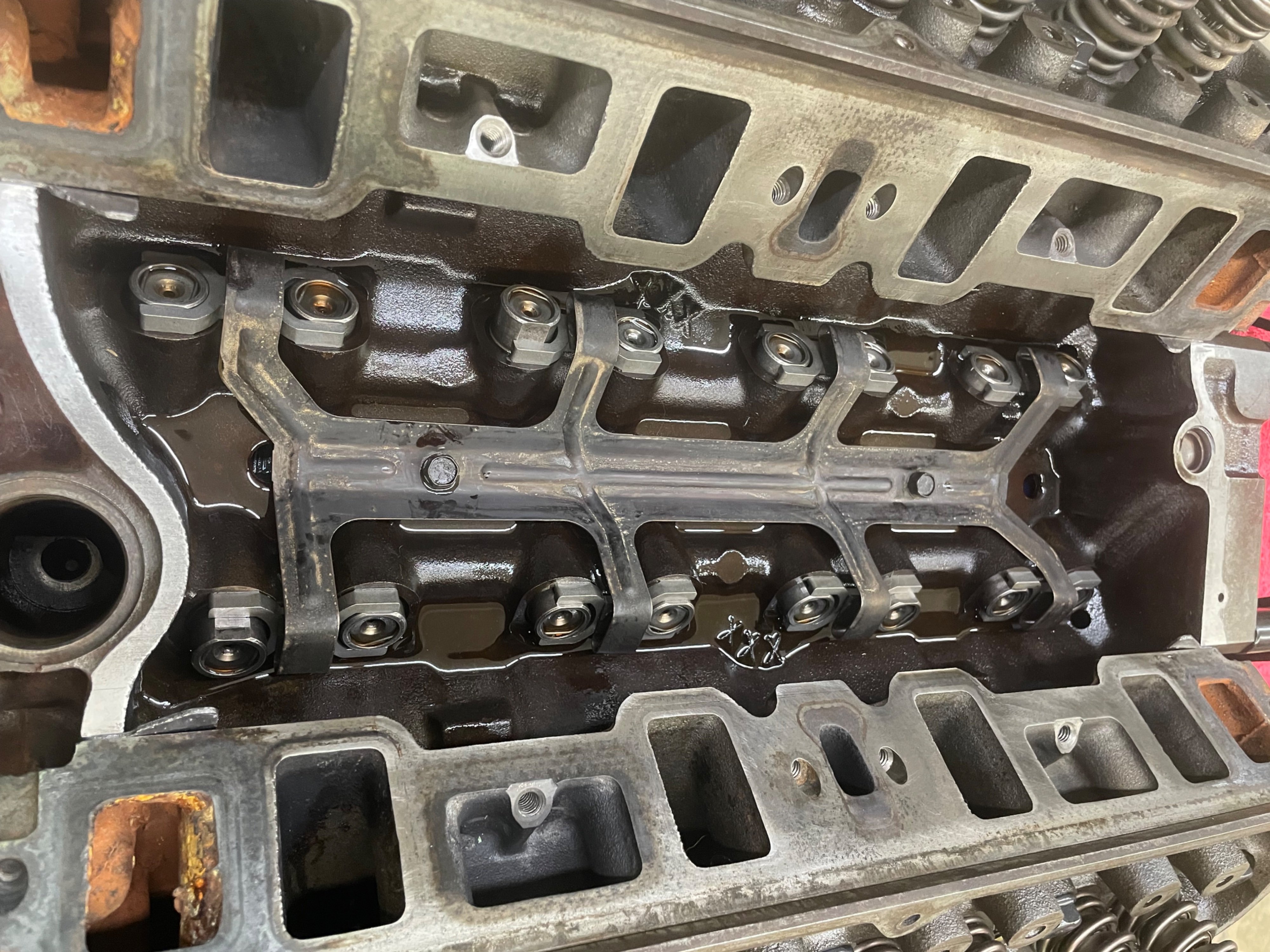

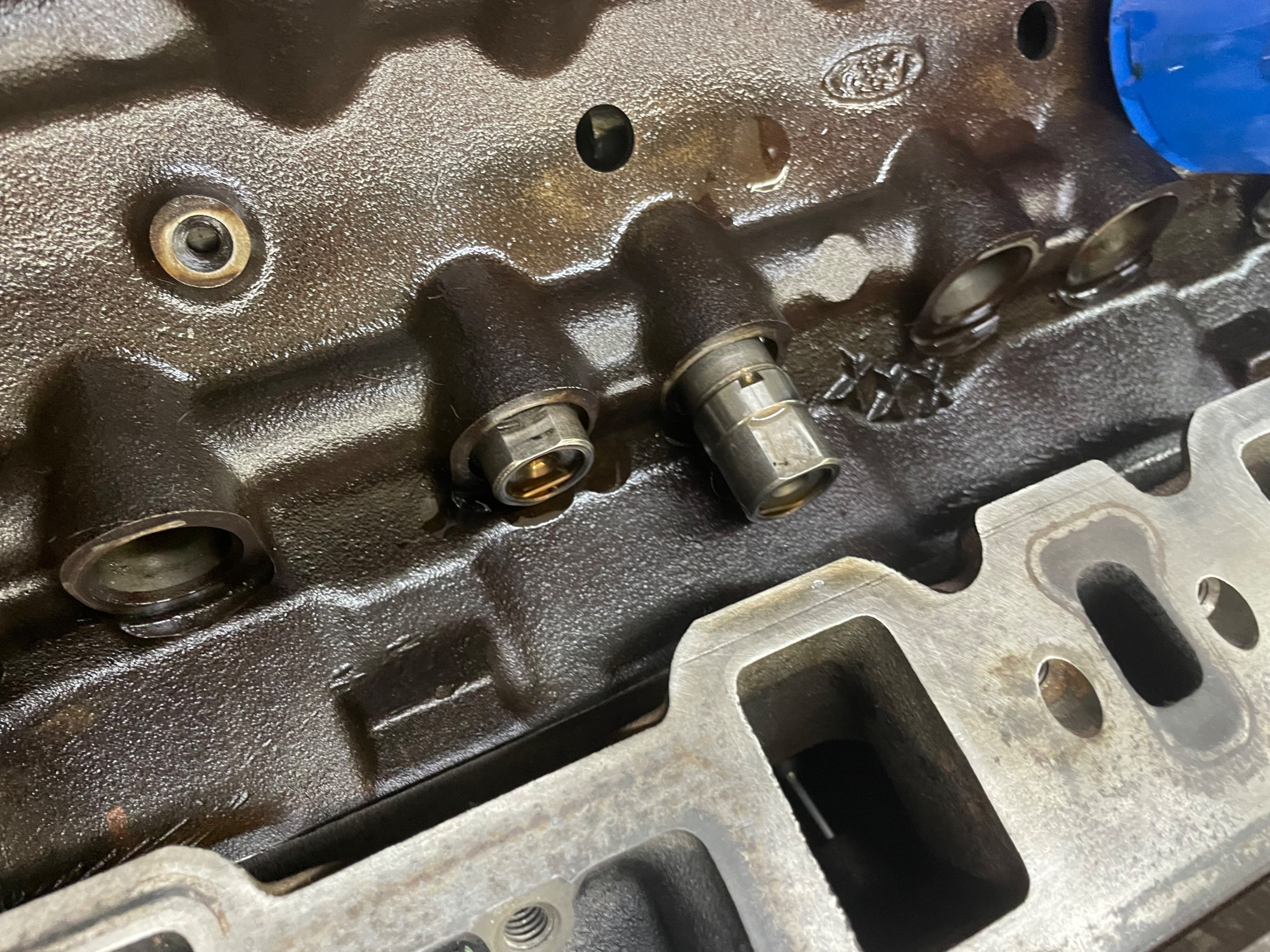

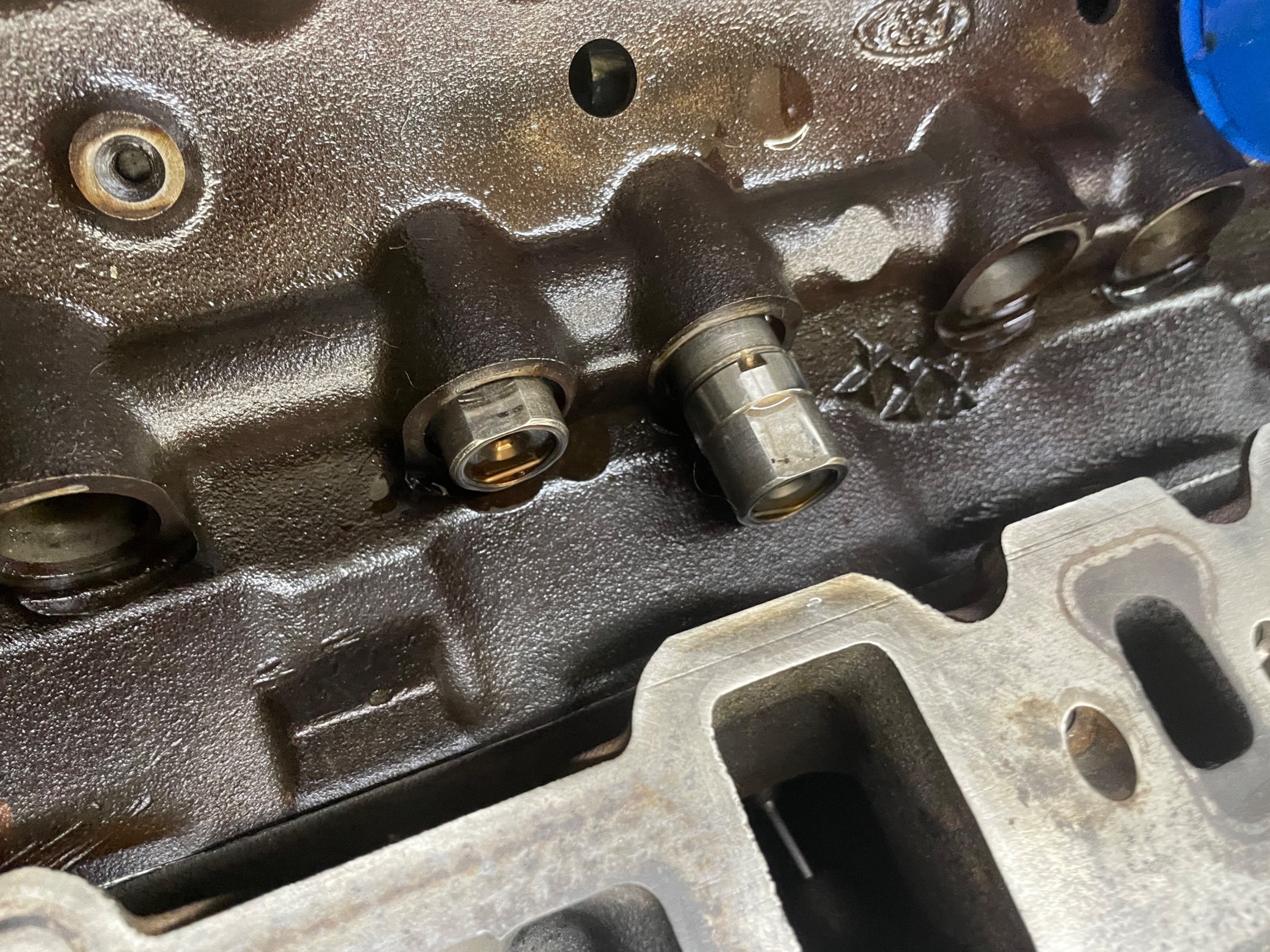

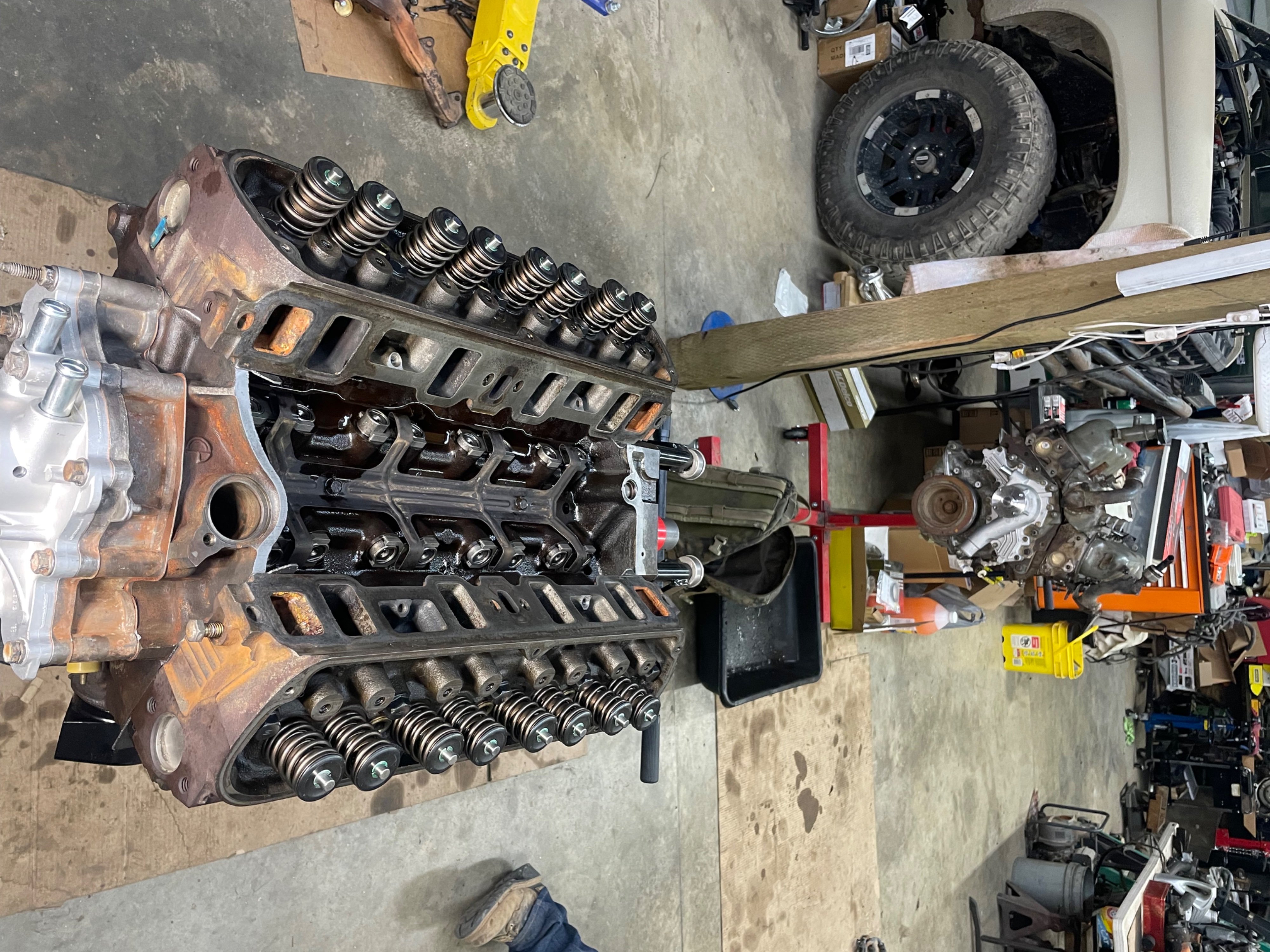

Lifter time, finally!
Oem parts reman in house

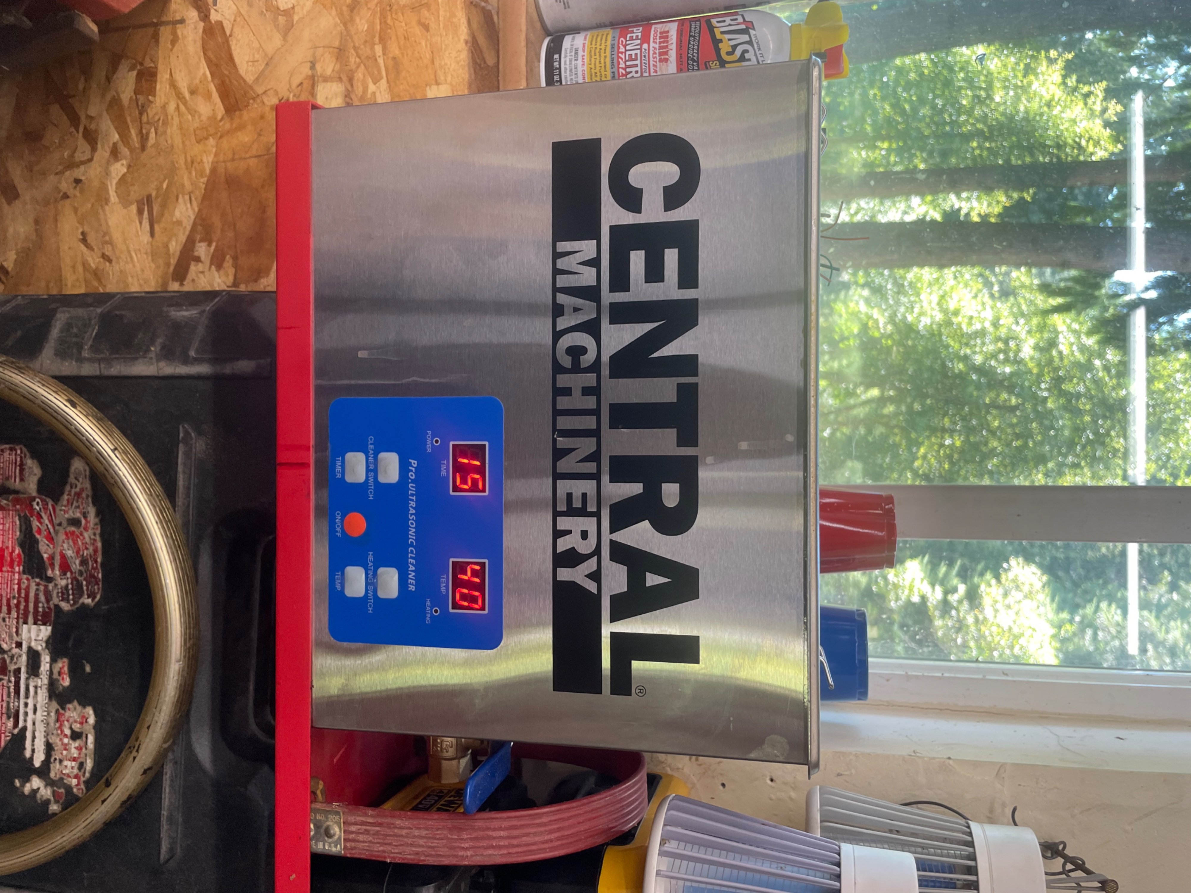

One of the lifter dog bones somehow missed the parts washer
This is a good before and after of how e sonic cleaner helps me out
15 minutes later it was as clean as the others

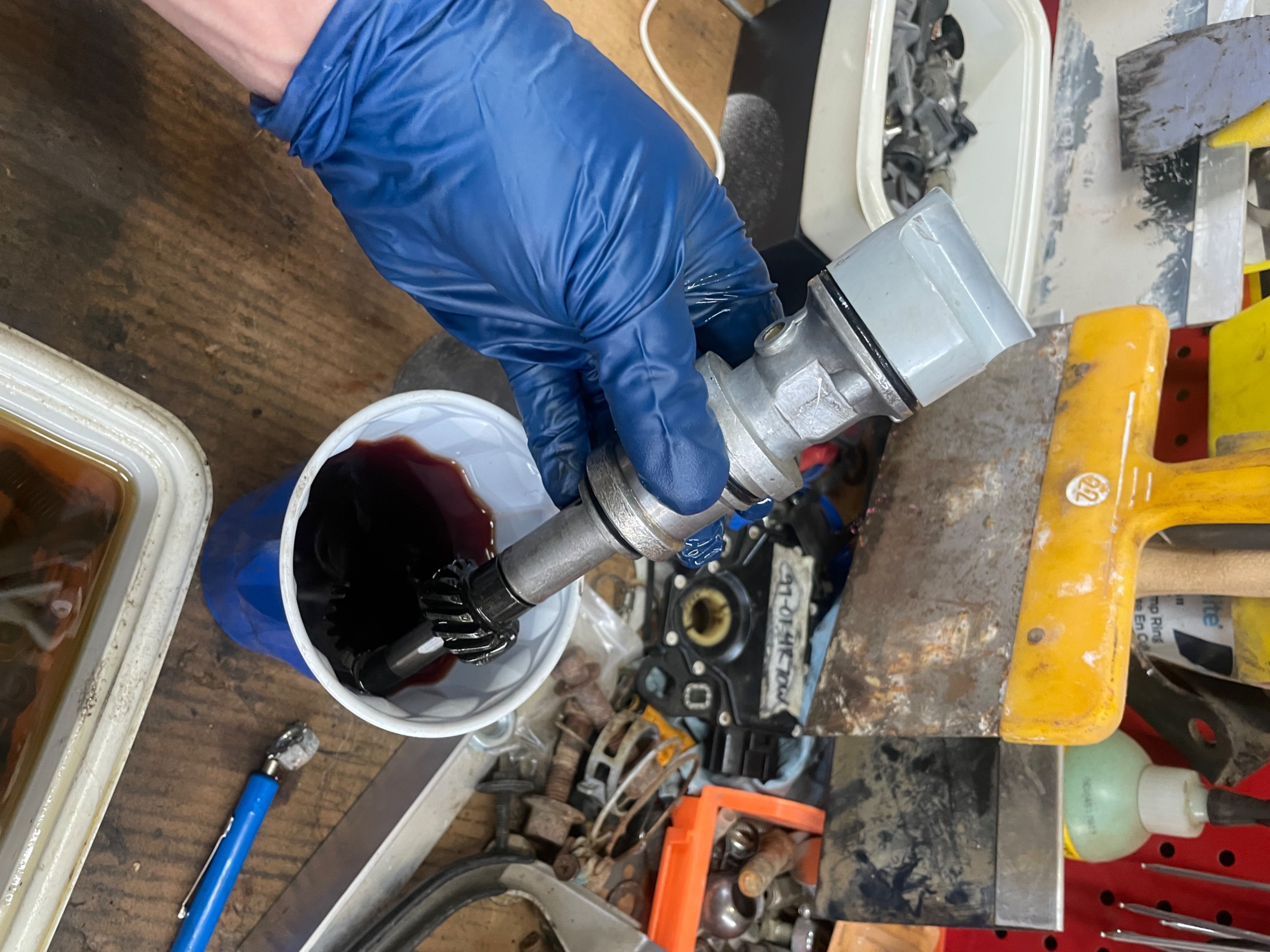

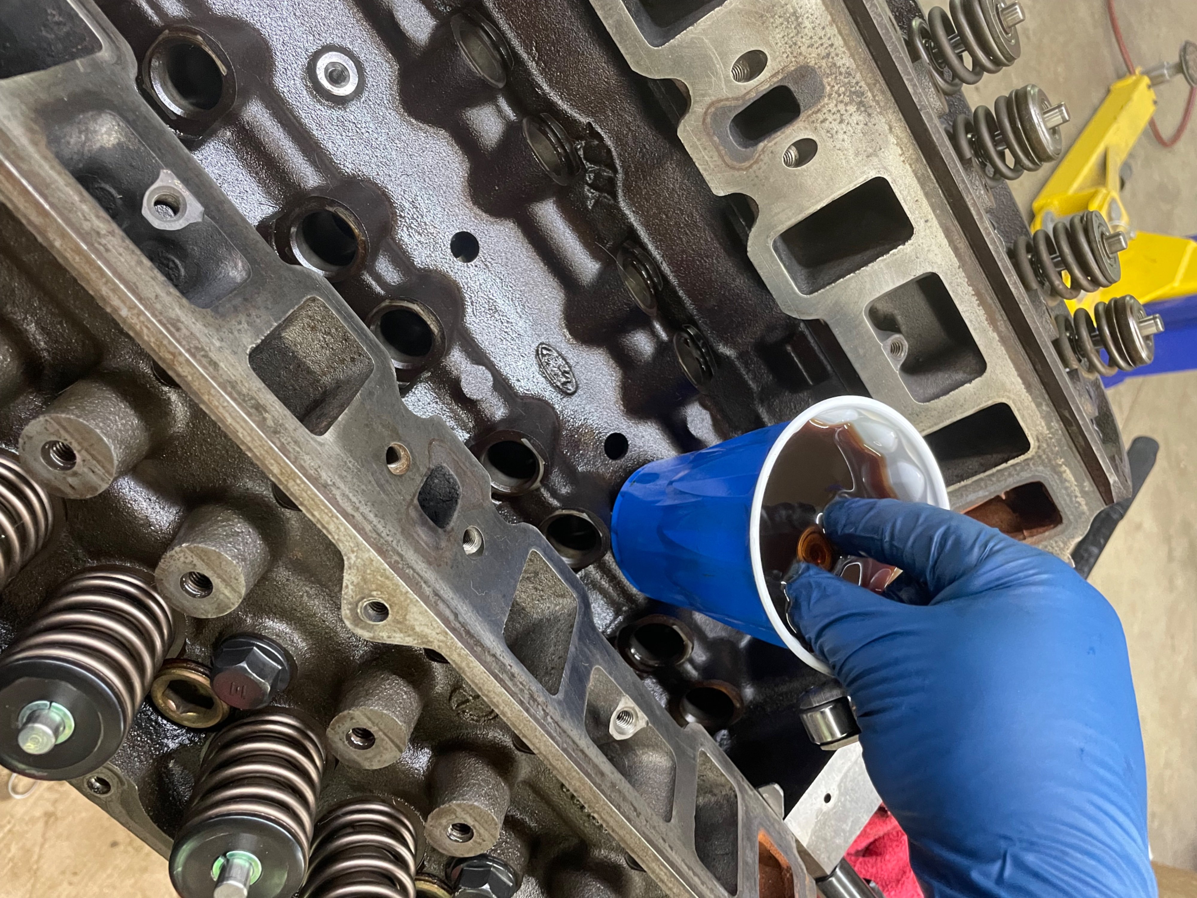

Next up
Basket washed w carb cleaner right out of the sonic box. I’m using water and purple power so good to be rinsed
Then into a clean oil bath

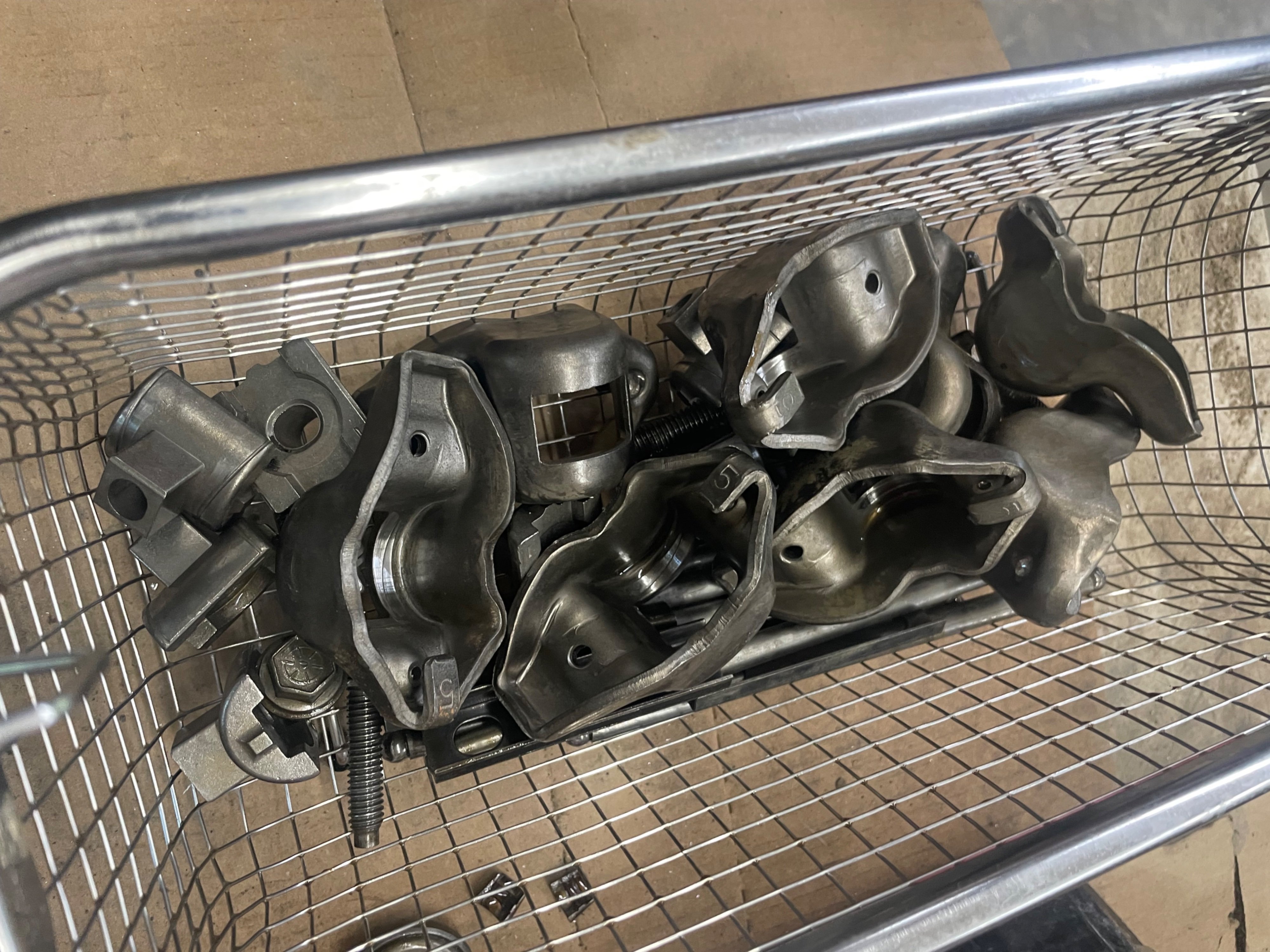

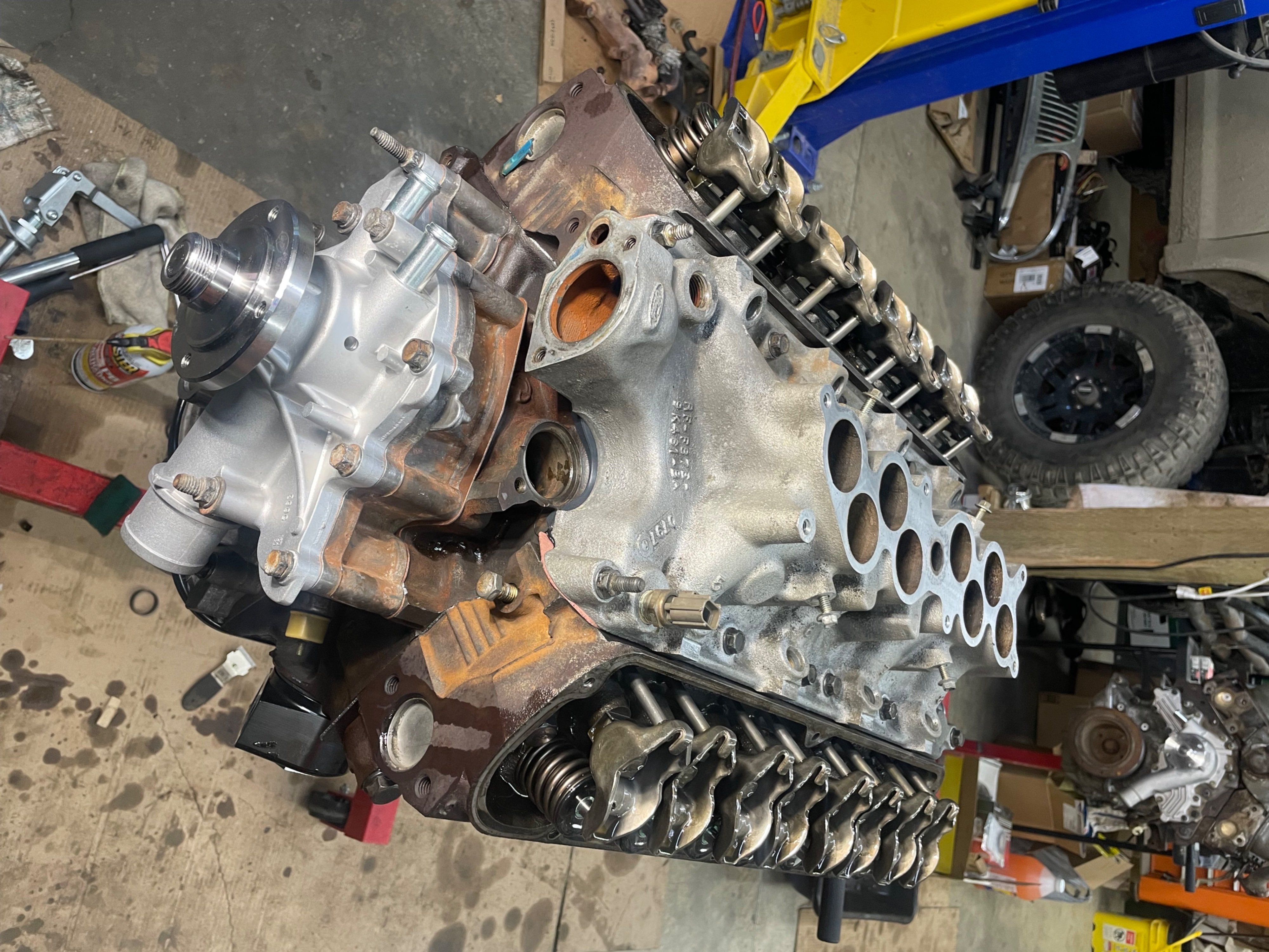

Each part was wiped and blown off w air each pushrod blown out

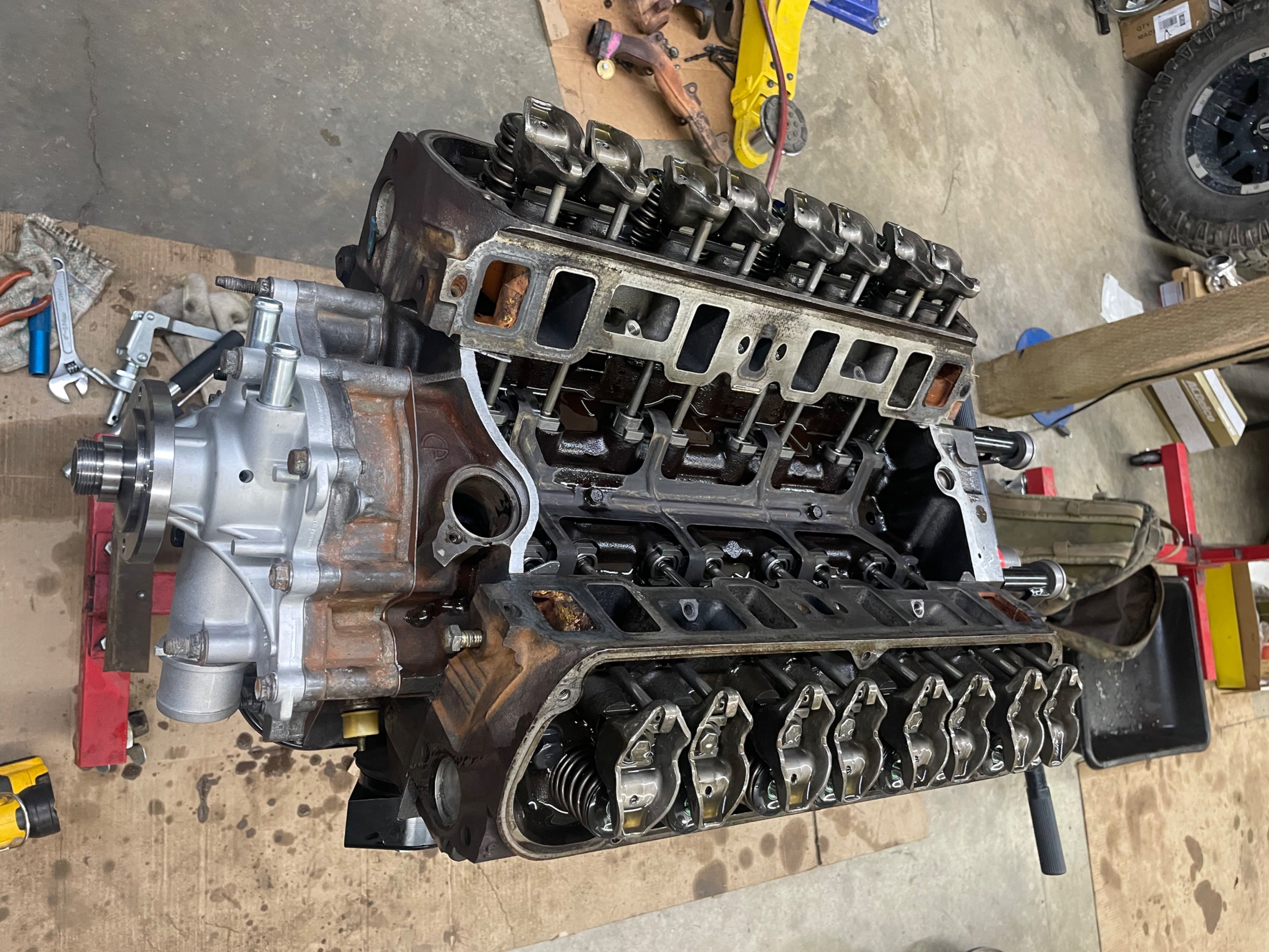

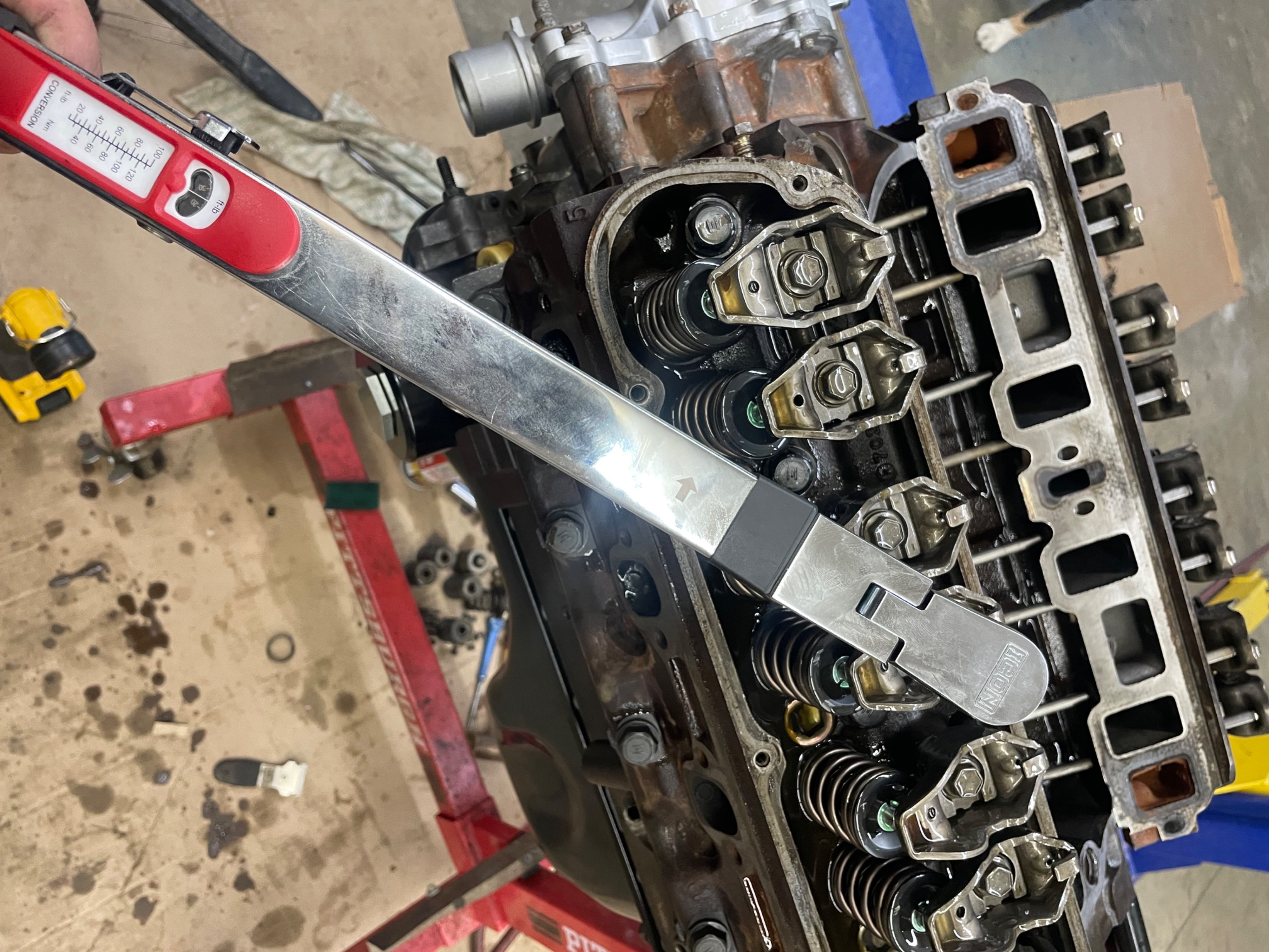

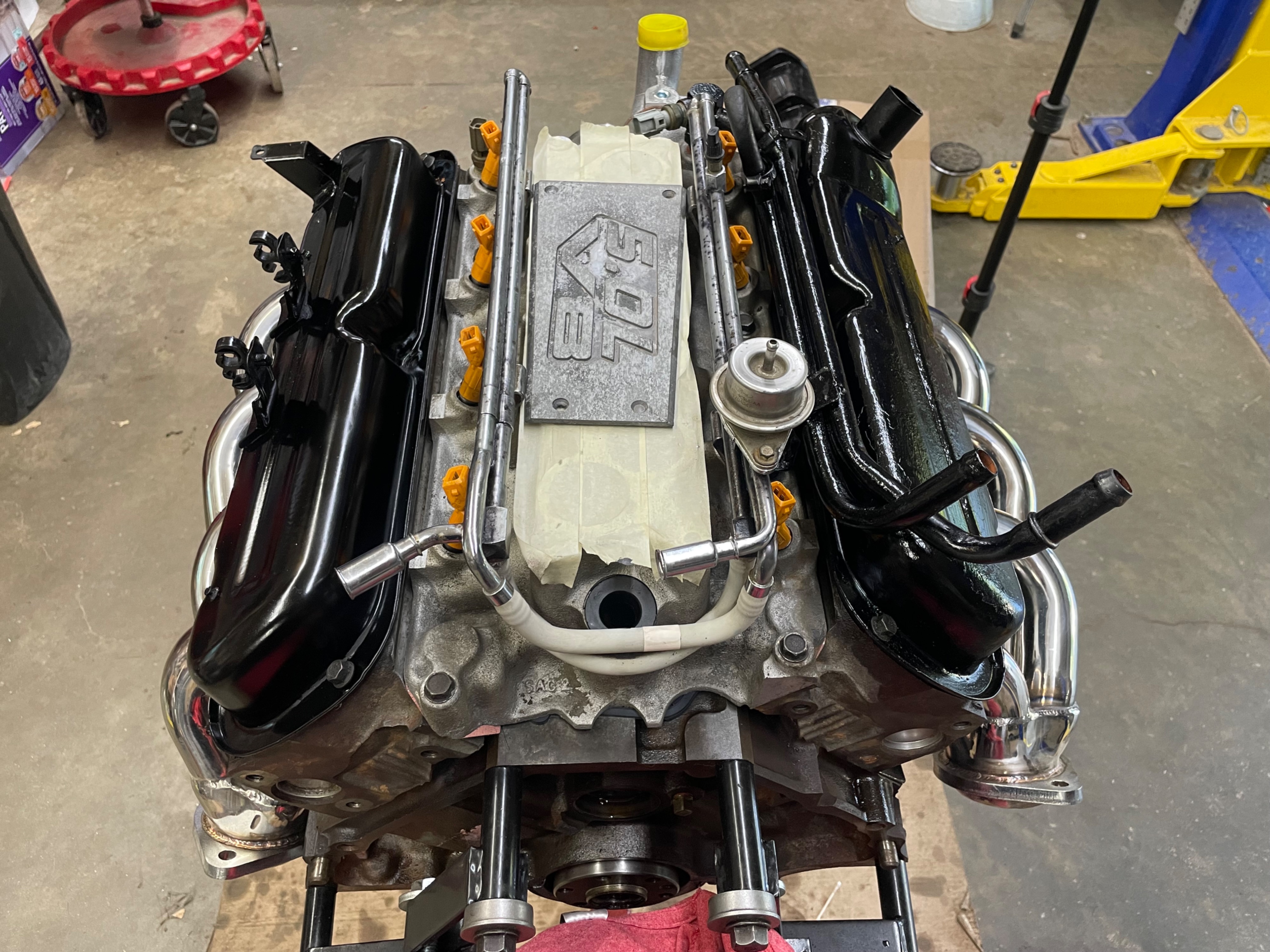

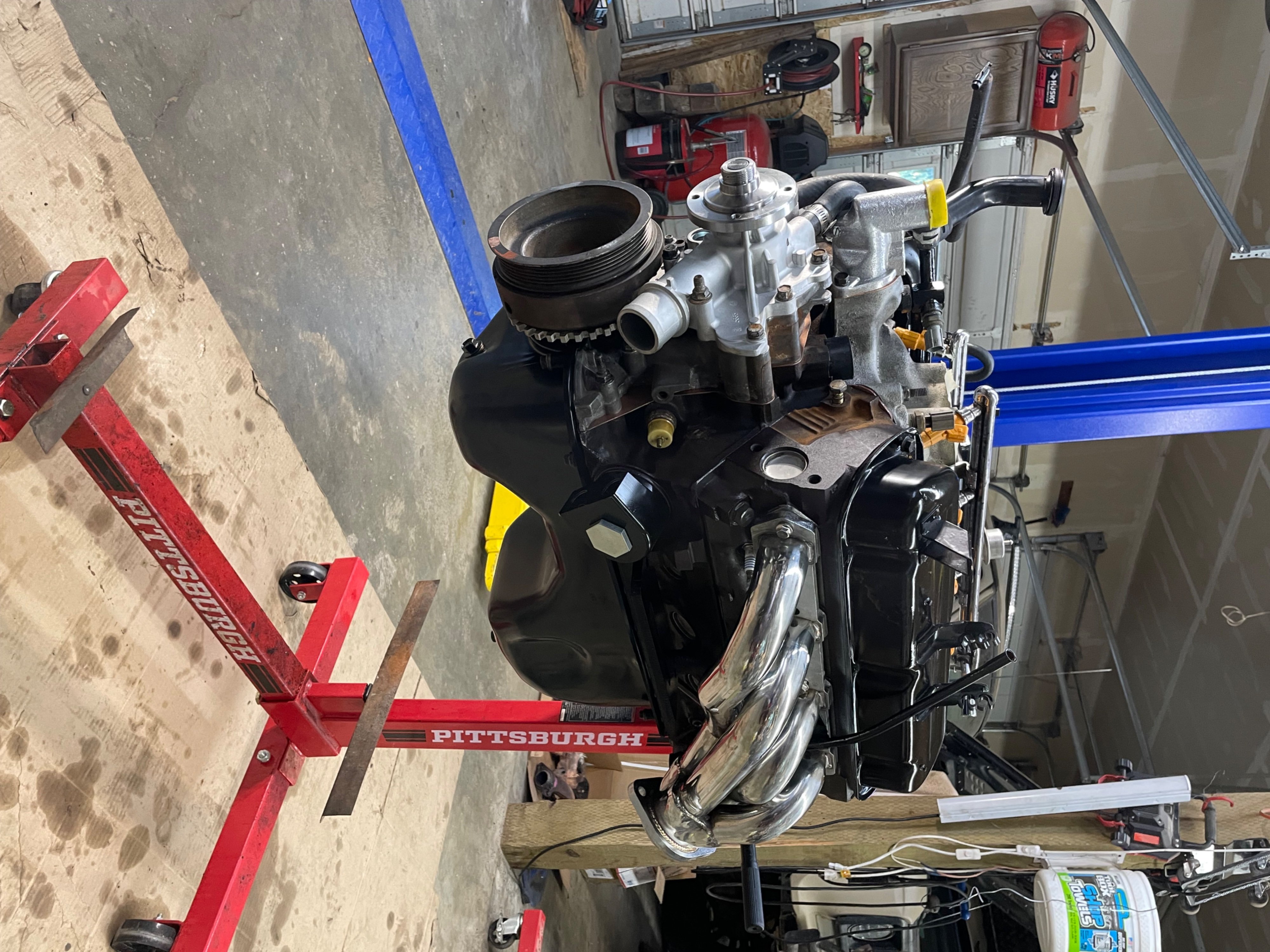

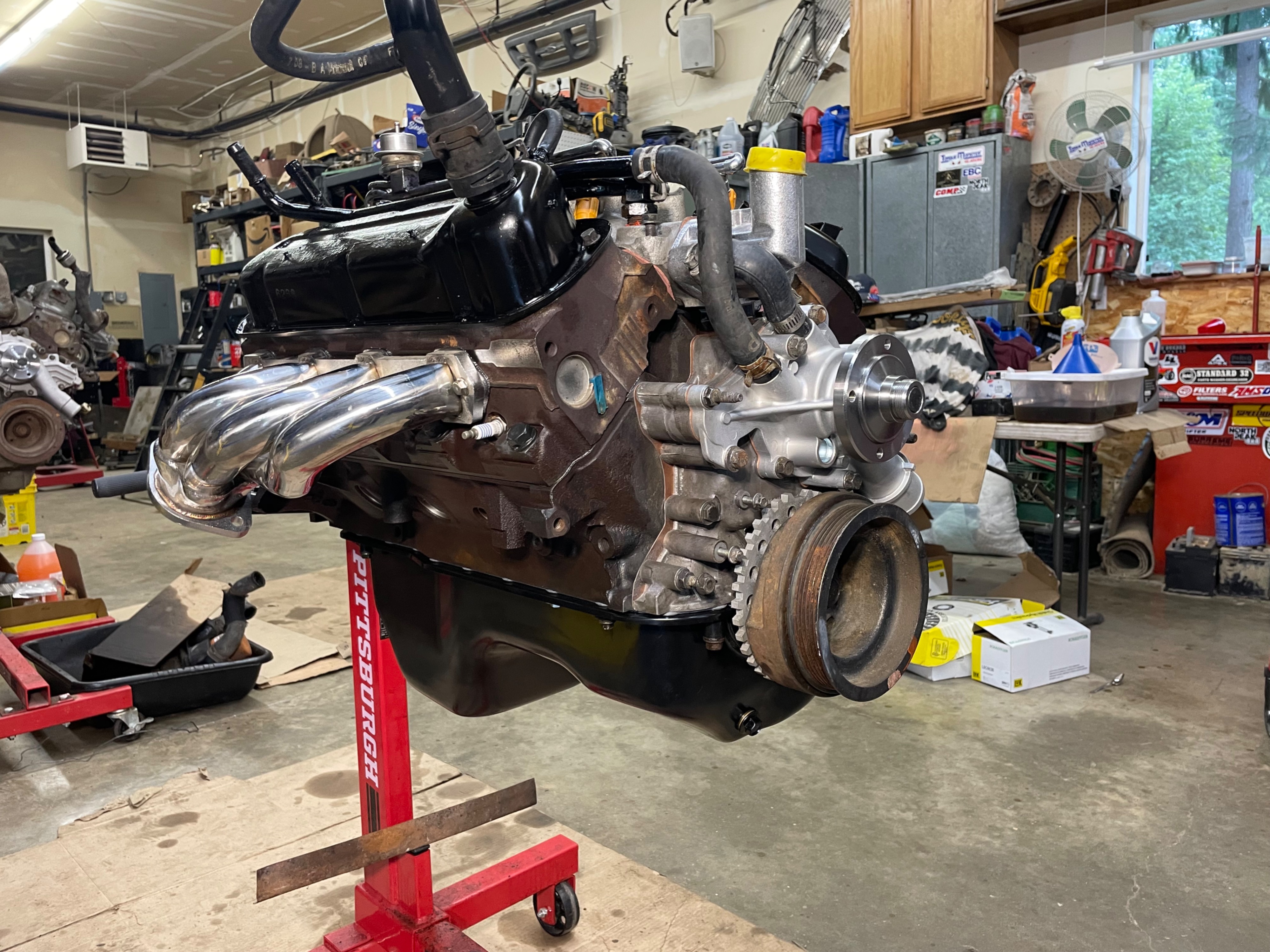

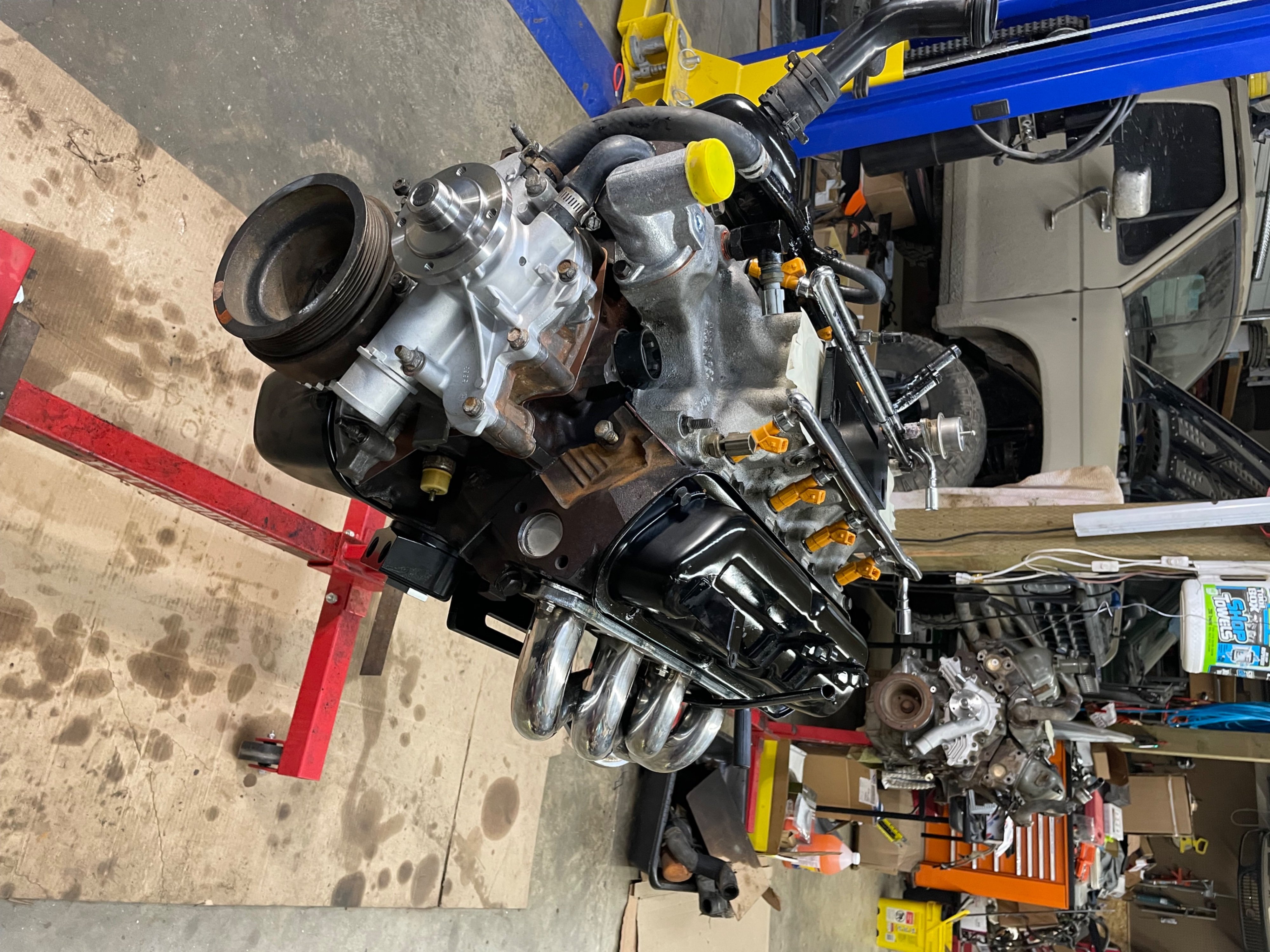

Pushrods rocker arms pedestals trays and bolts all installed
Torqued to 24 ft lbs

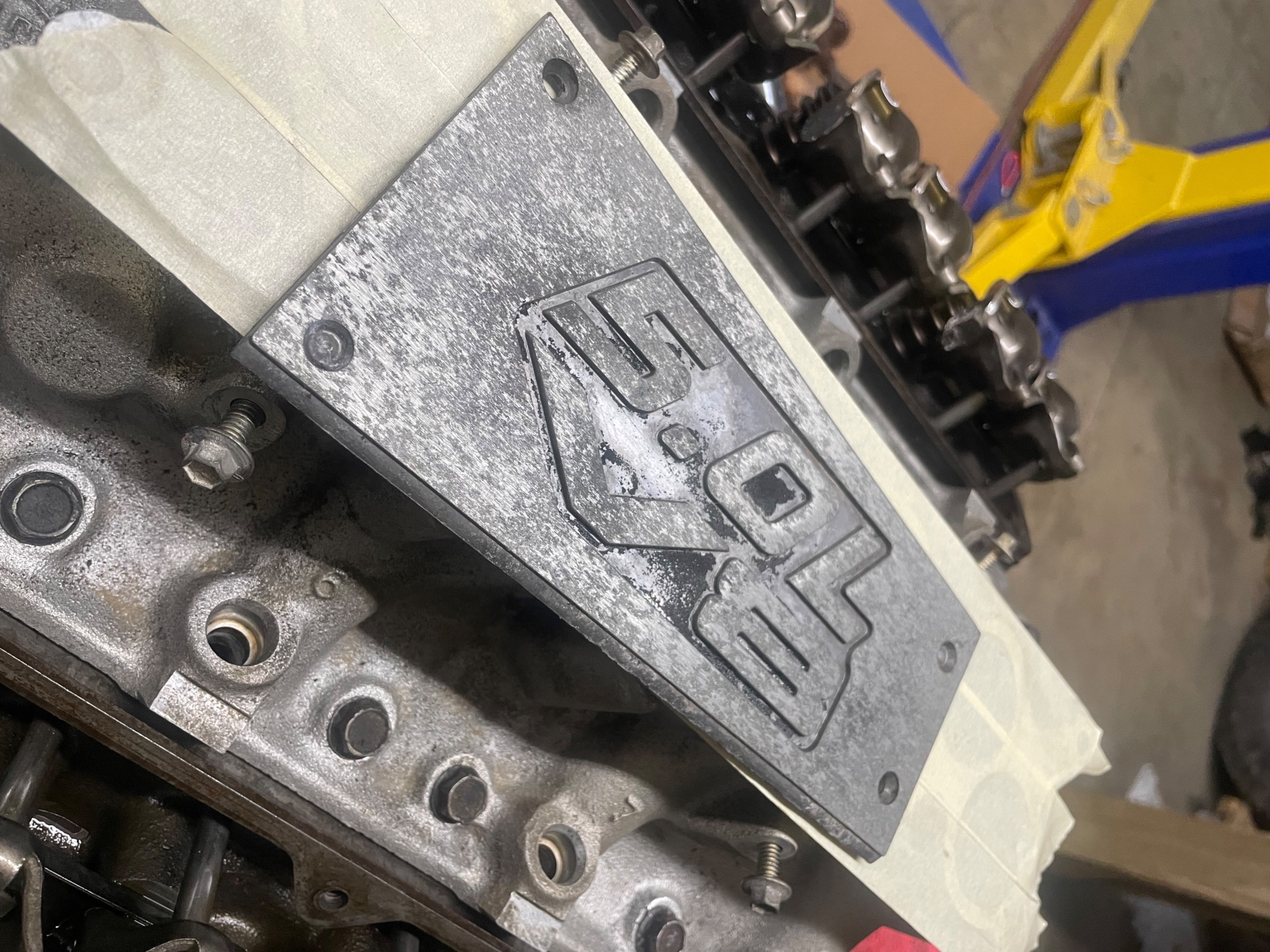

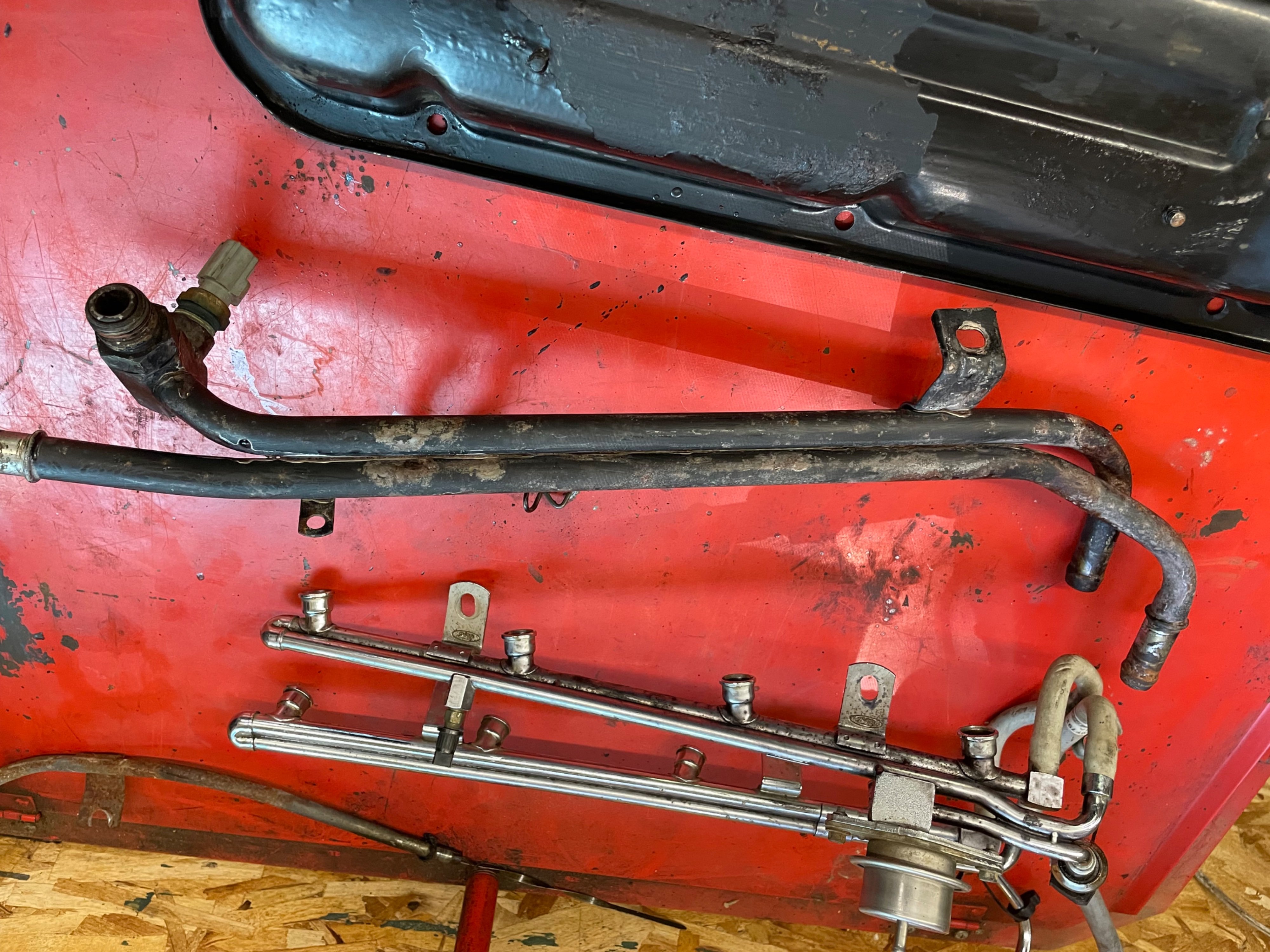

Lower intake gasket surfaces prepped wiped w alcohol
Permatex in the corners under and in top of gaskets
Enginetech gasket set seems to be a good fit!

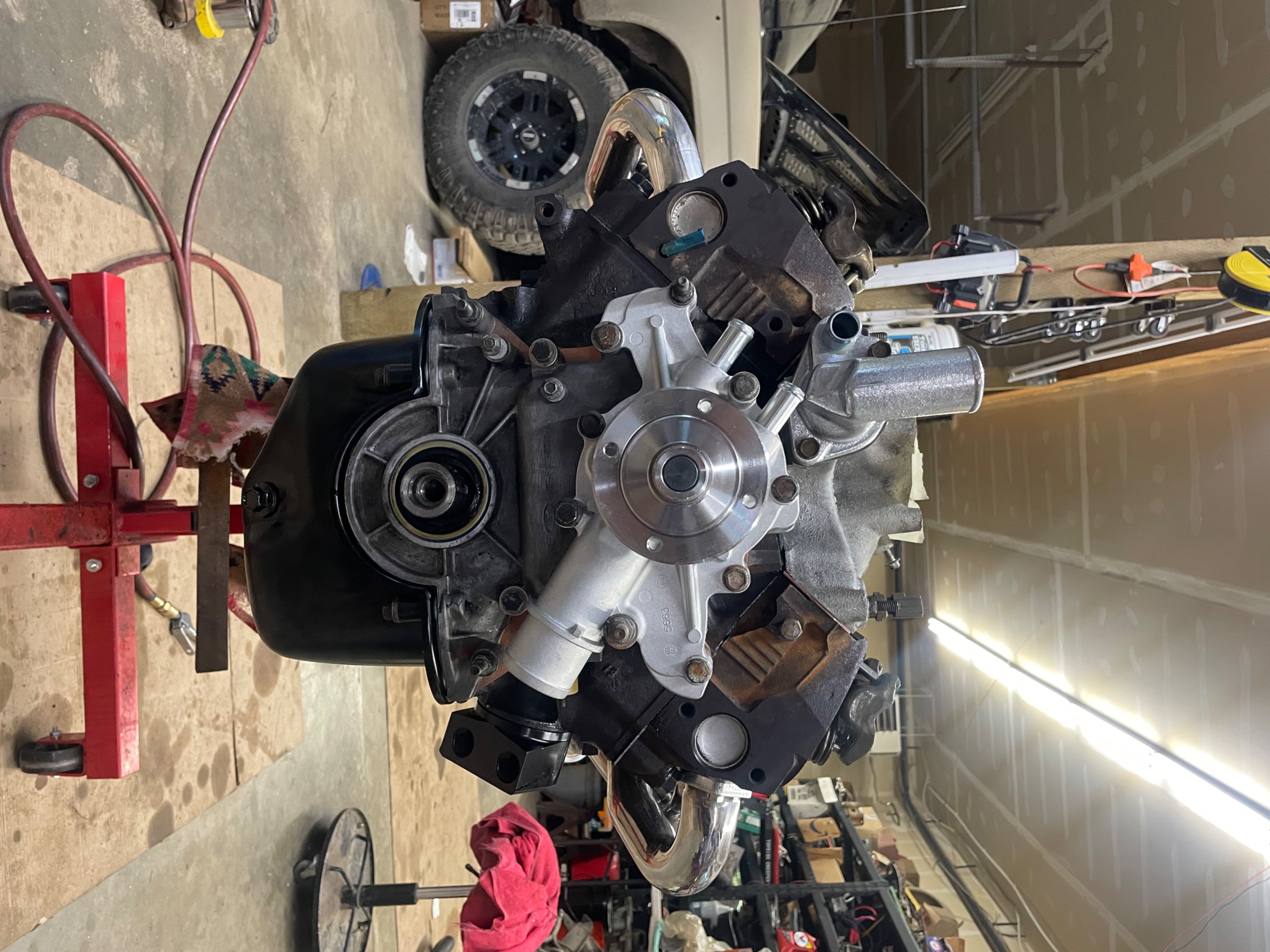

Silicon was given time to setup then the LIM dropped on

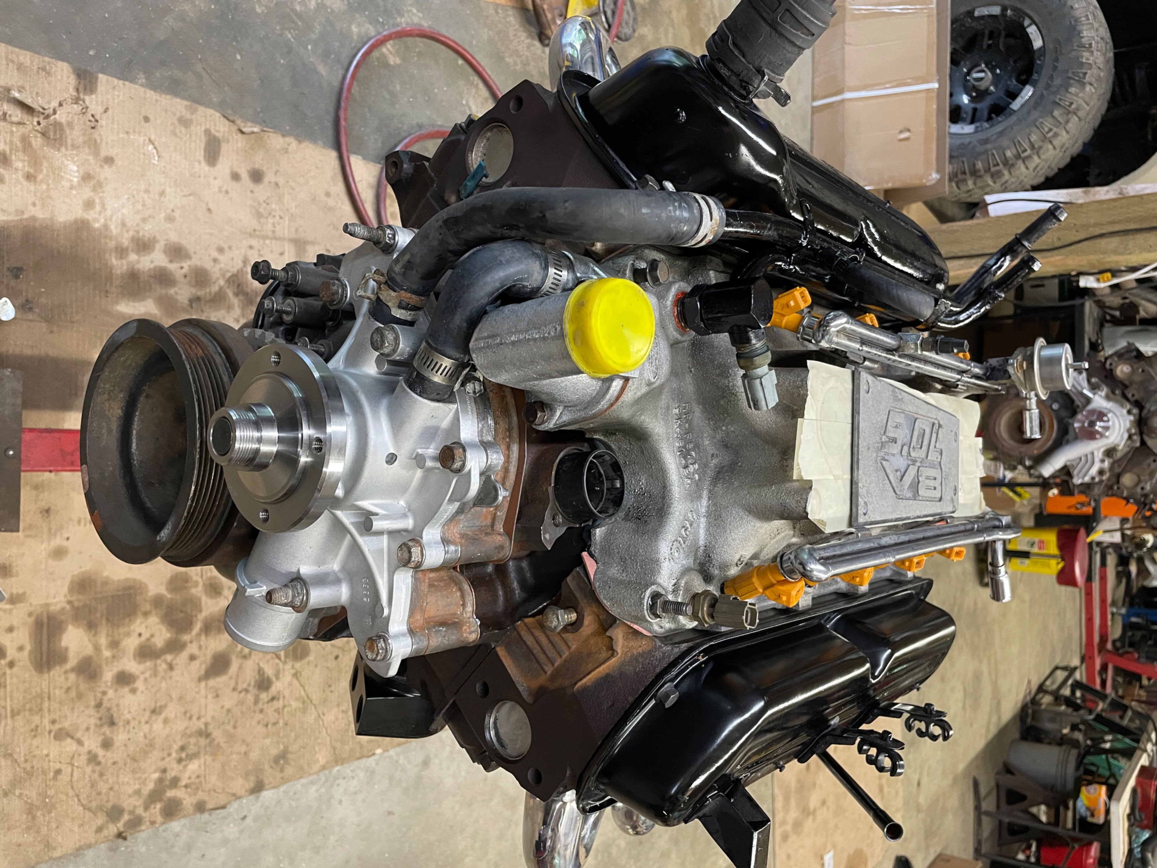

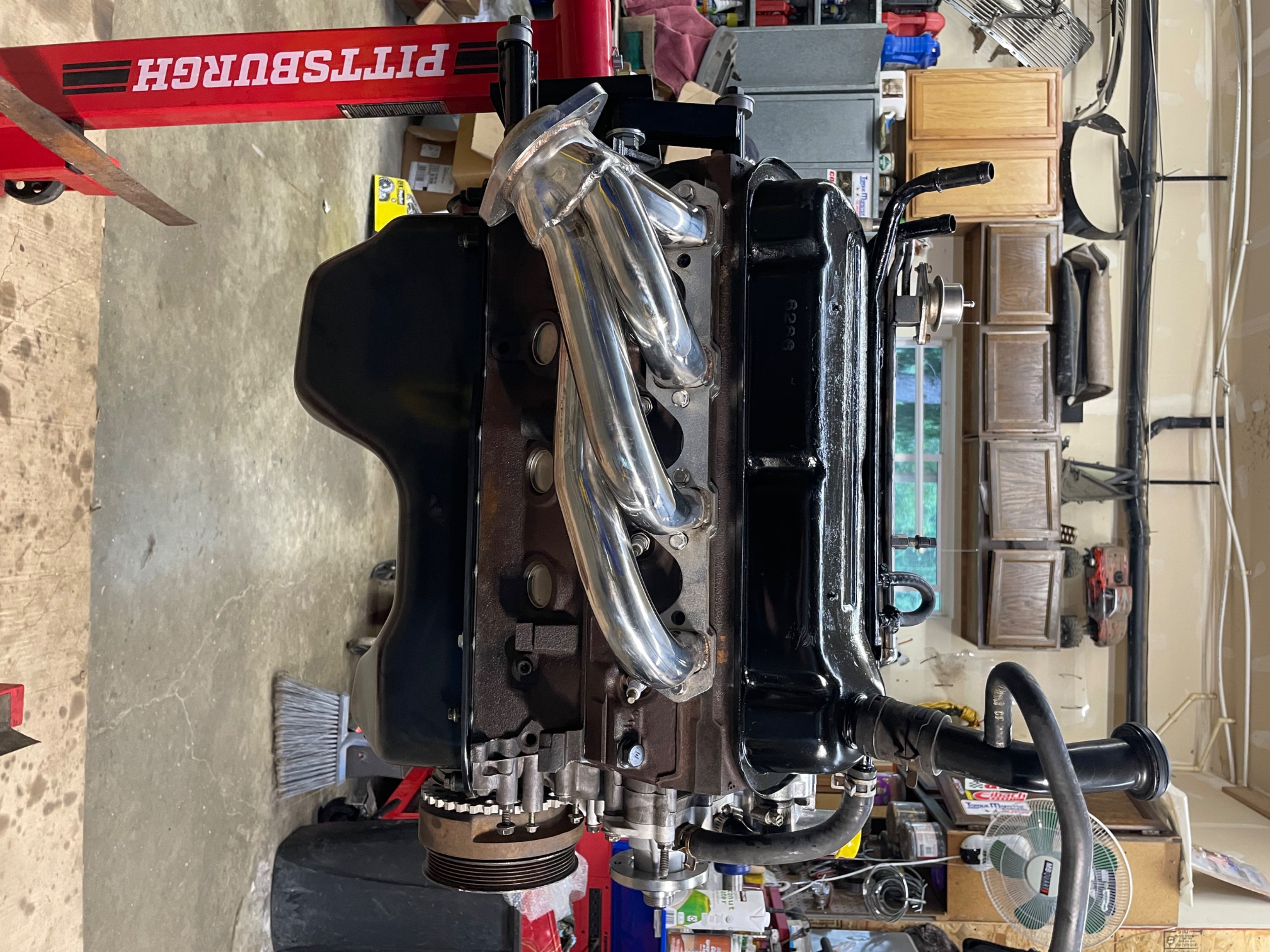

All sealed up! Starting to look like a proper power plant

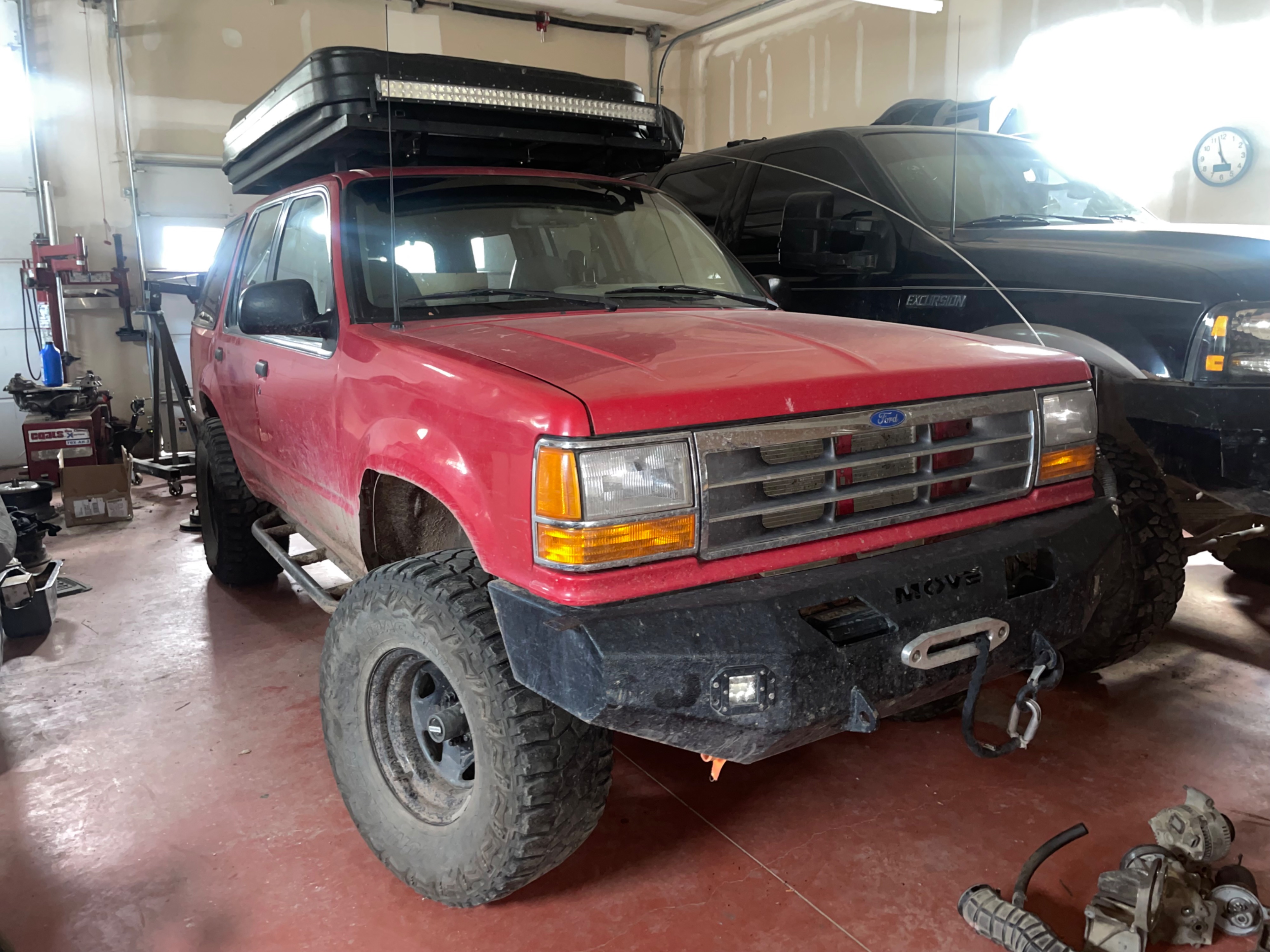

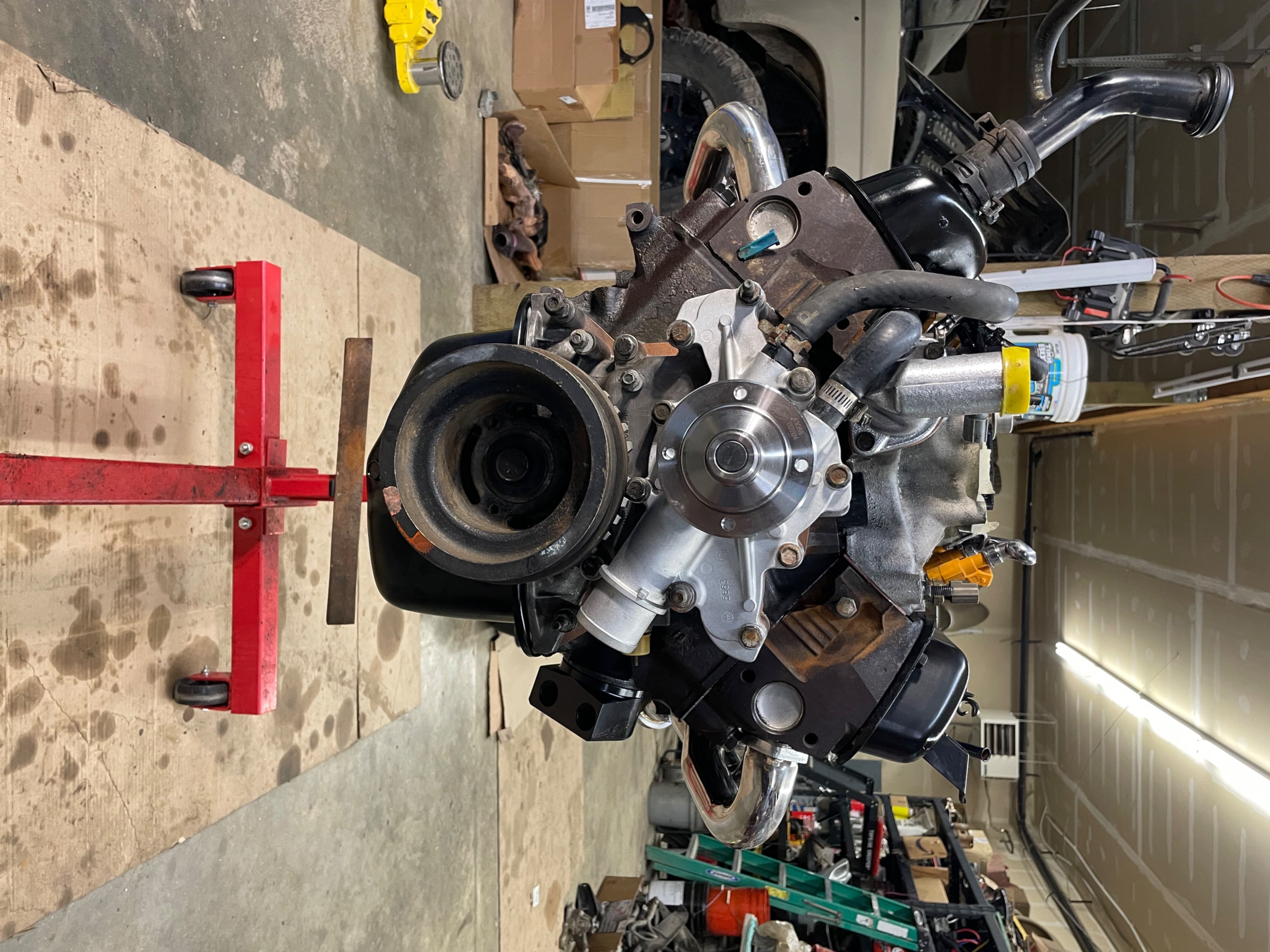

Here she is! My next victim
This sweet, well used, and well setup family rig has come to my shop to get some upgrades
The plan is simple
Delete the ttb and install a high pinion Dana 44 solid axle
V8 power plant with m5od-r2 manual, 4406
Manual transfer case
Rebuild and upgrade the 8.8 rear axle
Dual arb lockers
Lots of new along the way
So join me as I dismantle the existing and build up the new

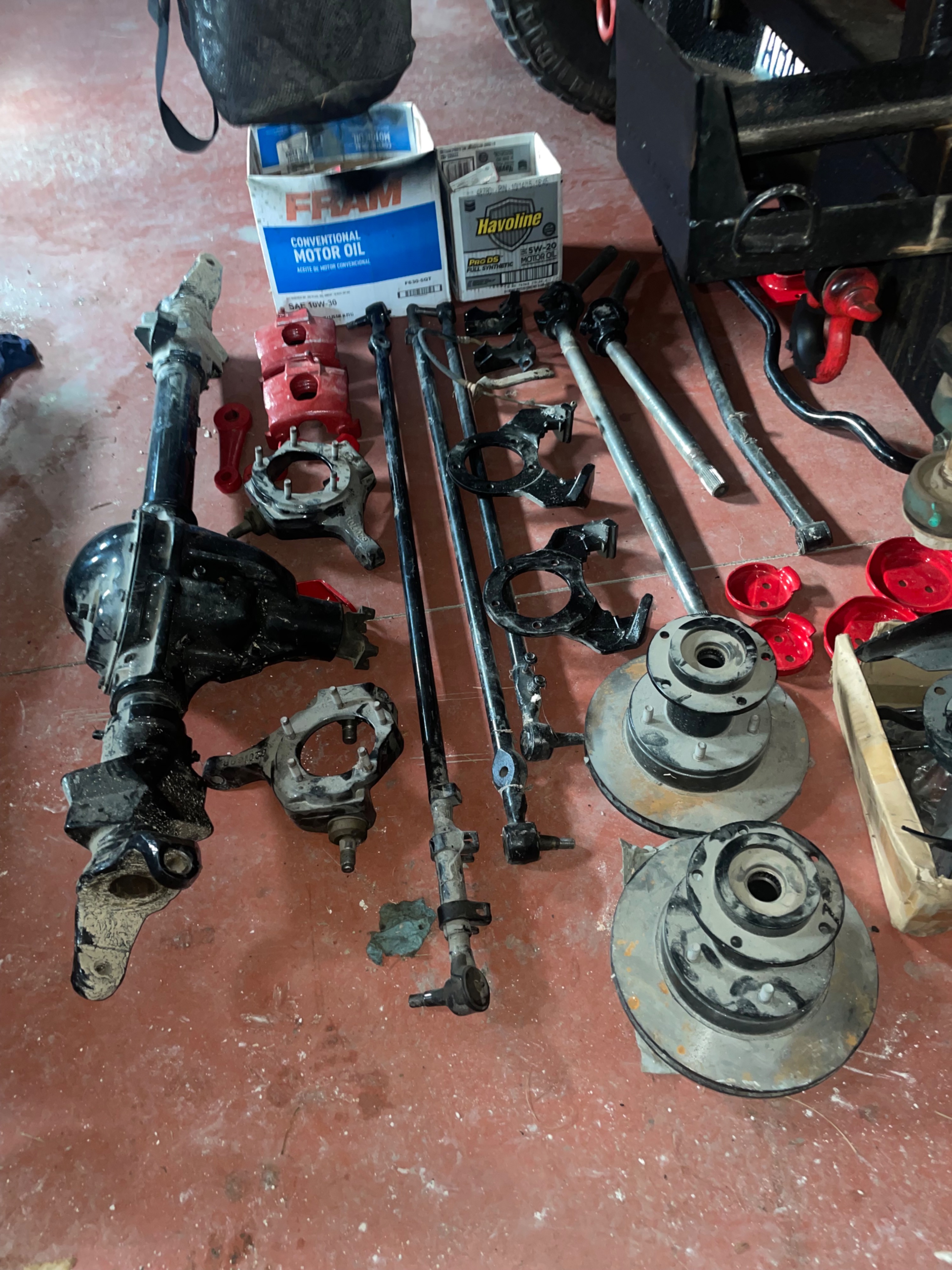

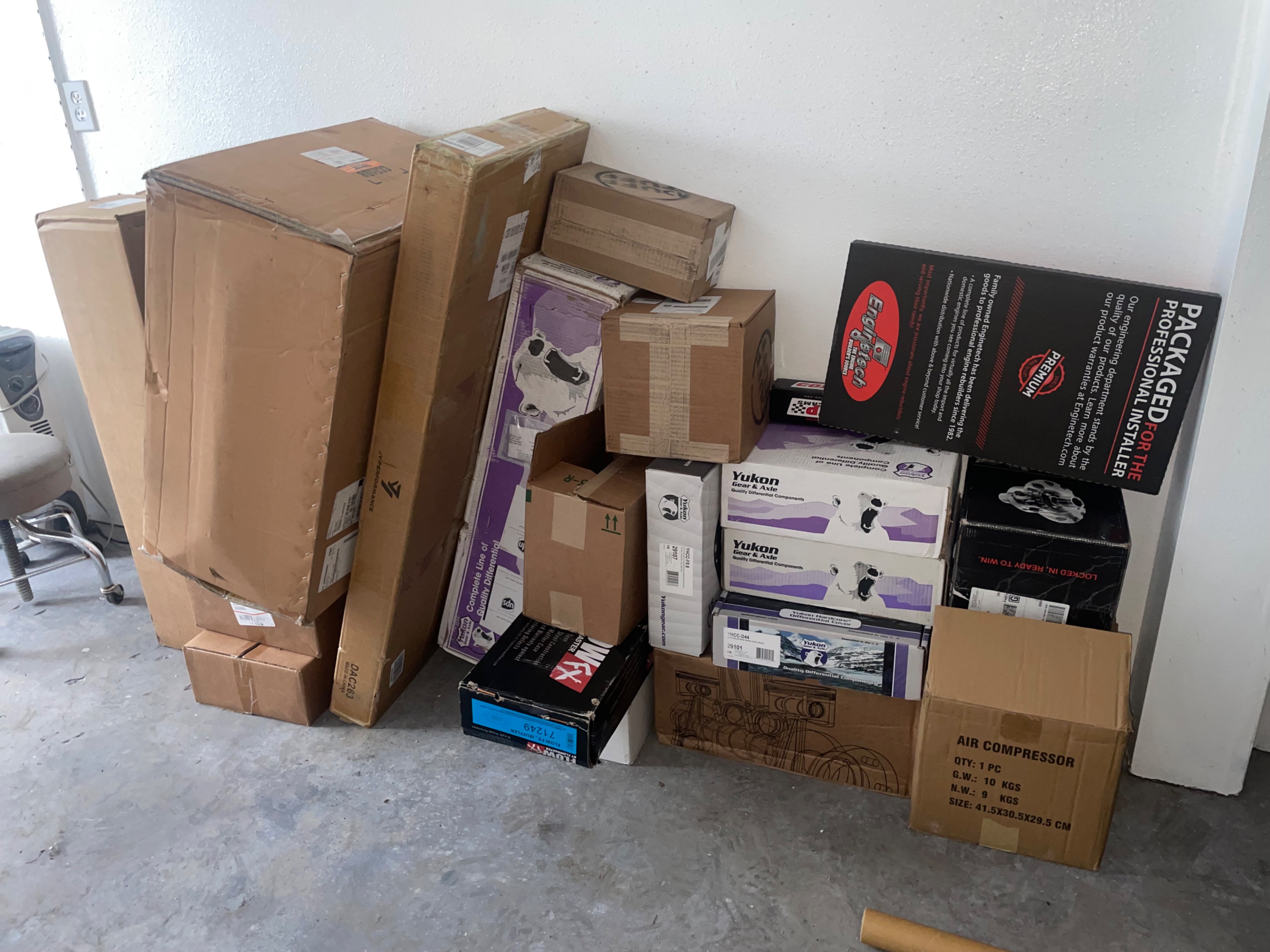

Parts have been coming in for a while
Truck has been in my possession since last October?
Scored a eb d44 from a friend of mine that was slated for another build that never happened
Here we go, tomorrow is day one
Inventory parts, clean and then drain fluids
Start dismantle
