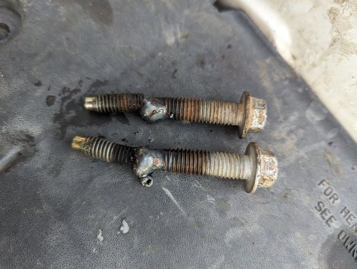

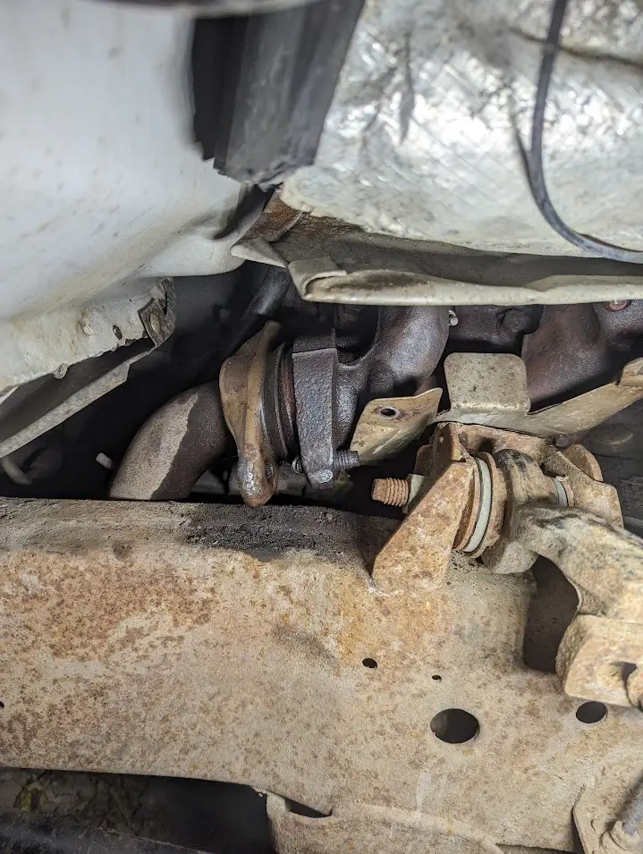

I have a hard time getting enough heat into the bolt with just welding on a nut. Could never get a strong enough weld or enough heat into the bolt to be successful
So I started using a piece of flat stock instead of a nut. It allows me to drill a hole larger then the stud and when you weld the flat stock to the stud you can get all the way around and really get some heat in there. I have 100% success rate with this method. Yes the flat stock is used to get the bolt free and turning then sometimes you have to cut it off so you can rotate it fully
Page 2 of the 07 ranger
Build I extracted broken stud from 5.0 and showed the technique
