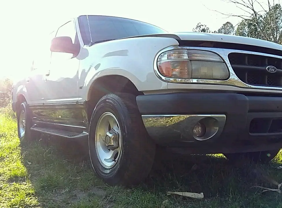

So an update, took the wheels and tires from my 99, bolted them on for now, other than one that's screwed up from the wreck, and the tires off the V8 are as follows. LR was a steel wheel, Michelin from 04, could see the air through the side walls it was so rotten and slick, RR was a slick Goodyear RTS, LF was a Uniroyal from 1995, and the wheel said 95 too (they put those on trucks in 95?) and the RF was a semi decent 2012 tire off a 98 I personally have seen in the JY and was gonna buy last June but the trans and engine were bad. Replaced all the tires but the RF, and the tread is close enough to mine I'm gonna go with it. Also got a photo, the hood isn't shut because the cable broke and opening it isn't great. This is what $200 got me, other than the hatch is blue.
