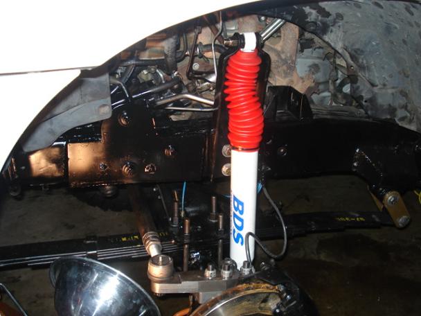

I was just thinking about my shocks, does it matter if the body of the shock is up or down? I know my Fox shocks had to be installed with the body up.
Yes, it can matter depending on the shock. My ProComps rode bad until i flipped them. Check what BDS says about installing them.
Oh i have those shocks on my explorer. It says on the body which way they have to be
I already thought about this, looked up the BDS website and it looks like you are good to go.
I've seen a few cases where the shocks run upside down make them pretty much useless.
Too True ! ! ! Actually increases the axle wrap on the rear when installed incorrectly!
