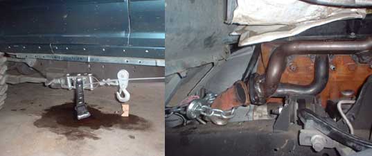

The headers in a 5.0 are pretty darn easy to get to/change. Take out the inner fender lining.. and remove the tire. You're good to go. I'd plan about 2hrs per side to be safe.

The fender well and tire are obvoiusly no problem. Its the heavily rusted manifold bolts which look to be stubborn. What about the AC? I've recently learned that the Haynes manual states that the AC needs to be removed before accessing the manifold to pipe flange.

Nope. I've installed headers a few times on V8 Explorers. No A/C removal or anything. My bolts were always fairly easy to remove too. Just make sure you have plenty of different length extensions and some of those trick 90 degree elbow deals. :D
Here's a couple pics so you can see just how explosed the headers are with the well clear. The come-along makes it easy to install FMS headers because they are a little (3/8") longer than the stock manifolds and with one person it is tough to hold the collector back to install the headers.

Ok. That makes it a little less daunting considering the AC can remain un-disturbed. So the burning question is: where on earth can I find a set of FMS's??? Would a salvage yard save an exhaust manifold when yanking a motor?
