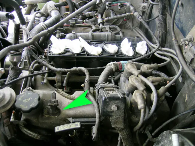

It's on the left[driver's side] valve cover, right behind where you add the oil I don't know how much they cost but you may want to have it tested before replacing it, it could be the connection or a short in the wire or ?
You might also be able to just take the little cap off it and clean the inside out to get you going. You will see a rotating metal "flag" in the part remaining in the truck-
inside the cap you removed will be a small gap where this flag passes through. Clean this gap out with a rag.

Your thinking about the OHV, not the SOHC.
The autozone link below has a picture of the CMP.
