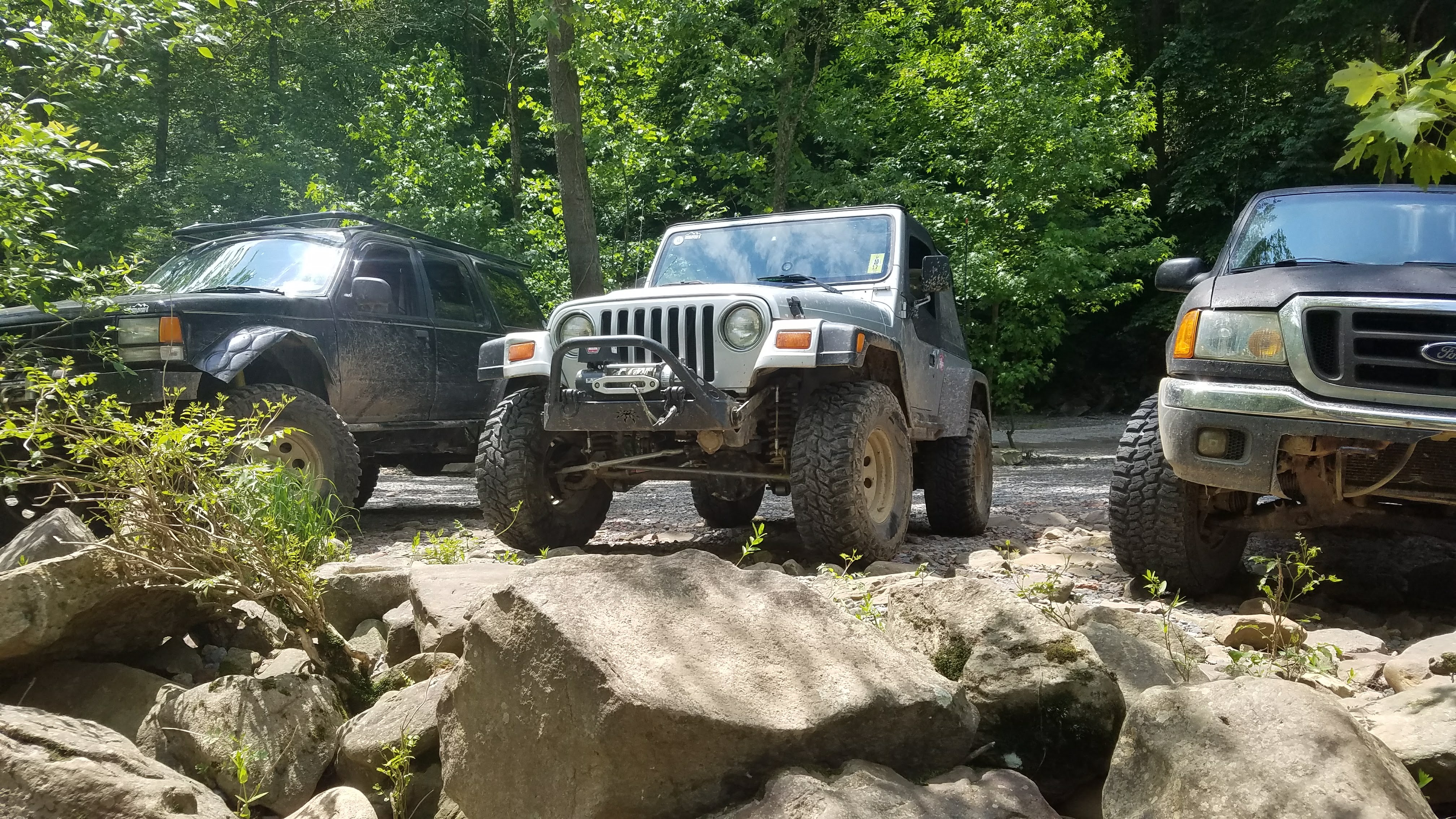

and I threw in a pic of the #wifesjeep

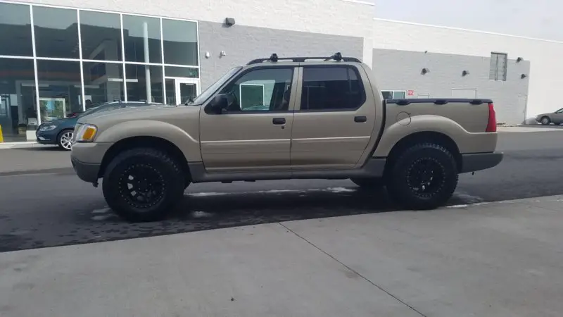

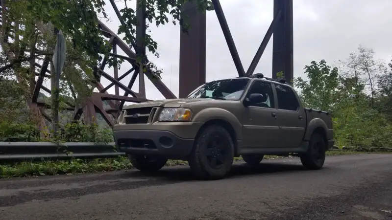

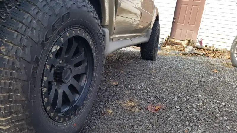

Whew its been a while.. The SportTrac took us on many adventures this past summer/fall and the fun hasn't stopped yet! I opted for 285/70r17 Falken Wildpeak AT3s wrapped around some pro comp wheels I scored from a shop with a decent selection of JK take offs. That required a TT up front and some trimming. The truck sits level but I am building leaf packs for the rear to get a little rake back. I have put 10k miles on this rig since June between weekend adventures and daily driving it to work. I am very pleased with the purchase and what I have into it dollar wise.
I still have my 44/8.8 combo and recently picked up a fw 8.8 and 44 to swap the good parts into. They may find themselves under this vehicle, then again they may not. I can never make up my mind.
On to the photo dump..
I have been talking to a friend of a friend about a simple bed cage to let me mount some tools on the side and a basket on top for extra space. When you throw your spare and a cooler in the bed you don't have much room for anything else.
I have lots of small things planned for this vehicle, just need the time to do it.

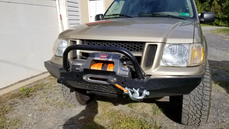

Managed to get a few things done this weekend between shifts at work. I picked up Affordable Offroad bumper for a Ranger, as well as a RCI skid, also for a Ranger. While these items did fit nice I will say they are not direct bolt ons for an Explorer or Sport trac. The frame horn bumper brackets are different on Explorers needing a 1/2" spacer to fit correctly.
The skid needs additional holes drilled in the frame to work with the ranger skid bolt pattern. The skid came with thread cutting bolts so it worked out fairly well. The skid and bottom of the bumper line up very well. I am pleased with how they turned out. I got hasty with trimming the front fascia and let the jigsaw walk on me a few time. I took it back off to clean it up.

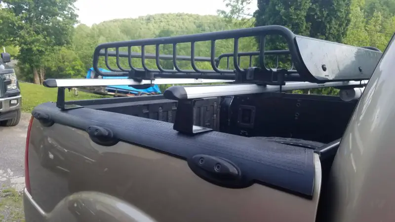

The bed bars I picked up off of amazon for $130. Technically they are ladder rack bars for trucks with a bed cover. While at first I wasn't sure I could use them without modification, I was able to find 2 spots per side where the steel liner of the bed came up high enough to contact the rack brackets.
