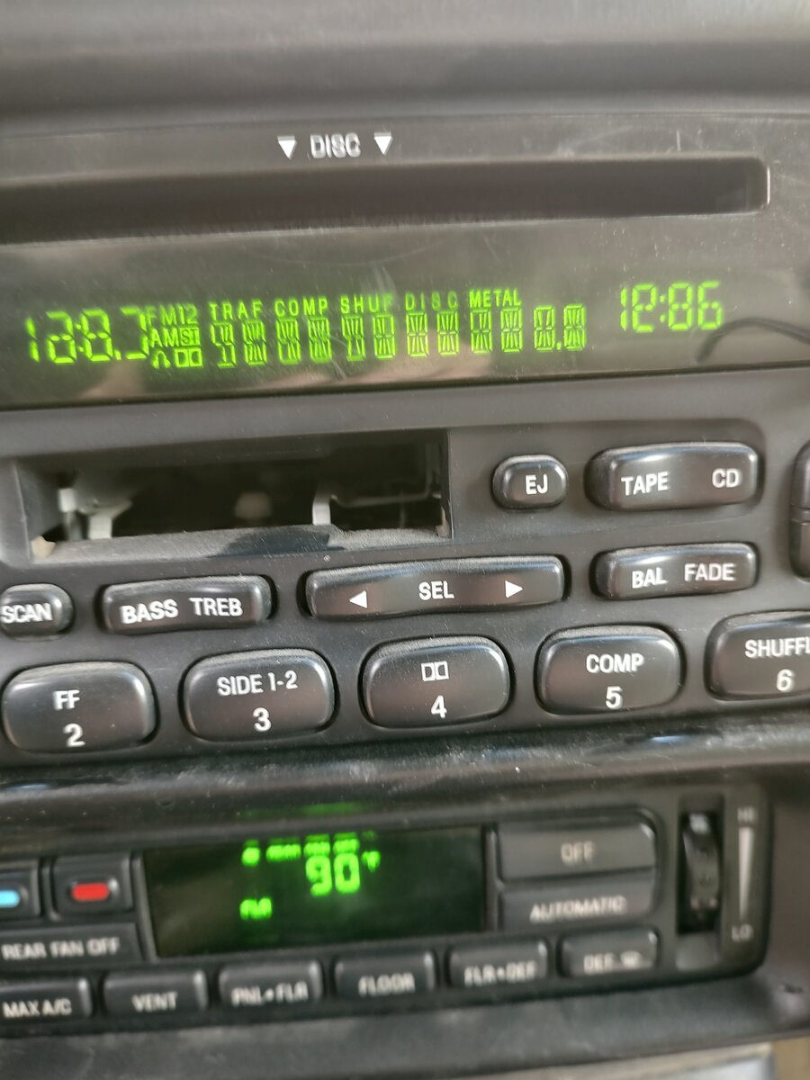

I think the "METAL" might be for cassette tapes that were called metal in the description. I had a case of Maxell M90 tapes that were from just before CD's came out.
