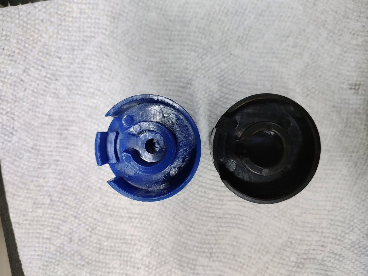

@410Fortune please, another question if I may. 2000 V8 Camshaft sensor alignment. I have these tools, which is proper? Blue one doesn't seem right, and also has a provision for something tall in center. My sensor seemed closer to the black one after getting crank in position. Rotated clockwise to tdc then back to 10 btdc to take up chain slack

@410Fortune please, another question if I may. 2000 V8 Camshaft sensor alignment. I have these tools, which is proper? Blue one doesn't seem right, and also has a provision for something tall in center. My sensor seemed closer to the black one after getting crank in position. Rotated clockwise to tdc then back to 10 btdc to take up chain slackView attachment 441801View attachment 441802
i dont think either of those is correct jon. you should have a black one with a haft moon in the center if i am not wrong
My 2000 sensor has a very narrow flag compared to 98 style half circle flag. Both above pictured tools "fit"my sensor. The set of sensor tools I purchased had 3 others with half circle slots.
Blue and black to left fit my sensor. I believe the grey is 98 style. All arrows on tools pointing left. Black matches OTC 6470 , blue is OTC 6473

Black is correct
2 wire sensor the flag is set in the middle of the window when aligning cam synchro with engine at tdc compression
3 wire sensor is the half moon style up to 97
