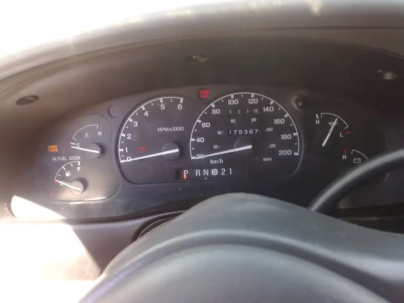

Why is the battery light on?
Im going outside to check, but I dont think it should be on, like ever.
Going out for a smoke and checking on my stock 98.
Bob
Bob

I take it back. :scratch:
It is on.
I just thought it was running because of the oil psi but if I remember correctly, that not working just yet.
Bob
It is on.
Bob

I just turned the ignition for the picture, but didn't have the engine running, because the battery is on charge.. the beauty about having a lifted truck (BL) is that I can put the battery charger on top of the engine, and still close the hood!
That's why the engine light is on, and the door ajar light, but I'm happy to report that al the warning lights go out when they should.
I also put the limited front door speakers in place of the standard rear speakers, gives a slightly bassier sound.
Si

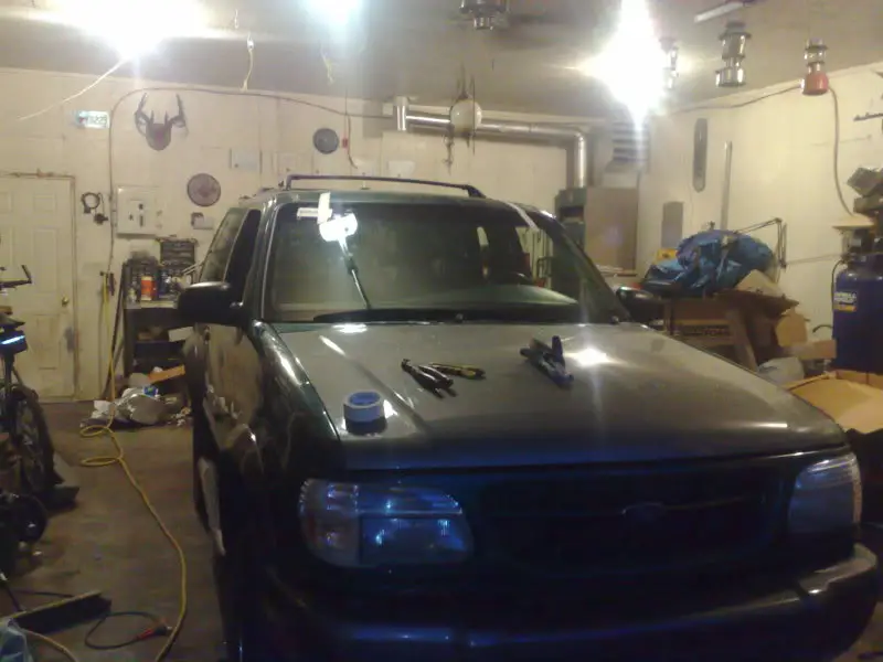

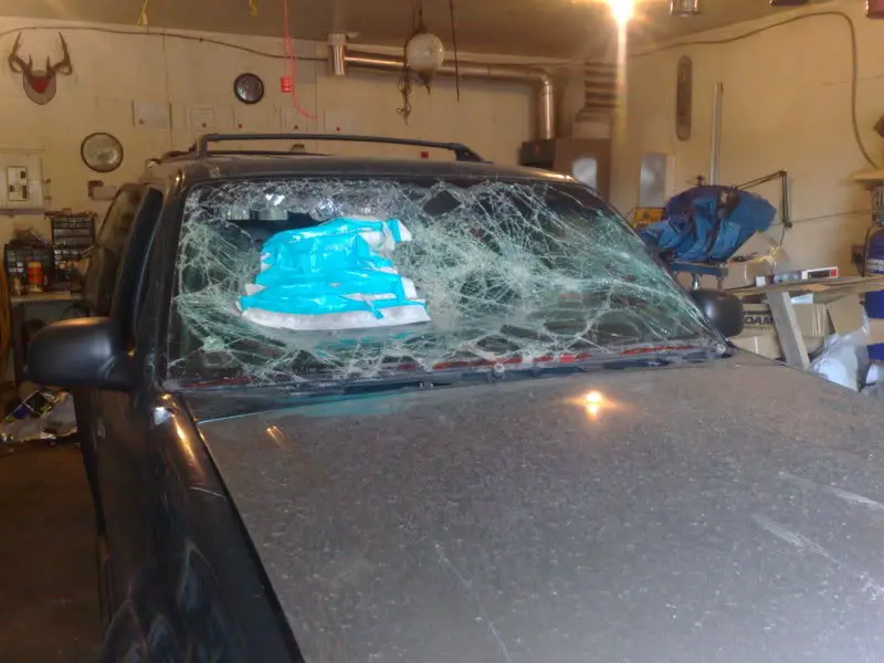

Well, I phoned the guy about my safety today and he's in the states, so he probably can't do it till next week, so I phoned the guy about installing my windshield... he's just this minute left... so now I have a lovely shiny new windshield, thanks to Sarah who bought me the glass!!
Before
After
I'm really pleased, I might take it for a blast down the alleyway tomorrow... maybe...
Si
Before
After
Si
