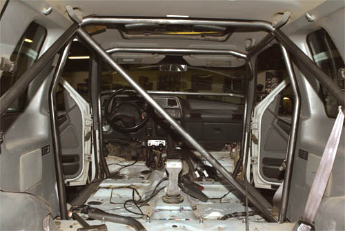

Simple works. Here's a couple of shots of mine being installed.

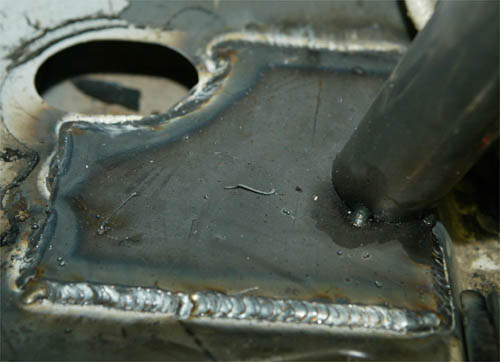

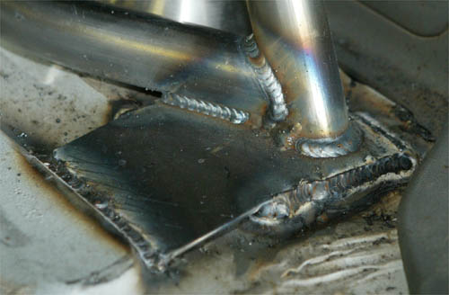

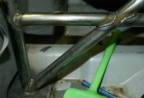

I've been searching my pics and here's a couple of more. We decided to weld it done versus bolting and reenforcing cause we figured in rock crawling rolls are slower and less violent.Exactly what happen to me. Brian has some close up fotos of the damage to the top. Hope's he post them, he's working this week.
First one is the spare mount tied into the cage.
