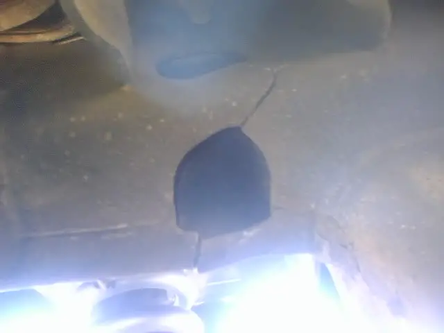

new frame problem...
Wow. :eek: Where exactly at the front is that? Looks like its in a spot that would at least be easy to fix. (kinda hard to tell?)
I hope this doesnt stall you parallel 4link plans, as i was hoping you would do all the math and get the bugs worked out and i could just copy it when you're done. :p:
its right between the lower a arm pivots. the hole is the access hole for the motor mount bolt, which of course creates a weak point in the frame. the cracks have been drilled and welded and will be plated this weekend. but it just goes to show the abuse dished out to this thing lol.

Yep ill be out at the night race with the BTF guys. My frame is fixed and the lower a arm mounts now have a nice beefy cross member so its ready for a beating. Also buying 100ft of 1 3/4 DOM tommorow, this bad boy will be caged very very soon. I know some people coming up from that area, but im not sure if anyone will have enough room for wheels/tires but i will ask around and see what i can do..
