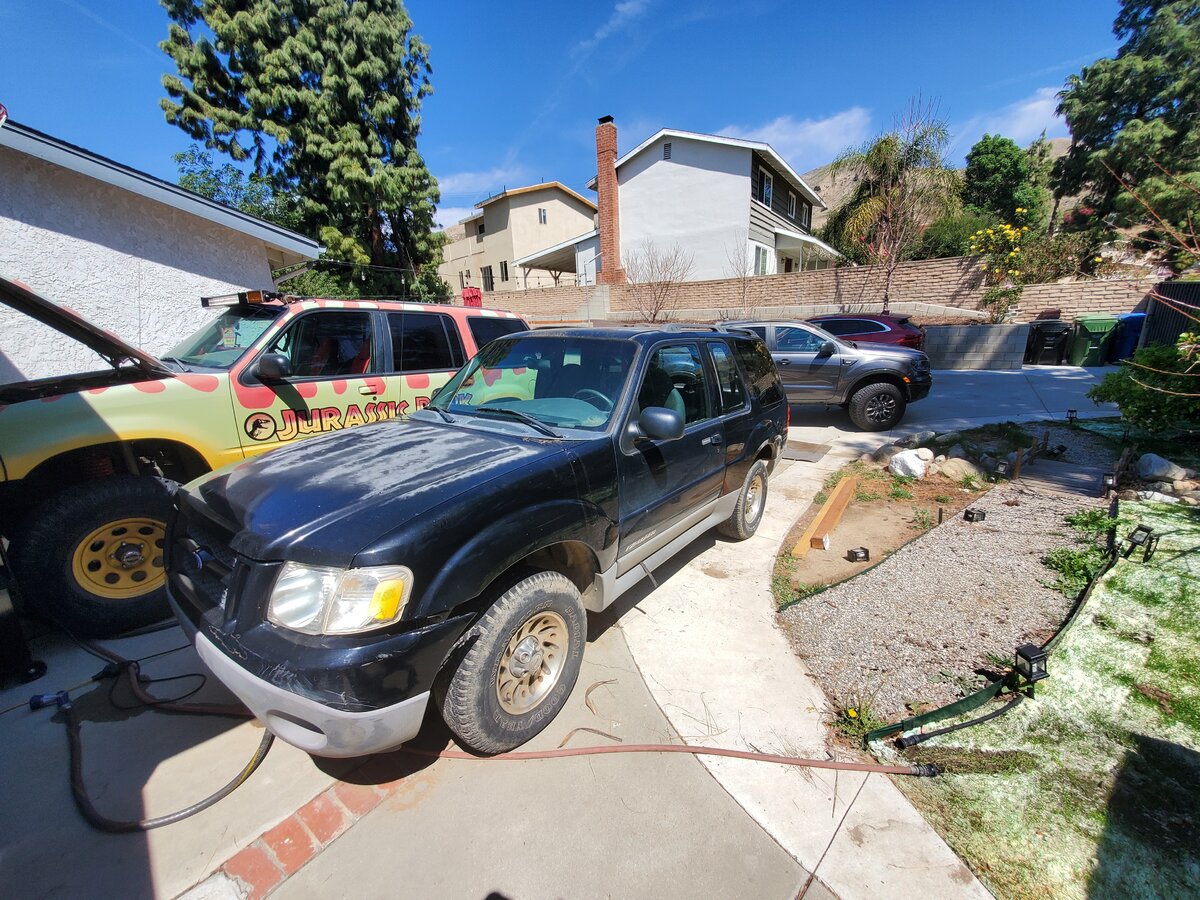

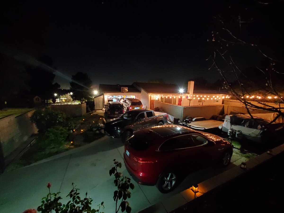

You're gonna need a bigger yard
Nah...it will be gone in a few months, at worst. I have 4 plus the pop up now, and if I pack them all in, I could probably get 4 more in the yard. Not that that's going to happen. I still have another 1st gen sport at my dad's that needs to go to the crusher after I pull a few more things off it.

It does all fit in there. I have nearly run out of room with the RV, the boat, Explorer, Infinity and my Silverado. I could remove a low wall/seating area in the backyard to get a few more vehicles back there, but someone in the house is not agreeable to that. I do have just enough garage space for a nice used Porsche 997. When the right one comes along, I will have a full garage.

I could knock down walls for more room, but someone else wasn't on board with that either.
Anyway more pics before I start ripping it apart.
Got her up to operating temp, and runs smooth. No codes.
