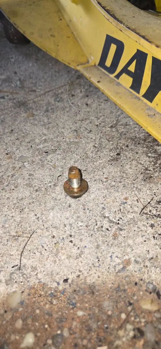

DAG NABBIT...HOW..found this stupid crap under/behind the torque convertor, now it sits in fully and just behind the bell housing, AND GUESS WHAT...SPINS FREELY...I don't even know what that bolt is from, looks like an engine mounting one but I have all 6, so I'm not sure. But dang that seems to be it..
@DemonMudder Hey, thank goodness it was a little problem and not a big one, yeah?
Thatll do it. Problem is where its from haha. But it wouldnt be a DIY job without a few questions of whre is this bolt/other ahrdware form from
