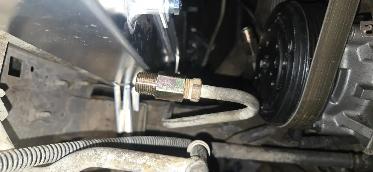

Okay, well, new fun: got the tranny line adapters for the radiator in and cool, they fit on the lines!...but they don't fit into the radiator. They're slightly too big to go in, so now I either have to re-tap that radiator, or put an adapter on an adapter which is a "fun" choice, but may run it till I can figure something out.

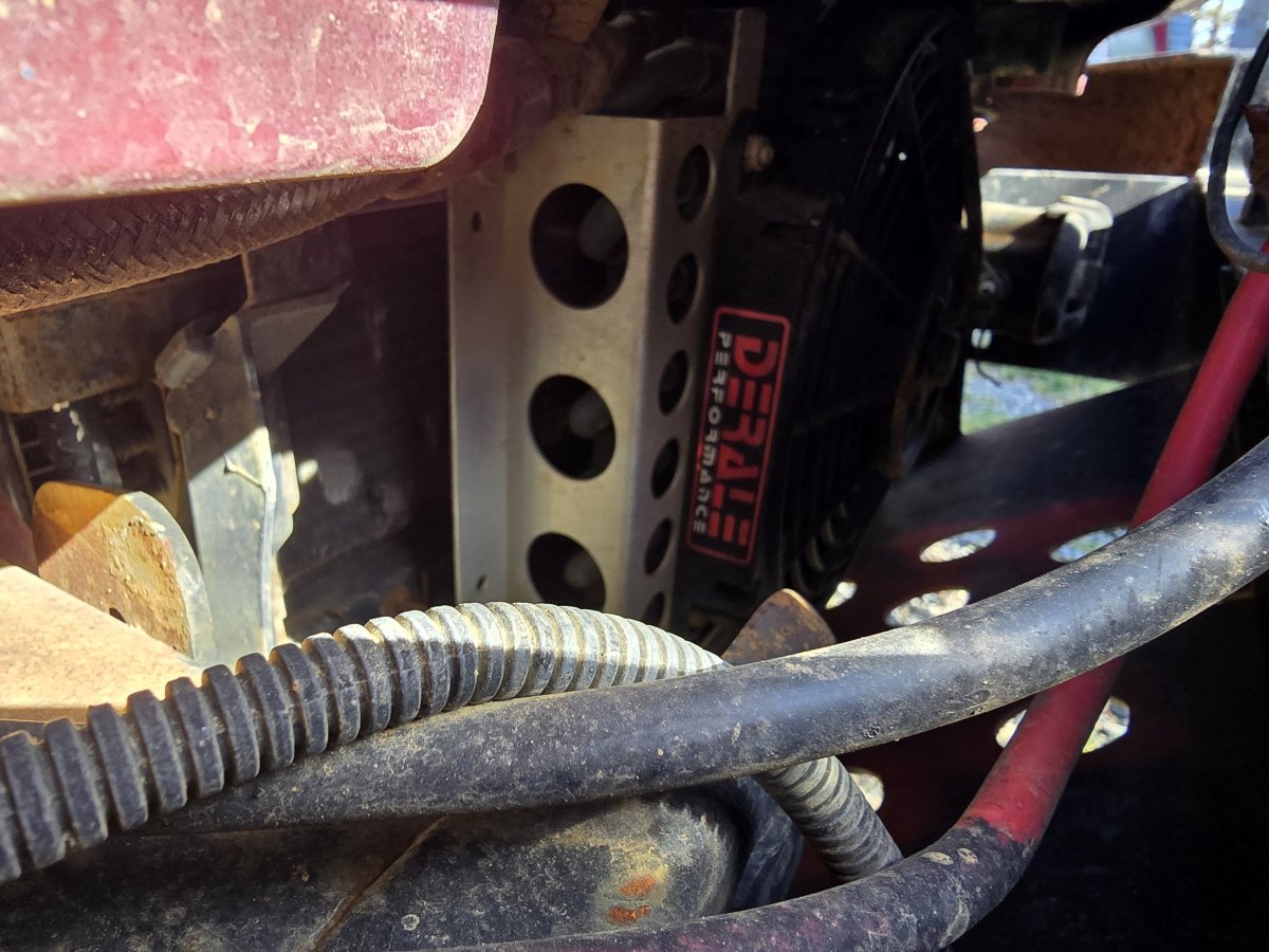

There are other options than dumping 400 degree heat into the radiator...
Just sayin... ;)
That a better tranny cooler I'm looking at?
Yes. Never touches the radiator. I use the trans Ports on the radiator for fan control temp sensor and temp gage
I've got one on the front too, but yes, I definitely need to and PLAN to upgrade it later! Almost did during all this, but decided to hold off for funding sake. Speaking of....mind sending me the link the for one you used?
Thanm you! Did you still keep it run through both, or just the cooler?
Just the cooler. Ran AN6 braided stainless lines to the trans.
The fan rarely comes on during regular street driving. Runs a fair bit on the trails in the summer.
Sweet! Thank you! Would love me some braided stainless! Especially brake lines! Good to know, probably better than me trying to make a 40k fit like I planned for the rado! Lmao
Well, thanks to an 01 sport at the junkyard, found a set of adapters that work! So lines are hooked in! Funny enough, some of the others I grabbed to try, I think are the same as the ones i bought, last picture showing the old vs the brand new one.
Excellent, got it done in the end.
I've seen that fitting before on some cars, but who knows how the connections change. Congrats on finding that solution.
