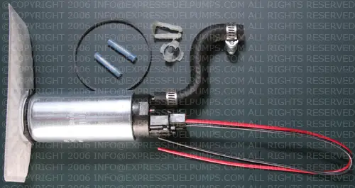

How about this?? It is a genuine Walbro, and guarateed for 3 years
http://cgi.ebay.com/ebaymotors/85-9...emQQcategoryZ33555QQihZ019QQitemZ290066191533
Your still driving it arent you? Hahaha drop the tank and have a look see first before you throw parts at it.
