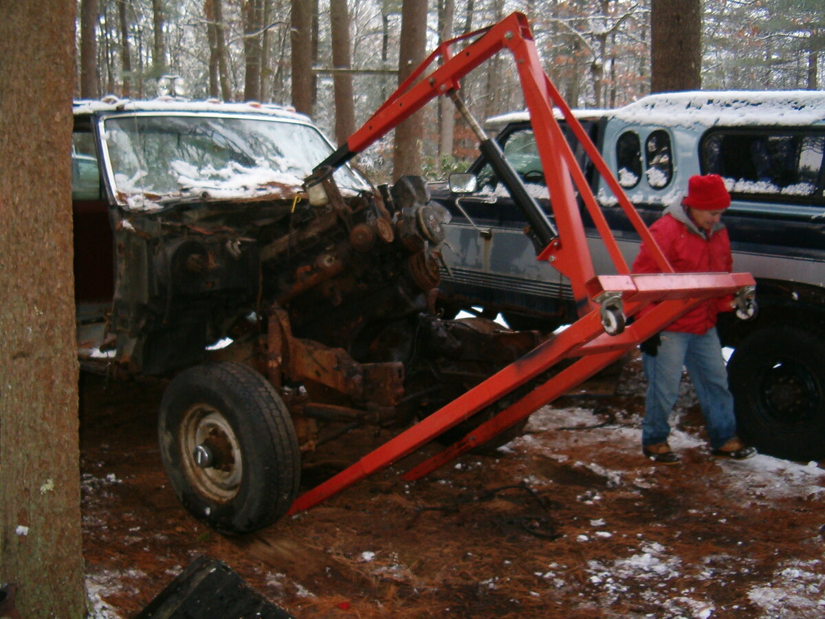

6.9 pull from a 1986 my boom wouldnt lift it high enough i had to drag the truck out from under it backwards. something got snagged and instead of gliding out the boom pivoted up
