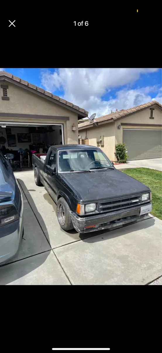

Hey guys new here i’m luna and got a 1987 B2000 he’s an old man but Im tryna keep it alive. Recently I changed the clutch and flywheel but also the starter since it had given out. But i have a problem w the starter I got it from autozone and it says it’s for my truck year but it bangs against the flywheel any help w what other starter year is could use to solve this issue Im coming back from autozone w another starter as i type this. Please any help is welcome. I have plans for this lil truck and will post as I go along gonna be saving up to redo the front suspension soon

Thanks! got a couple things I wanna do to it! Gonna be working construction for about a year straight saving up to really put money into it.
