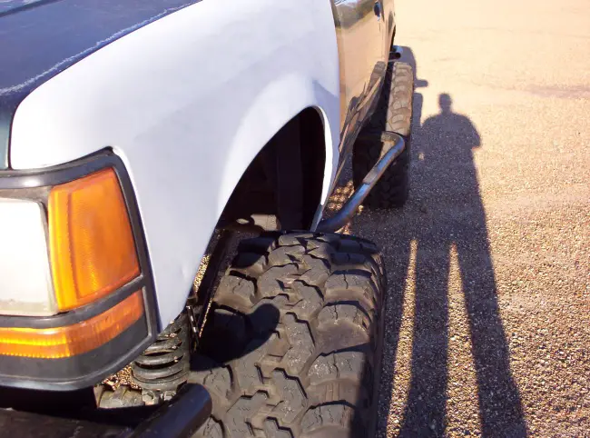

I got the thing flexed out last week, but forgot the camera. Rear leaves flex AWESOME. I was shocked. Only thing i can think of is moving the rear back, the housing is closer to the center of the spring and gets more travel. Either way, the ride and flex is sweet. Now i need to do some up/down travel testing to get bumpstops set.
Been working on the front fenders, cutting more out and getting the opening lined up centered with the tire. Lip rolled on the edge for prettyness... its hard to tell from the pics. I hope to start working on the rear this weekend.
The drivers front tire rubbed on the horn so i had to cut it off. :confused:

Danny- fenders arent white they are light grey primer... but it was tempting to paint them white and slap on a kottonmouth kings sticker. :p:
stonedjohn- Ive got some pliers i made, just two pieces of plate welded to them at the teeth. Lets say you want a 1" lip... cut fender out 1" smaller than what you want to end up with. Draw a line 1" above, following line with pliers bend just a LEEEETLE bit all the way around. Next pass a little more, next pass a little more, once you get it around 45 degrees hammer it to 90 degrees with your bodyhammer. Once done, go back over it with the hammer and a dolly on the backside to get out hammer marks. I didnt take alot of time on the last step... up close you can still see a few marks but the EB i did last time looked factory.

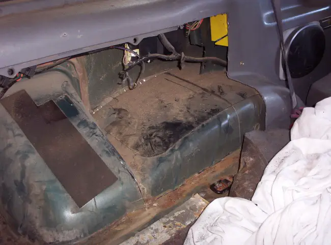

I started on the rear fenders today-
Didnt get as much done as planned... between working on random kids bicycles and helping neighbor(s) with their stuff im behind in shedyule.
Anyhoo, inside plastic panel thingy got chopped to hell. It will be finished out with some fiberglass once the cage is in. Inner fenders are getting stretched to go with the new rear opening.
Just to keep me from searching... anyone know what the computer looking box thingy with the harness is on the driver's side inner fender? Not the wiper control box but the other one?

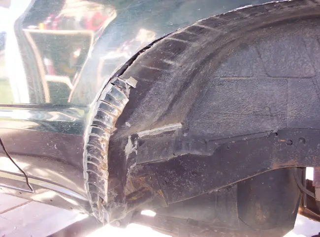

Quick outside shot as i was cutting/dealing with previous owner fender trimming. Mudtrapping fingers of doom. THANKS PHIL! :p:

ddbc
March 16, 2008
45
Gold Bar, WA.
'91 explorer xl
its your 4x4 controle modual.

Texarkana AR/TX
94 SAS sport
Ah, so throwing it in the trash is not so good idea huh? :p: Im new to 1st gens so bare with me. Why the need for 3 harnesses and 5 million wires to go to some box to control 2 switches that run the transfer case?
