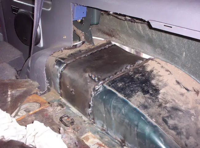

Driver's side inner done, i did not bother taking alot of time on the inner fenders because these are getting covered up with some fiberglass, then covered over with a custom panel once the cage is in.
Stretched 8", more to come-

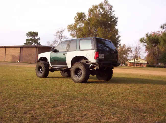

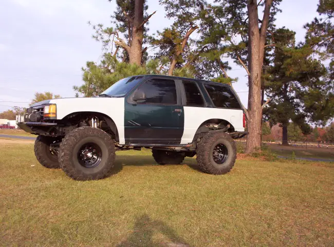

Got any pictures from the outside?
Ill get some today. You mean a sideshot of the truck itself or outside of the inner fenderwell?
The exterior view. How big is your new opening in the fender?
Well, it doesnt come down all the way so there really isnt a good way to measure it... all four are 9.5" from the top of the tread to the center of the opening.
I think it will look alot better once the inner fenders are finished and covered with undercoating.
Crappy pics- unlevel ground so it isnt sitting even but you get the idea

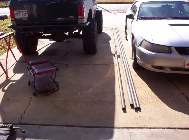

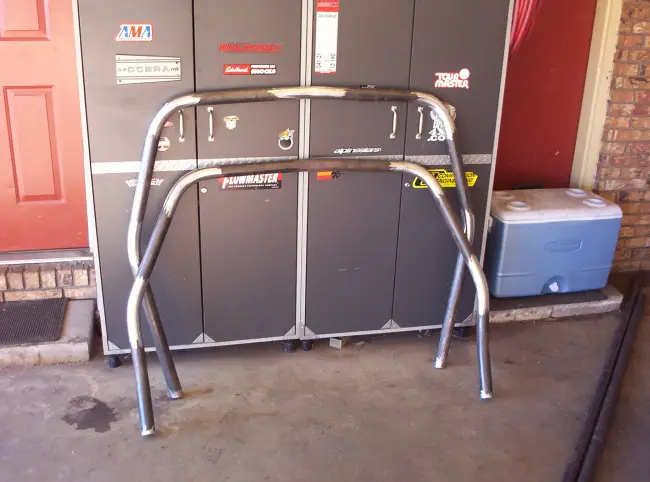

B and C pillar are done. They fit tight as hell... up againts the headliner and both side panels. Now im off to yank the dash and dome light, and drink more beer. :p:
pic doesnt really show but C is bent to lean forward-

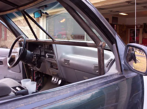

You make it look easy!
It aint lol, **** going through the dash its going in front of it.
After looking, and looking, and more looking the only thing i can figure is those of you with A pillars through the dash have no heat, no A/C, and run a carb. :p: Either that, or you've got some kind of talent that i dont have.
Anyhoo, ill get better pics tomorrow. The A pillar is NOT AT ALL how i wanted to do it, but itll work.

Anyhow, A and B are done with exception of door bars. I cut an "L" shaped slit in the floor and bent it down to lower cage down to get to the top welds... um FYI there is a wiring loom on the floor under the drivers rear seat thats really soft and easy to cut lol. Now my passenger window wont go up, no turn signals, and who knows what else. :o
I am not happy with the way i did the A pillar. Not from a strength standpoint, but from a looks standpoint. I needed a whole bunch of out of plane bends in it that were impossible for the HF kinker i was using. This is the best i could do.
I also suffer from POS camera syndrome... the welds look god aweful in pics and some pics the cage looks crooked (???) It looks good in real life and everything is level.
