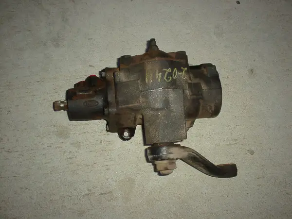

Used PS Gearbox:
Reman. PS Pump:

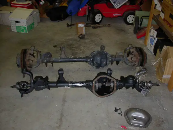

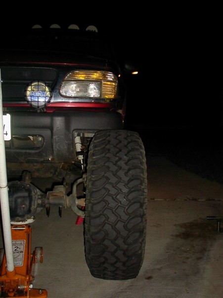

I was rotating my tires, so I figured I'd mount them onto my new axle for kicks. Turns out that the D30 is actually 2" wider than the Ex stock. (yes, this was a pain without a tie-rod). . .
. . .so my fenders will no longer cover my tires.
wow, didn't know that. It's actually kind of suprising seeing how small the cherokee looks.
does it use the same steering knuckles as the dana 30?
keep 5 on 4.5?

Holy crap Jefe that is awesome man! So that thing has the same exterior mounts as the D30 huh. That's alot of money, but in my mind that is perfect. No cutting down, no buying adapters, just right! Very nice.

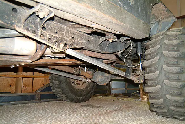

Here is a shot of a modified TJ suspension just for some ideas :D

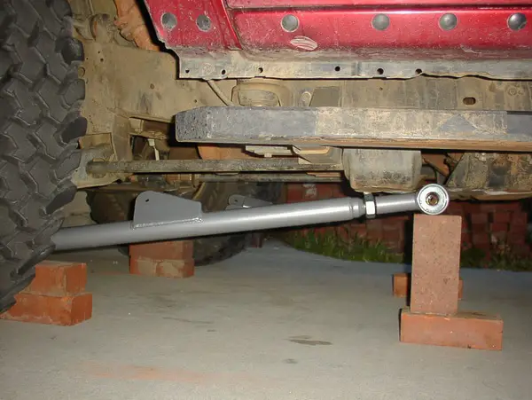

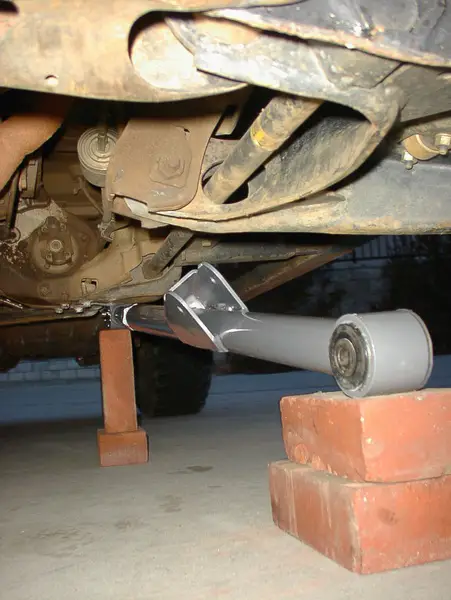

Got some more parts in:
D44 Rubicon housing:
Rubicon Express Long Arms:
Test fitting under explorer. This will be the angle and position of the arm with 6-7" of lift.
Looking down the arm:

Get a shop to fab some mounts like this WJ. Should work good I think. Ive been looking into this also.
I'll be doing all the fab work myself, but yes, that is the plan. Thanks for the link.
