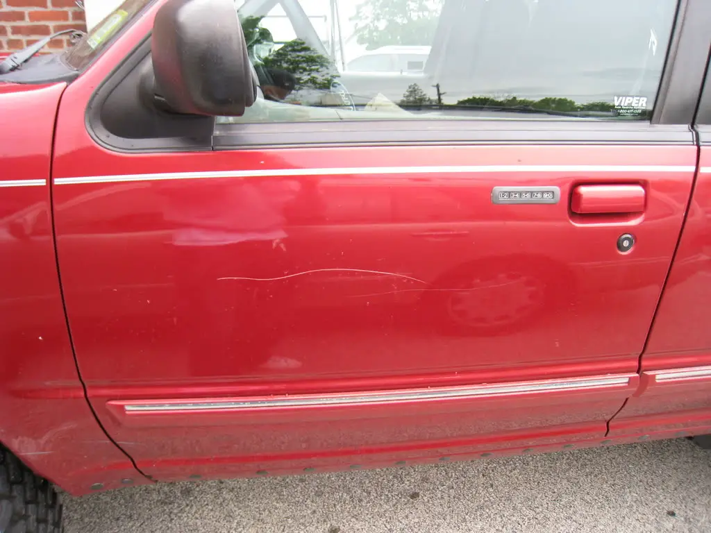

The deep scratch (you can see the front door half of the light scratch below it, halfway back):

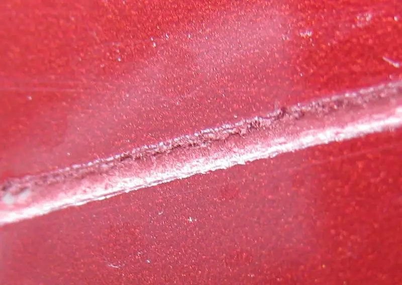

And here's a super close macro of the deep scratch:
I've waxed it, and it still looks like crap. I'm going to try some of this stuff:
...to try to minimize the depth and appearance of it for the time being.

Its completely through the clear coat, not much you're going to be able to do. Carefully building up touch up paint in the gouges is a possibility, however with metallic paint wetsanding the excess off will cause a significant color difference.
I'd skip the cheap scratch off crap. My opinion would be to have it either repaired or live with it.

Well I worked on it today. Used some rubbing and polishing compounds and that scratch remover stuff, and the light clear coat scratches are almost invisible. A little more work and I can get them to totally disappear. The deep scratch is a little bit better, but it still looks like crap. Obviously a little compound and whatnot is not going to solve the problem, but hopefully I can make it look respectable. The scratch remover stuff actually works pretty well, seems to have made it less deep and more smooth.
