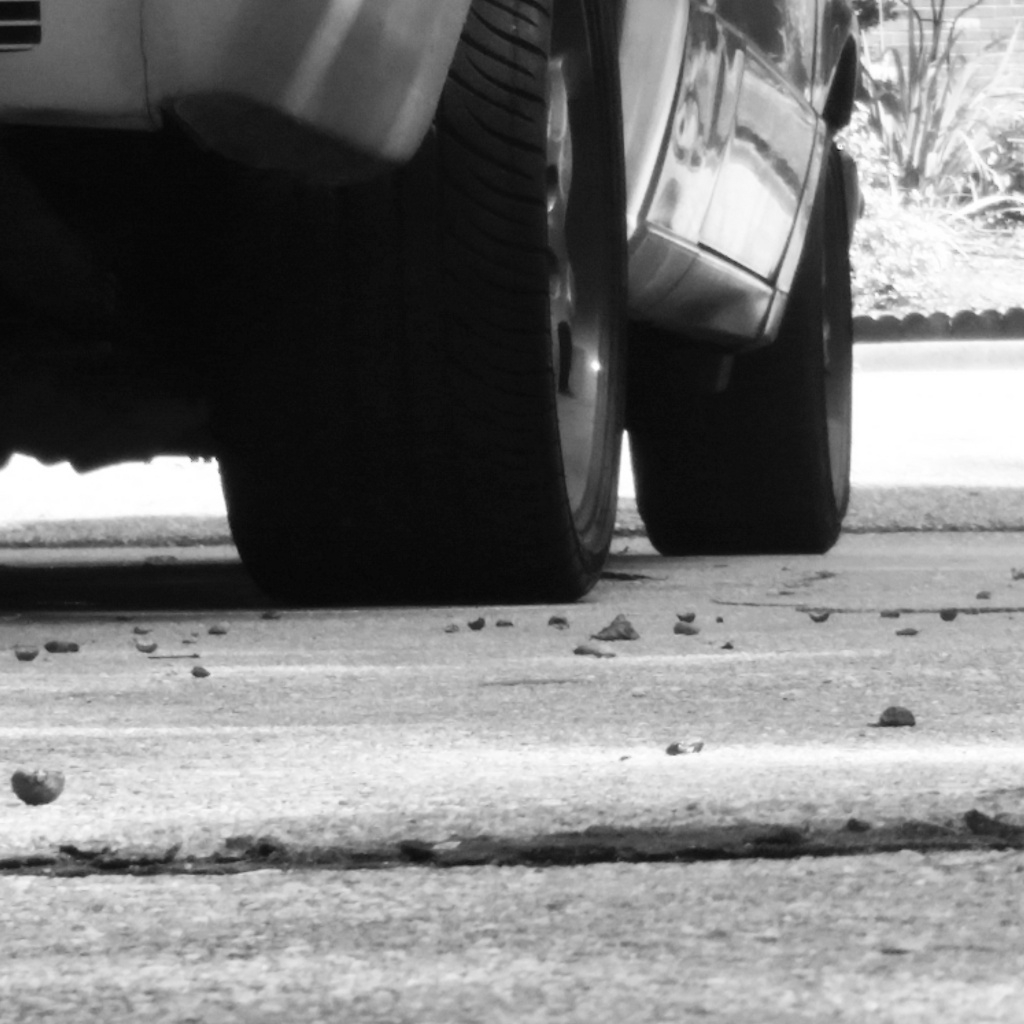

Some pictures. .first was just a cool pic of how meaty thise rears really are..second is the C-notches i got from a guy on ebay. .yes i could have made them but just didnt feel like it and they are thick!!

that wide rubber stance, and rim combo look awesome.
