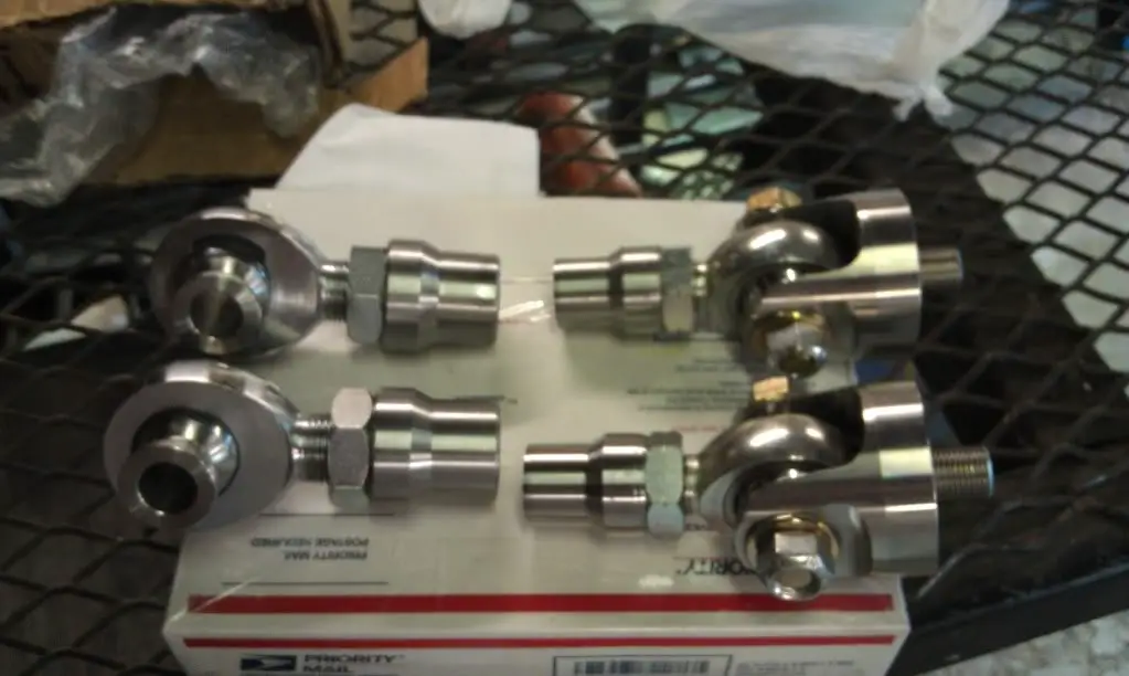

Decided to go with tapered pins for the outer heim instead of drilling out the spindle. Ordered a set from BTF and they should be arriving any day. Also decided to go with weld-in bungs instead of tapping the tubing, and I got those in from Ruffstuff Specialties last week.

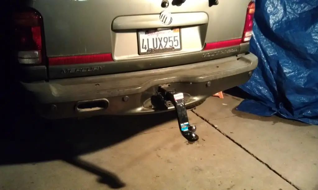

And I spent this week working on a project that I've been wanting to do for a looong time. Did the hitch portion of a Jefe-inspired spare tire carrier. It's 2x3x1/4" tubing with a 2" receiver, bolt-on using 10 bolts, and is completely hidden behind the stock bumper. Was able to keep the back up sensors and the amber light I have in the bumper too, and my spare still fits underneath the back. Turns out I really suck at measuring, so the bumper is a little crooked on one side and a little more crooked on the other, but it doesn't bother me too much.
I need to get a spindle to use for the tire carrier portion since there is no way the Dana 30 hub I have will fit, and then I'll build the tire carrier gate with a gas can and license plate mount.

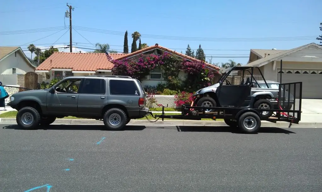

Anyway, put the hitch to the test yesterday and towed out to Barstow. Trans got a little hot going up the Cajon Pass but other than that it did pretty well.

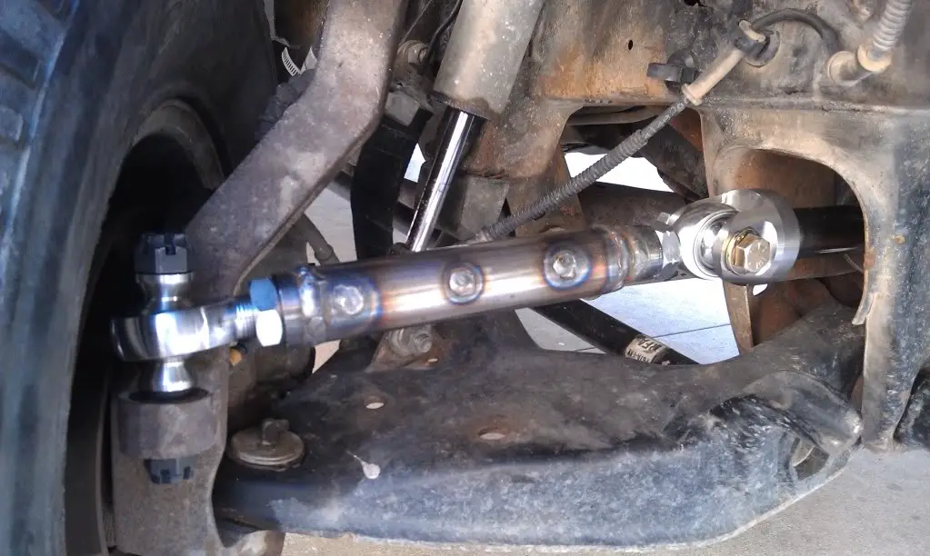

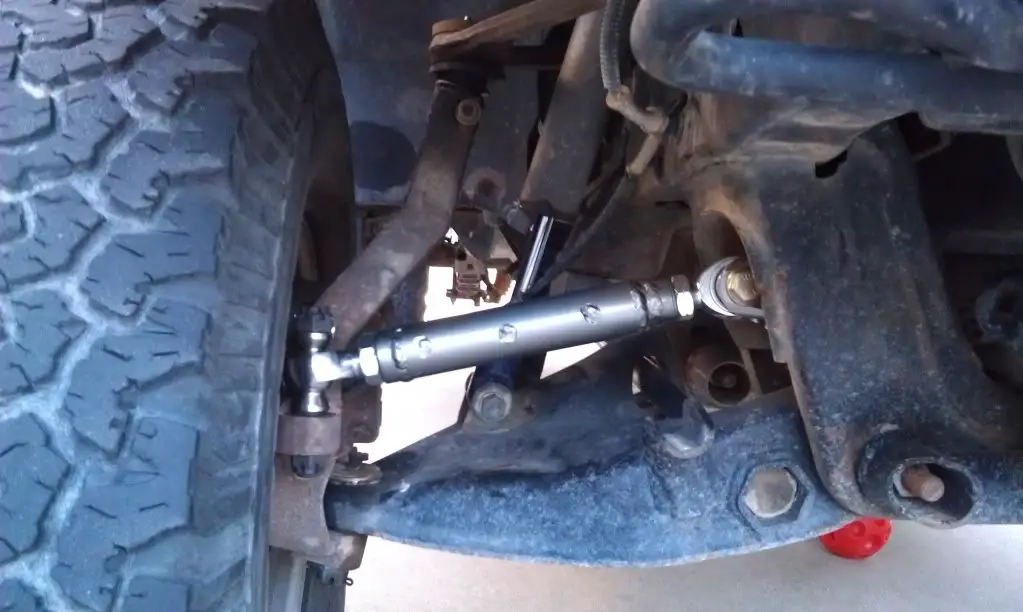

Made the passenger's side heimed tierod today. Will make the driver's side sometime this week or next weekend.
And decided to paint it the color of the truck, which I think looks really cool from a distance.
I like the hitch. I have been thinking about doing just that. I need one but haven't got one cause I don't want it to get hung up all the time.

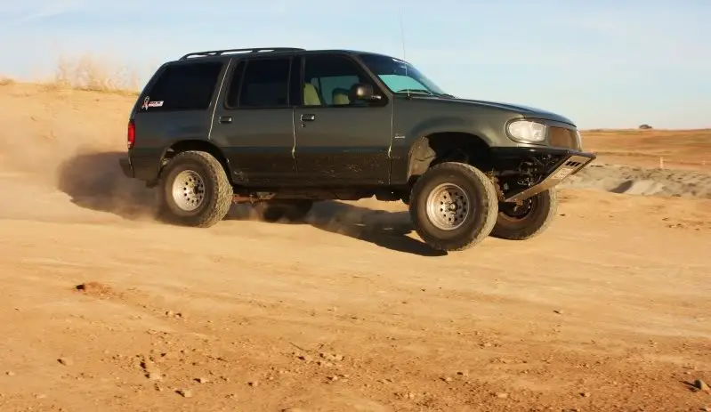

Thought I'd post some pics a friend took of a trip to Prairie City I made last month. It was fun to get in the dirt a little bit, but it left me anxious for a REAL offroad trip. Hoping to make it out for New Year's on a trip I have planned to take dirt from Cal City all the way to Johnson Valley. But for now, just some cool pictures.
