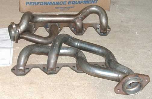

...and if you look at the FMS headers VS these ones... you can see how FMS cheats by having more than one exhaust port exit through the tube. So it seems that these would flow way better to begin with.
