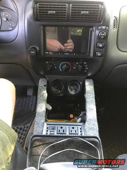

My center consul box will go away with a 4406 swapped-in. The seats are high back bucket/bench seats out of a 2005 Ranger, with a store bought consul mounted/sitting on the middle seat. I'm 6'2" and the seats fit me well. I bought seat covers to get the fronts and rears to match.
I did not like how upright the rear seats are. I used 3 thicker washers as spacers under the front seat mounts to place the front of the seat higher. Then I placed metal axle wedges under the center seat belt/seat mount and used two 3/8" thick nuts nuts as spacers on the side mounting bolts to space and lean the side seat mounts back.

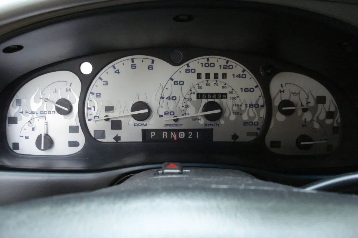

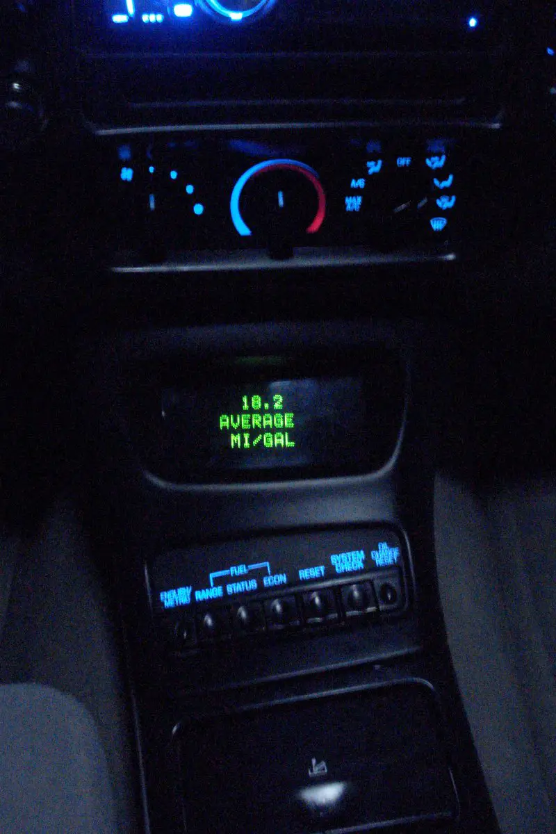

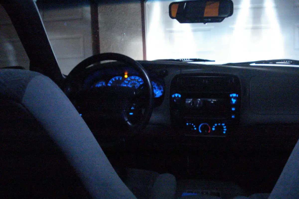

gauge overlays from a place called speedhut. since the last pic (these are old btw) the backlights were changed from 194's to white 194 LED

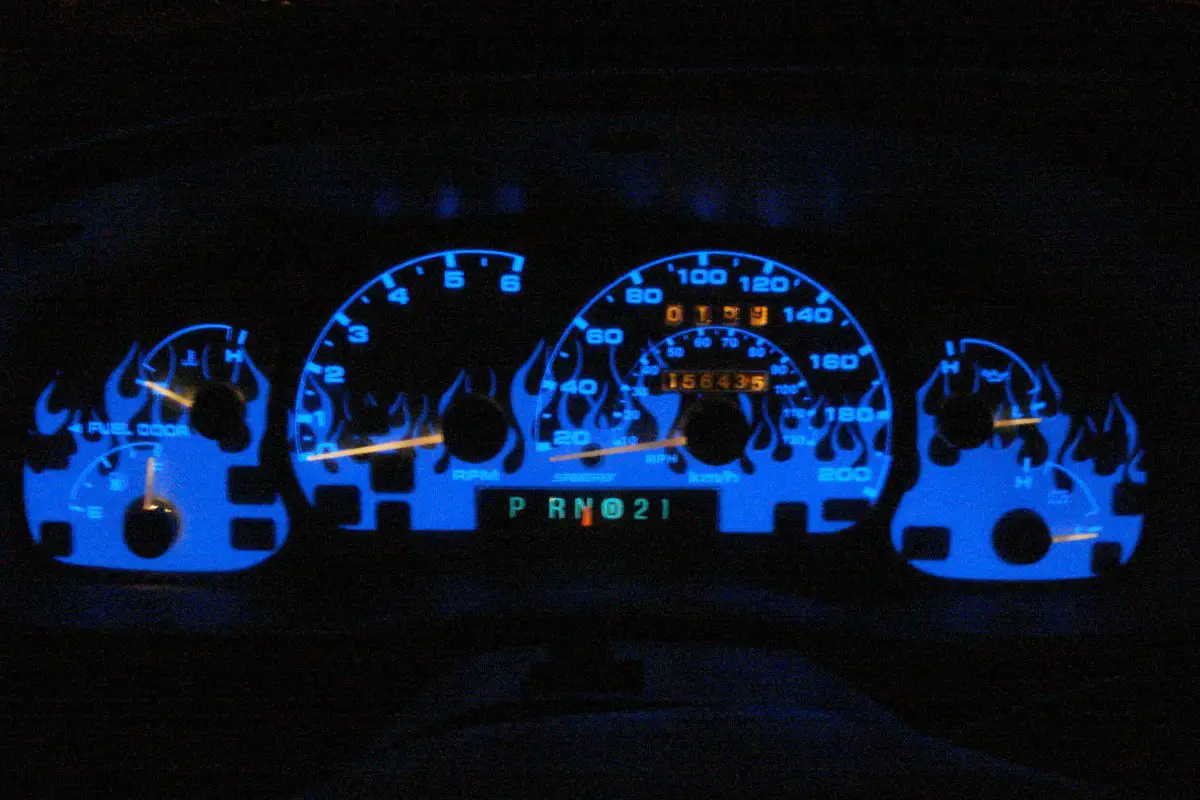

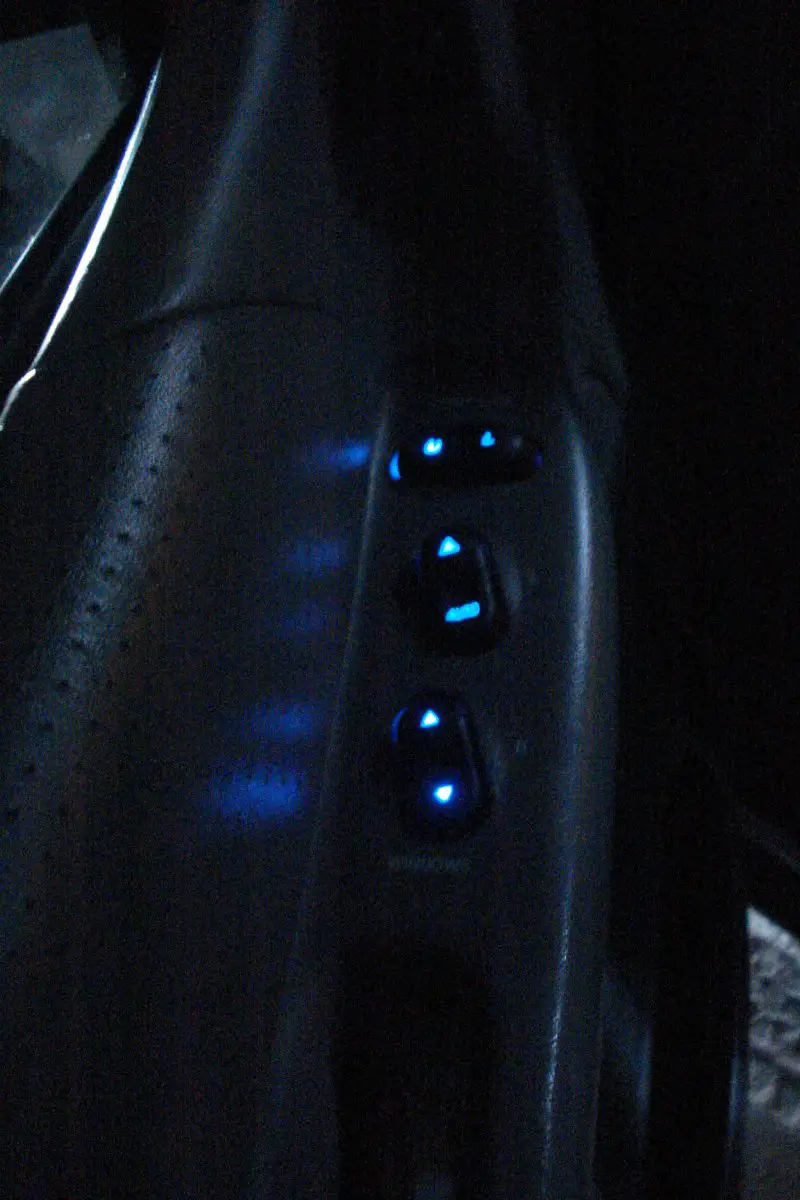

went wild with LED stuff. changed the arm rest buttons to blue LED as well as the fog, 4x4, rear defrost, and rear wiper buttons. pulled the heater controls apart and change that to blue. later on i put a message center (that did function except for the low oil) and added blue LED's to it.
other things that were added that the truck didnt have from factory was cruise, overhead console, auto dimming mirror and full length certer console. the interior lights are also LED's but white.
since all these were taken however, the message center has been taken out. it no longer functioned with the terminator X. the rear wiper, and 4x4 switches have also been removed, and my holley screen has been added, and the bezel has been hydro dipped with a carbon fiber print

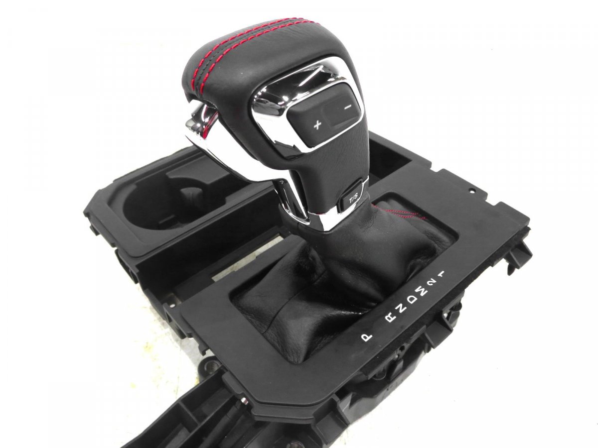

Here's the F150 shifter though, I bought it new with the Raptor handle, and a shift cable. I've mocked it up with my console out, it will mount fairly easily to the floor. The air ducts will need some altering, if to remain functional or just delete the air.
This below is just a picture of an F150 shifter that has the red thread trim, some King Ranch option I think. The trim piece is what I still lack, it's a $275 new part, I'll pass on that price. The new shifter is complete and came with the boot.

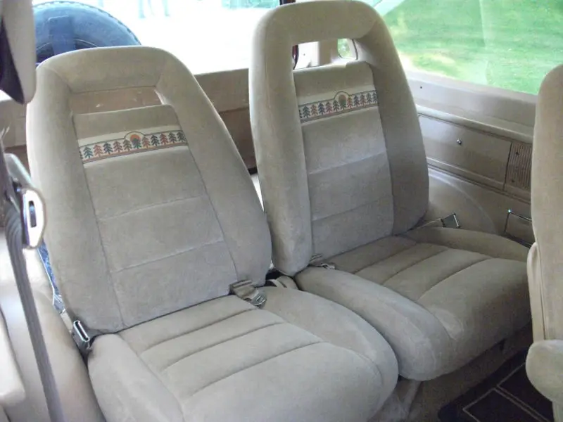

Oh BTW, keep an eye out for the super rare early 2nd gen rear seats. Some very few had a slightly reclining feature, but it was so slightly that they stopped making them.
BIIs had them too
I would bet that is where the idea came from. But as they turned out in the 2nd gen Explorer, the couple of inches they moved was not appreciated. I wish the rear seats were a lot more comfortable, having them reworked by an upholstery shop would be cool. I wonder what could be done to remake them as two half seats instead of 1/3 to 2/3 widths. Make them recline enough to be likeable, and add some contour to them, maybe a small console in the middle(Jim has that plan already).
Could you just use the 50/50 seats from a two door? They'd sit further back (fit between the wheel wells), but that wouldn't be a bad thing to have more leg room IMO.

the door switches, and center console i used individual LED's with a single resister for them like this
you can buy single LED's now ready to go, i did those probably 14 or more years ago lol

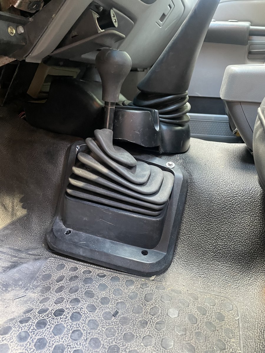

My 03 trac is using late model ranger 5 speed shifter floor console with two cupholders
I had to trim the drivers cup holder to clear the 4406 shifter and ranger manual t case shift boot

The shifter arm has been chop cut welded
M5r2 shifter hole lands same place or very close to 5 speed ranger
Sport tracs have the body restraints control module mounted on the center hump same as ranger, so it was nice to have this correct late model piece that also covers the module
I believe this is a ranger manual t case shift boot but I could be wrong it could be f150
