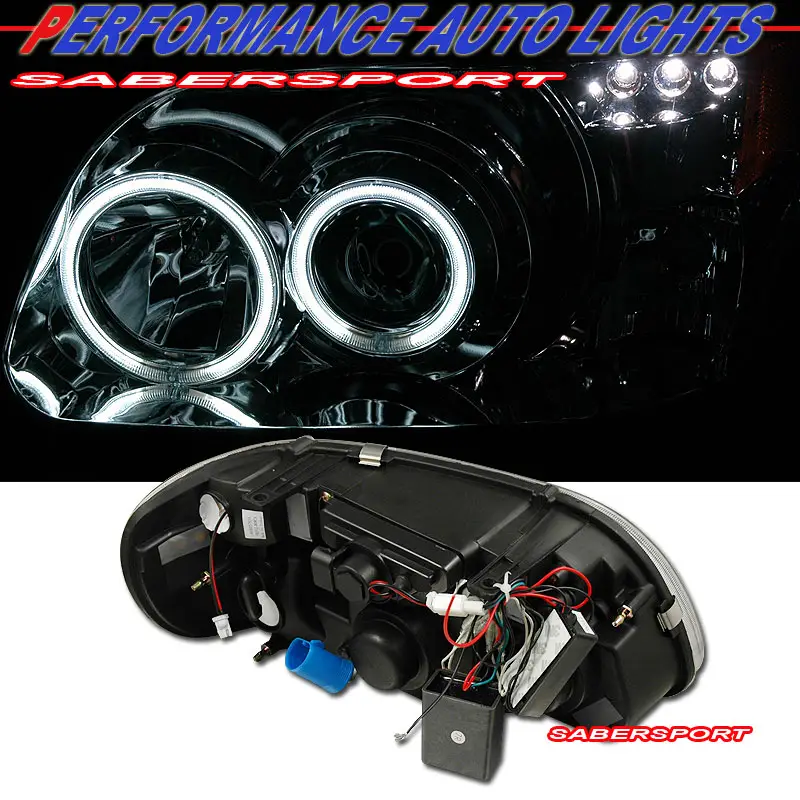

What seller did you buy the projectors from? There are two different sellers, and both appear to be a little different as far as wiring and plugs go.
different? How? Lets look:
look to be exactly the same?????????
ah thats no biggie, the difference I see is the others show the red wires, this one shows the red wires hooked up to the halo ballasts
The projector halo requires a ballast, the ballasts are pictured in your posted link, not pictured in my posted link.
a couple other changes also???? maybe there are two companies making these? Angel eyes appears to be one?
I know this because the halo projectors on my wifes FJ were the same way = ballast.
good catch! I am going to ass u me that the ballast are included in my order
the housings appear to be 100% the same, just the way they got the wires to the lights looks to be different? there are:
low beam light/reflector
low beam halo
high beam projector
high beam halo
turn signal bulb/reflector
led side markers
all wired into one housing!
Should be FUN = lots of options

if its using an h4 or h7 bulb u can use casper shields to reduce glare. doing that u can use d2/s bulbs. i'd go black housing to minimize the glare from an hid kit. looks like the hibeam is a 9005 bulb.
Be assured it is not using a H4, 9007 or any other dual filiment bulb for the projector.
When converting this type lamp to HID you will probably need the relay kit from KC that keeps the low beam on when the high beams are on. Otherwise you will have to wait for the HID to fire up each time you use the high beams. Not only is it pretty dark when waiting for it to fire up but is wears out the ballast faster.
All OEM HID projector lamps do not go off when the high beams are on.
