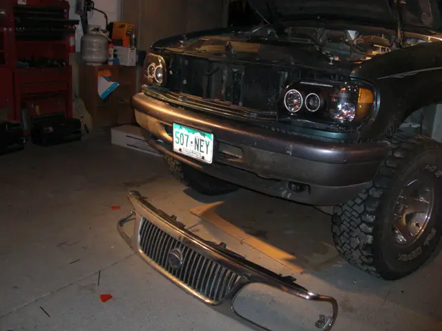

Looks very good, but what were you saying about fibber glassing? Should it not fit perfectly? Am I over reading something ha could be I seam to be good at the.
it now fits the stock location 100% but yes I did have to cut some of the header panel to clear the entire housing , dust covers, light sockets, wires, etc.
I like to do things RIGHT, the top two screws come off and then just pull and it comes out like the side marker would. (see pic, I left the fiberglass powder there for the picture so you could see the area I cut)
In order to aim the light it must be removed, aimed, replaced... so I took my time, re routed the wires as needed so it installs and removes smoothly each time.
The clearancing I did to the header panel does not effect the stock housings in any way, I just opened existing holes, I can put the factory lights back on anytime
The header panel is made of fiberglass on these trucks
A round and flat file made short work of those areas after marking with a sharpie.
This is turning into the write up! LOL saves work later.......

So if I'm understanding right, you did not have to cut anything that was painted like the grill? Just mod the header panel?

the only thing I cut was what is shown, I would not cut the radiator support or grill to fit lights LOL simple clearancing of the header panel

okay drivers and grill installed, I took lots of pictures, but I am done for the night so here are some teasers until 2009
