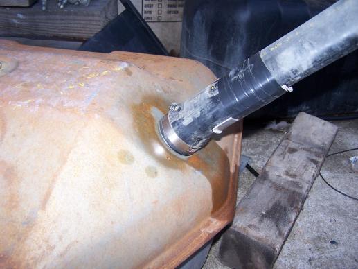

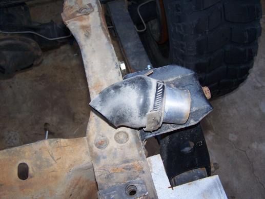

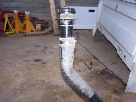

Got a chance to work on the truck some more today. I got the rest of the gas tank skid plate mount welded and painted. To finish it I just need to make some straps to hold the tank to it and then drill 4 holes in teh bottom as drians for any water that gets in there. I ran out of paint so I could paint the cross member or give the gas tank a coat of paint. I also got the filler neck kind of figured out. If you cut the last 5" or so off of the ranger filler neck it will fit on teh BII tank. It is kind of a PIA to get on but between my brother and I we were able to wresele it on within a few minutes. The part taht I still need to figure out is how to extend the filler hose line about 6" more so I can cut a hole in the side of the bed and install a jeep TJ gas deal like trckmagic did on what of his explorers. Untill then the filler is behind the bed and I will have to pull it forwward a fill it through the wheel well. Hopefully next weekend I will get more time to work on it and I should get it wrapperd up. Now onto the pics

Second shows how much of the ranger filler neck I cut off to make it fit the BII tank.
Third shows the ranger filler hose on the bronco II tank.
Fourth shows the area I need to extend. I somehow need to make this about 6" longer.

The end of the filler hose I cut off was like 3.25" in diameter. The inlet on the BII tank is 2.5" If you cut the last 6" or so off the ranger filler hose right where it is oval then squeeze it with a c clamp to round it out it is 2.5 " in diameter and goes on the BII tank. Now I just need to make up that difference in length and I can get it to fill out the side of the truck. Hopefully that make sence.
Yes it does, I forgot about the ranger filler hose necks down. I should've known better, i'm on my second filler hose and my current one is showing signs of cracking :rolleyes:
