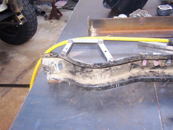

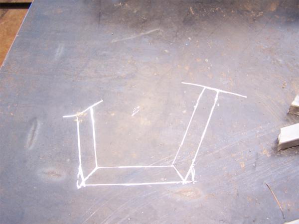

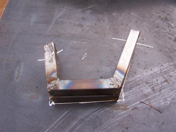

Spent a little time working on the truck today. I started by trying to figure out why my dana 44 hubs are loose. Still am not sure why :confused: Then I pulled my tranny cross member to see how I could modify it to clear the front driveshaft when the doubler goes in. So I tacked a few pieces together to see if it looked like it would clear. It looked like it would clear everything, so I marked it out on my welding table ( ilike haveing one alot)and then made 2 new pieces that are a little cleaner. I can't mount them on the tranny cross member till the tcase gets moved back cause the front Ujoint will hit it currently. I plan on adding 2 pieces to go across at the top and then box it all in with some plate steel and maybe add a gusset or two.
I also saw something on RRORC about how the 4.0 fuel pump can be modified easily to fit the BII gas tank So I am not to worried about having a problem there eather. Maybe tommorow I will get a chance to get the doubler welded up. Plan is to try and get it installed between the run in feburary and TDS.

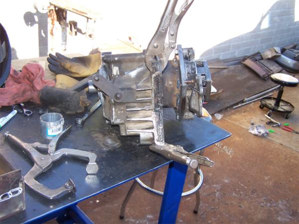

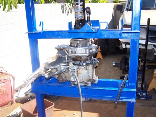

Got a few more hours to work on things today. I decided to start welding the doubler together. So I assembled it and then put it in my press to help line everything up and hold it stait while I welded it up. After I got it all welded up I relized that the tube in teh center was 1/8" to short and would let it all bolt to gether and turn smoother. I am going to get a piece of 1/8" plate steel and cut it to fit then silicone it on both sides. Hopefully it wont leak. I still need to add a drain hole, a fill hole and a small hole between the tube and main case to let the oil flow between the two. For the fill holes I am thinking of drilling a 3/4" hole in the metal then welding a nut over the hole. Use a short bolt to fill it and call it good. Anyreason why this wont work?

Lookin good so far man.
You refering to a fill plug for the adapter/tube or for the front/reduction case?
