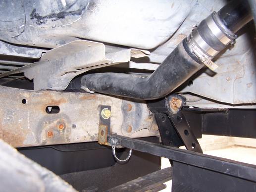

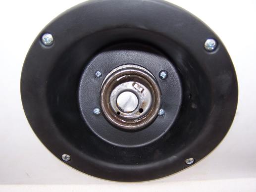

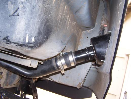

Worked on the truck today some. My goal was to get the gas filler neck figured out so I could get gas in the thing. I remembered a few years back that trckmagic from this site had used a jeep TJ support to hold his filler. So I gave the local jeep dealer a call to see if they had the "plastic housing that bolted to the body to hold the gas filler neck and hose" The guy knew what I was talking about and for less then $20 I was out the door with a piece to hold my gas filler neck.
To make it fit I had to cut about a 5.5" diamiter hole in the bed to recess it into the the side. What a PIA with a 4.5" grinder but I was finally able to get the hole in there and make it fit. I went to Home depot and picked up some #10 and #8 self tapping screws to make it go on. I had to extend the outer hose about 2" to make it reach. Luckly I had an old filler neck end to cut up to get a piece to splice it together. Few more hoseclamps and off to the gas station to see if would accept gas.
It took gas fine. Only down side is that it ios iffy to just lock the handle and let it run. I held in and had no problems. So no washing the windows while it is pumping gas.

That turned out pretty cool there Matt :cool: I was thinking, could you have used the old filler door assembly deal? If I remember right it's just a few spot welds and it's out. Just thinkin' out loud :rolleyes:
The old filler hole is going to be where my on board air hookup will come out at :D I dint look at taking it off and trying to move it. I thought about trying to build my own thing but when I called jeep and it was less teh $20 for the part it wasnt worth trying to fab something. If I did it over again the hole needs to be moved about a 1/2" towards the front of the truck. Turned out fine for now though.

Matt your setup is still using the two hose filler?? I mean with the smaller hose inside the outer? Curious how you use a coupler (2" extension) with this setup?
Yes I am still using the 2 hose system. I pulled the outer hose off and then extended it two inches. I had earlier cut about 4" off the inner hose and just left it as is. It is a real PIA to get that inner hose back inside the outer hose. The coupler is basically a 2" outer diamiter tube with a pice of hose on each end. The inner hose is still longer then the outer hose. I wish I could have taken pics but I didnt have access to a camera while I was working on it yesterday till the end of the day when I had it all back together. I hope that makes sence to you.
