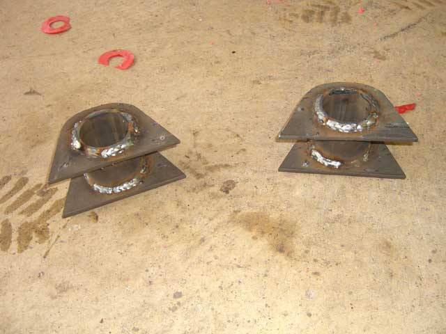

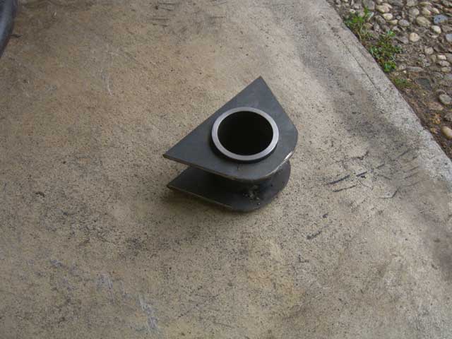

Shackle mounts. Here they are so far. They'll end up being completely plated around so you cannot see the inner tubing (if that makes sense). But they should come out awesome. :cool:
I'll be making a removable crossmember to go between the rear shackle mounts as well. Stay tuned. :D

i like the cut of yo jib :thumbsup:
in that last pic, it looks like the top plate of the right hanger is crooked.
Yeah.. it's a hair off. But I'll compensate for it when it goes onto the mounting plate. "Thank God for rubber bushings!" says B2Dude :p
But it's not as bad as it looks, that's for sure.

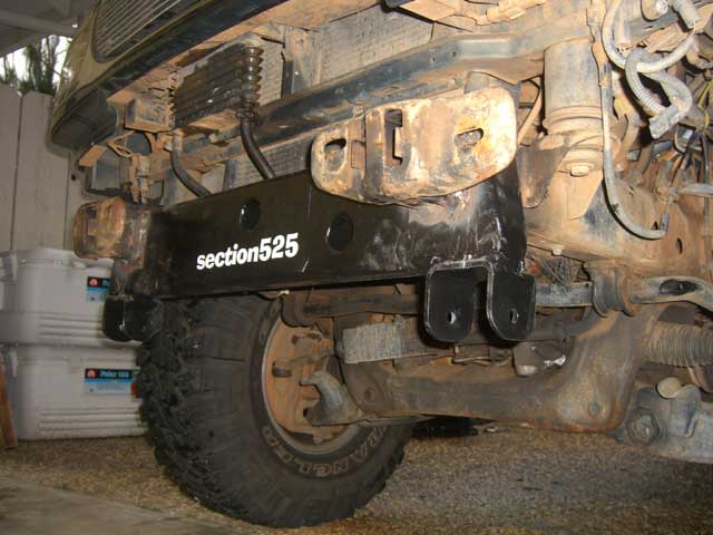

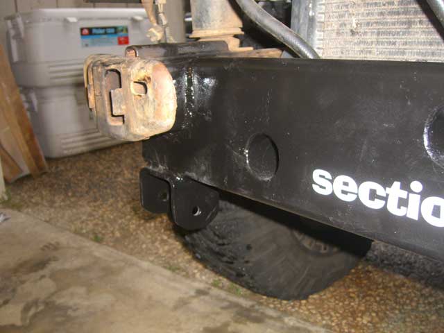

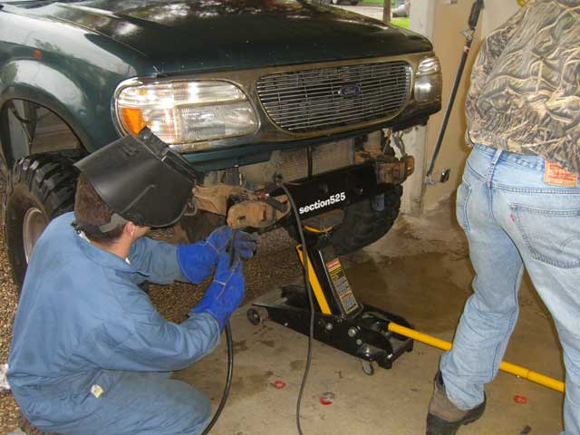

Front crossmember is offically in!
sweeett....looking good.
Smashing :thumbsup:
