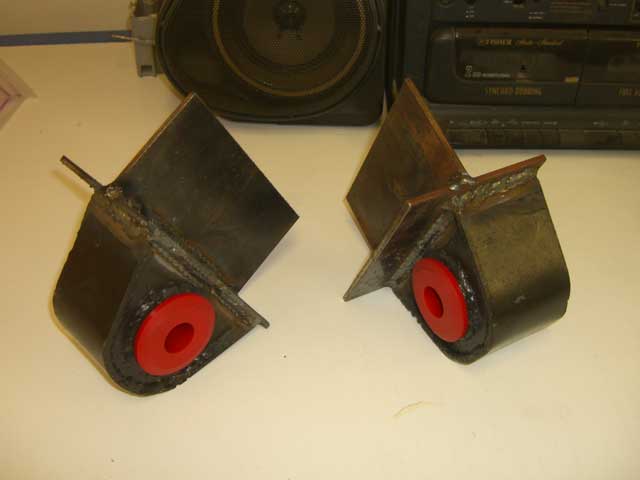

Here's the mounts ready to go on the frame. They'll be gusseted (of course) but you get the idea. Frame goes on the short side.

Now let's talk crossmembers. Since I'll be completely removing the one the control arms mount to, should I add another one between the tranny and the front members? What has everyone done? It seems like with that crossmember gone the motor could cause a lot of flex and vibration. Do you think the tranny crossmember can stay unmolested? Or will I have to hack away for the driveshaft? :p
I think the tranny member can be saved, I plan to leave mine alone, My other though was to make a new cross member for under the engine, but use the mounts from the original front axle under the engine mounts ;)

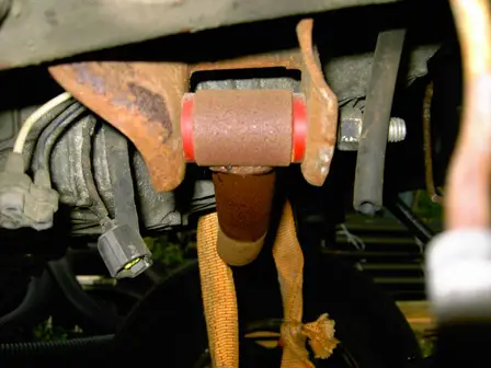

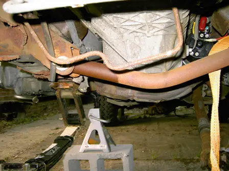

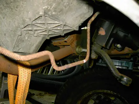

Heres pictures of mine....just some examples

I think Jefe has it right - your front cross member is more than enough.
