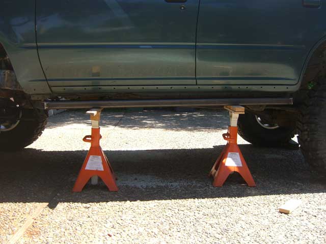

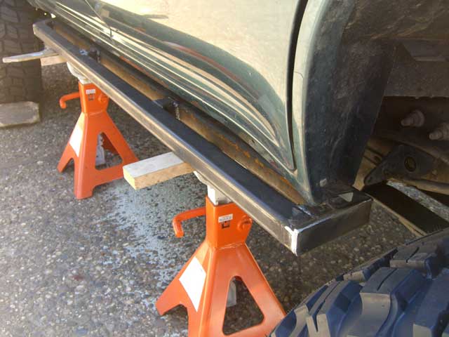

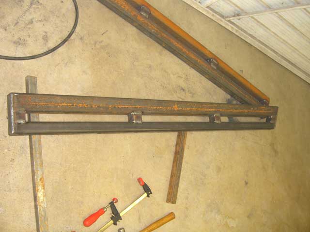

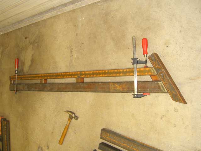

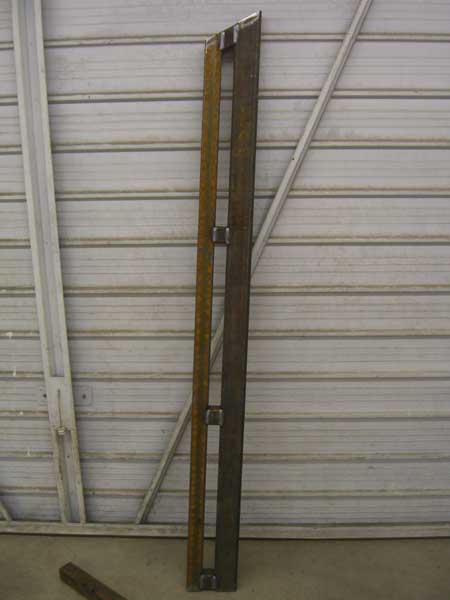

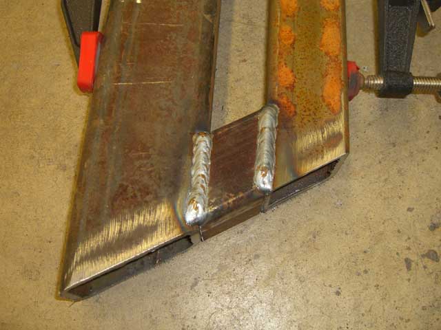

Blee did you makes yours out of 1/4"?? These ones are pretty dang heavy. :eek:
Yeah.. a little bit. :p
These things take a long time to weld up. Maybe I should break out the JB Weld.

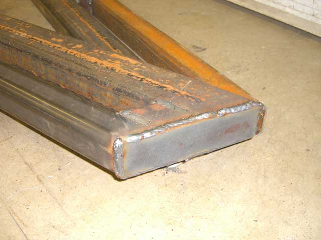

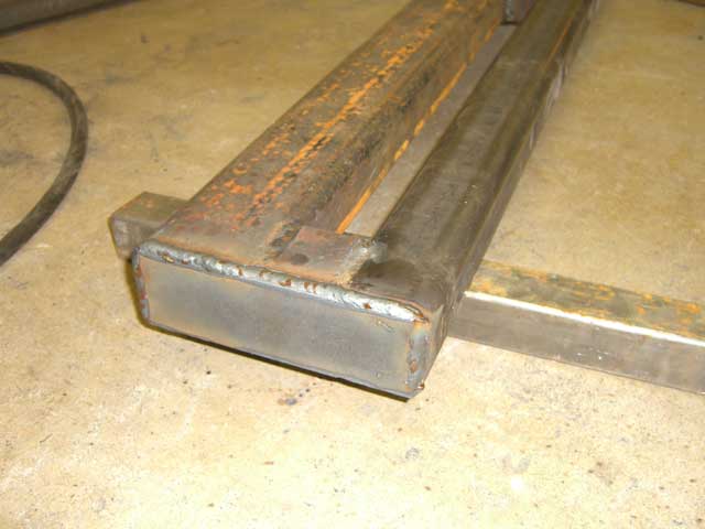

Well I got one of them all capped and ready to be almost put on. :p I used up all the 2" flat bar I had in my scrap pile. So I'll have to pick up some more tomorrow to cap the second one. :(

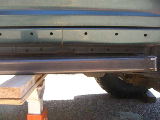

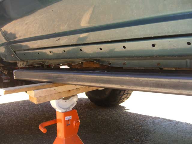

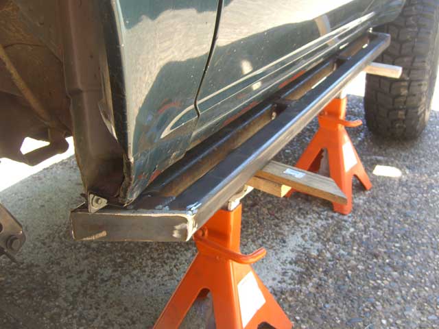

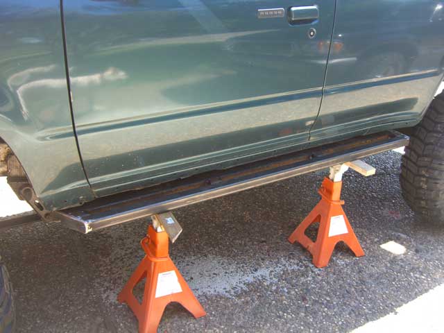

So, how close is everyone getting these to the pinch welds? Does this seem like a good spot for them?
I shouldn't cut the whole pinch weld out, correct? So I think this is about as close as I should get it.
Colin, Stuc-o, Jefe, anyone? :p
Mine are butted up against the ouside face of the pinch weld (not below). Is there a reason why you want them underneath it like that? I have yet to hit the pinch weld on anything since the sliders were built, (And i spend ALOT of time on them ;) )
