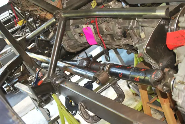

Had a few hours of free time today so I cut down the Chevy S-10 driveshaft to proper length -- well the back still needs ~1/2" removed but I'll ask the shop to do that during retube.
what's keeping that double cardan in the middle of the driveshaft from spinning all over the place?
You :p:

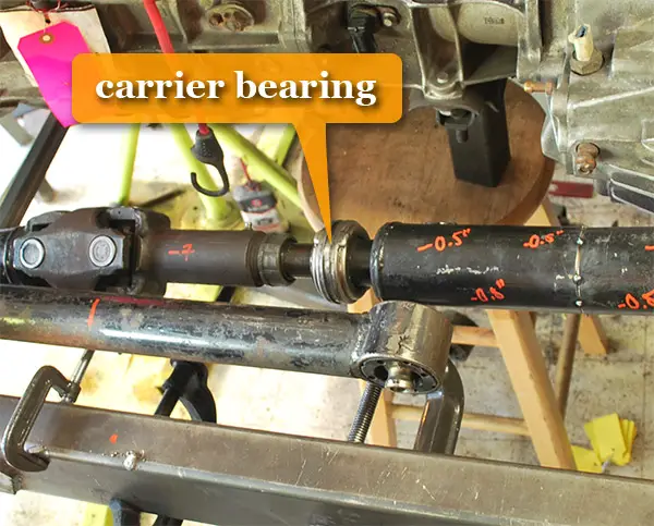

Kidding, it will have whats called a center "carrier" support. It already has the bearing on the rear stubby driveshaft, I just need my brother to turn a mount (looks like two clamshell halves) for it on his lathe.
Looks like this in stock format:
A better shot of the carrier bearing.

Which one is the carrier bearing?
