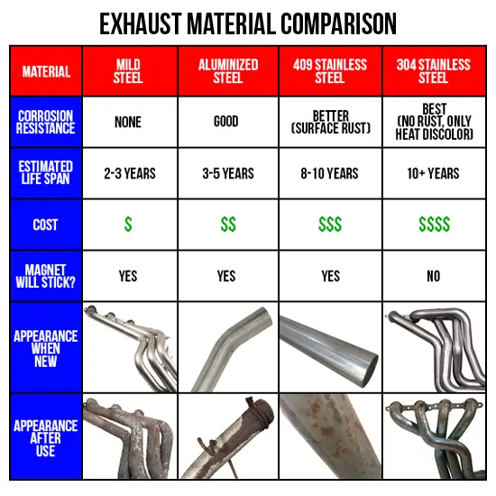

The dents in the tubes should not hurt performance, but I would address the corrosion.
I Thought the headers were constructed from stainless.
thats what i thought to. when i had the guy look at the broken header, i also said i dont think its stainless because stainless doesnt rust. he had said unless its (insert what he said here) stainless because that will rust.
400 series stainless steel will rust a magnet will also stick to IT IT is stainless steel factory exhaust systems are usually made of this type of stainless steel
Your exhaust tubes do look like they are made from 400 series stainless steel
