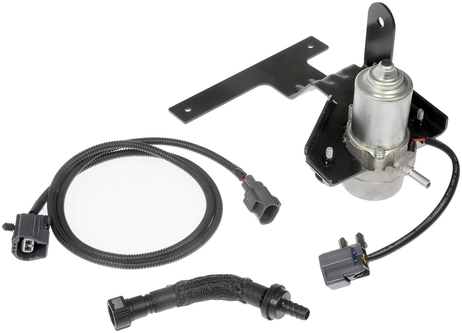

not much has happened lately. went to the wreckers and got my vacuum pump. even hooked it in to try it. with the truck not started since november, plugged the pump into the battery. instant soft peddle and not rock hard. will have to find a spot for it. might mount it between the fender on the drivers side.

I really want to see how that vac pump works out, and how you plumb it! Everything is looking amazing.

i literally hooked it to the battery (just to test it), then from the pump directly to the brake booster. what i will do when i go to do it permeantly is have a pressure sensor in it wired to the terminator. when it drops below 15 inches of mercury the sensor will tell the terminator to send power to it until it reaches 25 inches of mercury then shut off. will also wire a relay in as well.

What did you pull the pump out of?
i think around a 2014 grand caravan. i went on rock auto to see what had them, this is what i found
and this is what i got along with the hoses that go onto it and to the booster just in case
wasnt hard to pull because someone was there before me and took off the upper intake. its bolted to the top bellhousing. needed a 13mm and a deep 15mm with a breaker bar. not sure what else you would need because it was out in the open.
now if you look at summit for the kit they sell, 2 that popped up look to be the same pump, only mine was $20
