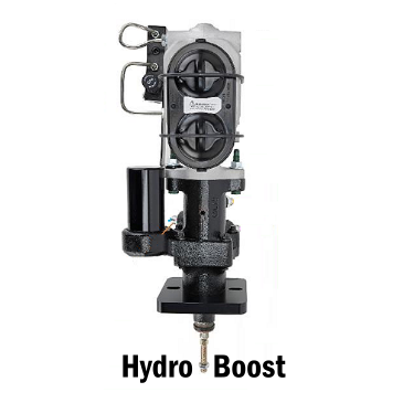

Hydroboost is the best route
Info is scarce but if you look in the ranger world you can find others who have done it. The mustang or Astro van hydroboost can be adapted to your Master cyl easily and it Bolts to the firewall
It’s been years since I researched it, I want to use hydroboost in the 331 ttb sport trac I build. Mustang got hydroboost in 96 i believe, no room For Booster under that hood

It just gets a hydro high pressure line from the power steering pump and then the high pressur line goes to the rack and pinion… otherwise it bolts in place of the old Vacuum Booster
Delete 4wabs and convert to hydroboost brakes = for the win

did a little digging. this is what i found on a hydroboost system.
just scares me to all the plumbing involved lol. mustang ones might be out just because finding a v8 car with that much still intact would be hard, that is for used stuff.
Hydroboost makes more room
