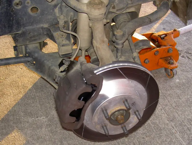

I've leaned towards either the SD Ford pads, or EBC green, or the Powerstop pads like you linked to. I have those on now, and have a little more squeaking than the HD Ford pads. Ford has more than one for the 2nd gen, this SD pad I found on Amazon a couple of years ago, and they performed very well in my extreme usage.
So I suggest that pad, about $58 last I checked, and a good slotted rotor by a good brand. You can get SS lines, but be sure they are a top brand, they should be direct replacements and not cost over about $20-25 each.
Here's the cryo rotor I put on my 99 years ago, these are 12" for the 01 Sport Trac spindles.
You need the best you can get for the much heavier wheels, and towing. there isn't much else to do beyond custom stuff, and that's really expensive.
