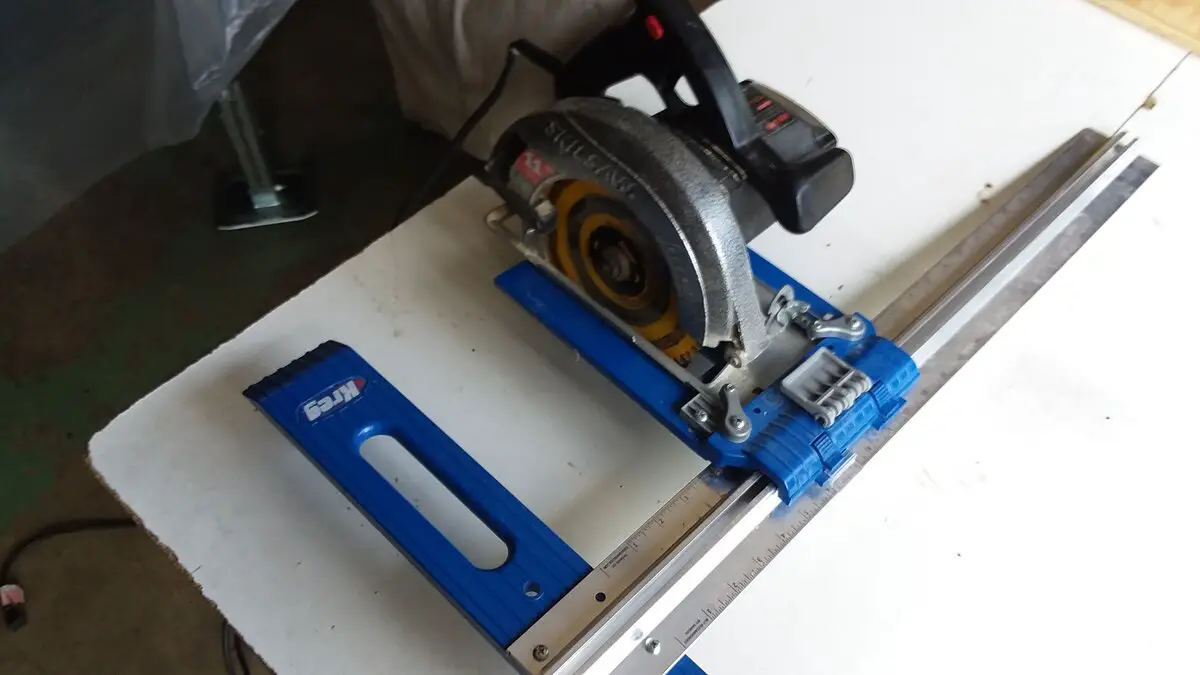

Now I do not own a table saw, and making straight cuts is important. I have other means and methods for this. I mention this for those like me, who want to build stuff, but don't because of lack of certain tools. I would actually buy a table saw, if I had room for it, but I do not. These methods work for me, so it is how I currently cut.
For straight or rip cuts using a skill saw, I have 3 different methods for nice smooth even straight cuts. Krieg skillsaw guide is good for up to a two foot, from a factory edge. It clamps on the saw, and you adjust the width on the built in ruler. Simply slide it along a factory edge cut, and you will have a nice clean cut. I also have a clamping straight edge saw guide for larger cuts, that works well. For smaller cuts, I have a different setup, that uses nothing special, and everyday shop tools. More on that later.

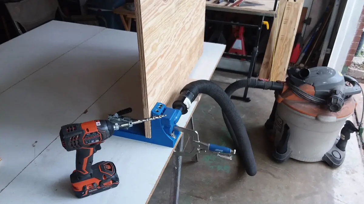

Once the cuts was done, it was time to put the pocket hole tools to work. These make for a super strong joint, and the special pocket screws come in many lengths, with course or fine pitch, for soft or hard woods. I used multiple sizes and both thread types in this build.
The shop vac attachment keeps this job clean as you drill out the angled pocket holes in the jig.

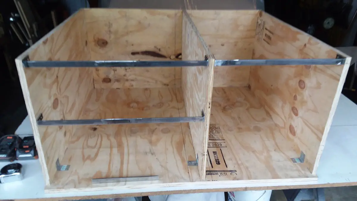

The box was put together after all was drilled out. This box has two sides to it. Each side will do it's own thing for different purposes. I changed the widths of each sides a couple times as I went, until I was happy.
Since this box is bottomless, it needs some type of frontal side to side support. I cut/welded some 3/4" angle for this. I also added a section of it to the underside of the top, to use for a latch catch. I have a few left over stainless T handle door latches from the trailer build, so decided to use them.

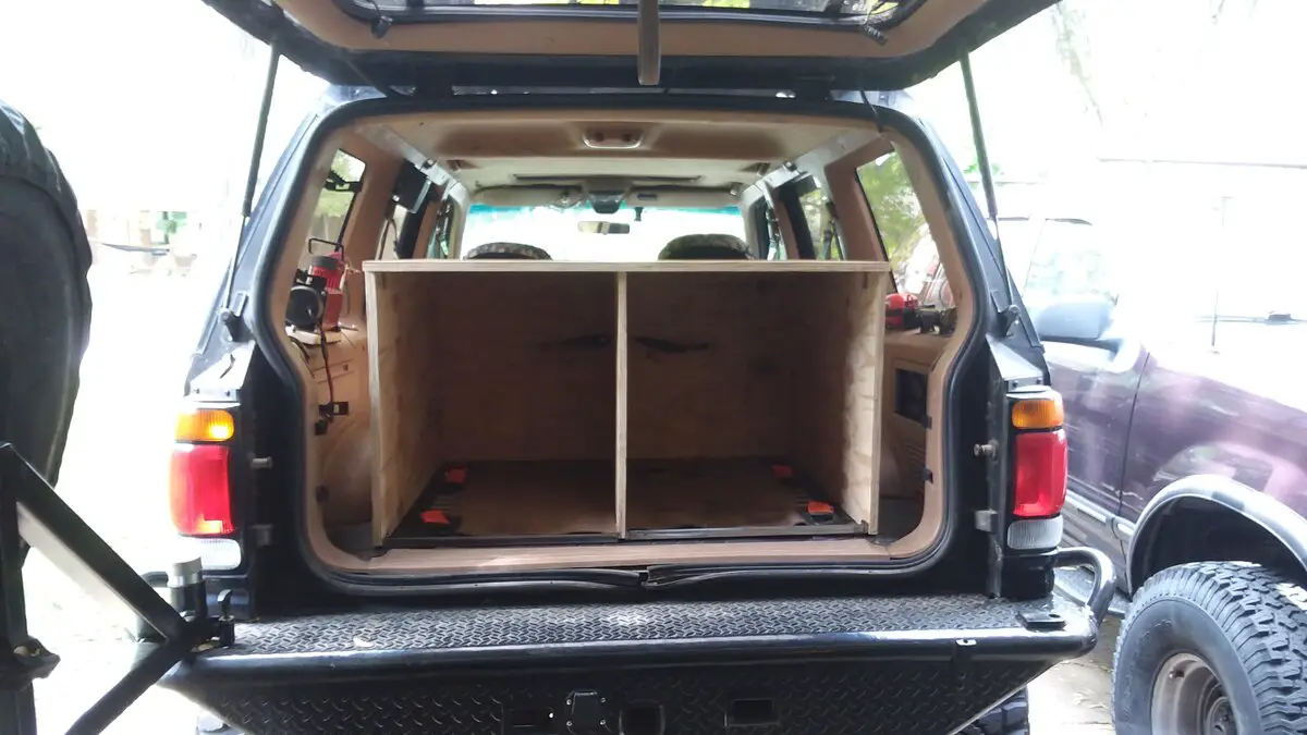

So a test fit was in order. I found it to be a little too tall for my liking. I removed it, and cut all the walls down a couple inches.

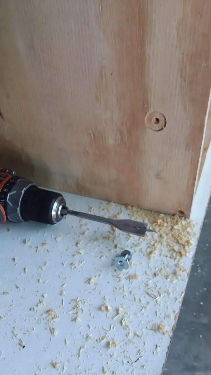

Next up was getting hardware fitted and installed. Making all the holes prior to any paint or finish work helps for a cleaner finish.
This needed all hardware to be inset on any finished surface. Which turns out to be almost all of it. lol
I learned that having a screw or bolt going thru wood, needs a sleeve to stop the wood from wollering out, and making your job a sloppy one eventually. There are a few ways to accomplish this, with different hardware to use. I choose to use Tee Nuts. I found these to work best in my projects. They have spikes that dig into the wood as they are compressed, and stay put once seated. The threaded shanks on them come in multiple sizes, and you choose the length according to the thickness of the wood your using. For 1/2" wood, I use 7/16" shank, for 3/4" wood, I use 9/16" shanks.
Finding center with an appropriate sized hole punch, then drilling a small 1/8" pilot hole all the way thru, keeps everything where it needs to be. After that, using a spade bit a little larger than the tee nut flat end is, a shallow hole is drilled to allow the tee nut to be recessed flush.
Switch over to a drill bit a fraction larger than the OD of the tee nut shank, and drill all the way thru the 1/8" pilot hole. This allows the tee nut to set inside tight, and centered. I used both #10-24 & 1/4"-20 tee nuts on this build. #10's use a 1/4" drill bit, and 1/4" use a 5/16" drill bit. For the spade bits, a #10 nut takes a 3/4", and a 1/4" nut takes a 7/8"
Those shavings are from one single cut/hole. I did dozens of them on this build. What a mess!
Next on the to do was install the slides, and get them matched up nicely. Tape was used to keep the ball bearings clean of debris. Here you can see the pocket holes, and the tee nuts for 2 slides. Stainless bolts are used on everything.

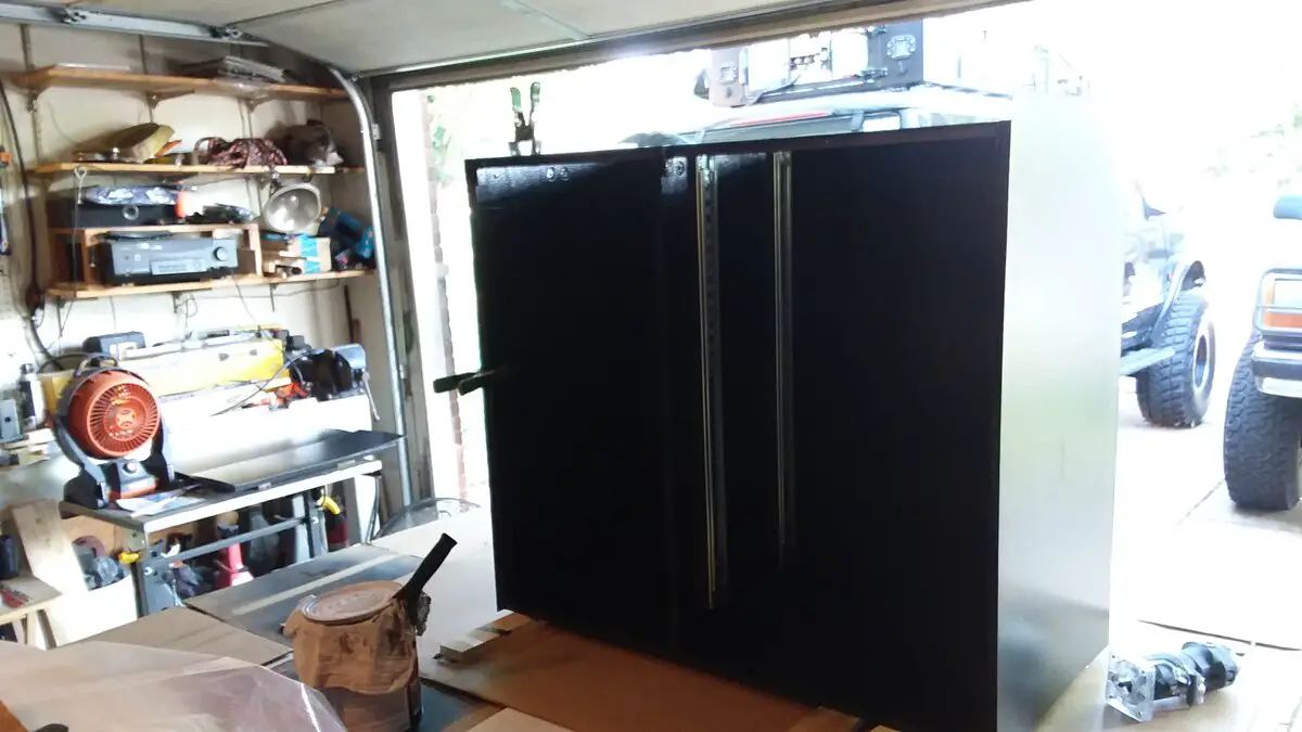

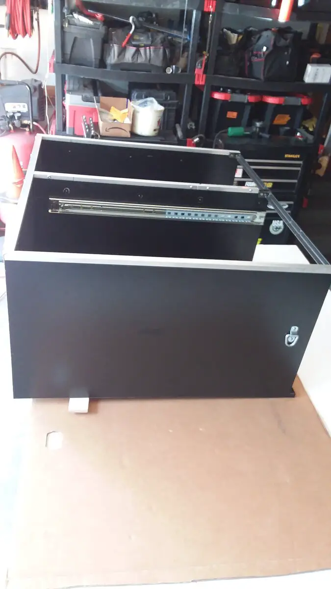

Main Box finish:
The interior of the main box, and all the exposed edge's was painted with the same Satin black. Once the paint cured out after a couple of days, I could move onto the next step.
Satin Black Laminate counter top material was used to skin the exterior of the main box, drawer faces, and a couple other items.
I had to special order this stuff, and took over a week to get it. I needed just about every sq inch of the 48" x 96" sheet. I had to really think on this one to get the cuts right. lol
Planned it all out in advance, marked the sheet for each piece, then cut to size with a straight edge and razor knife.

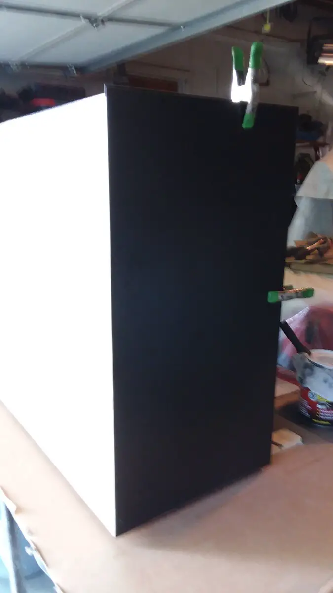

Using the highly potent fumigating glue for this stuff I made sure the doors was open, and a fan was running. Once applied (roller nap) to both the wood, and backside of the laminate, it needs to sit for 20 mins, and dry/tacky to the touch. I only did a Piece at a time, and took all day.
Each edge was cut with a little overhang all around. Once positioned, it was laid on and worked it's way from one side to the other with a laminate roller.
The laminate overhang was trimmed with a laminate router and a 1/16" Radius bearing trim bit. It gives a tiny curve to the top edge as it cuts.
Inside and all exposed edges was painted black to finish sealing up the wood, and just looks better than raw sealed wood.

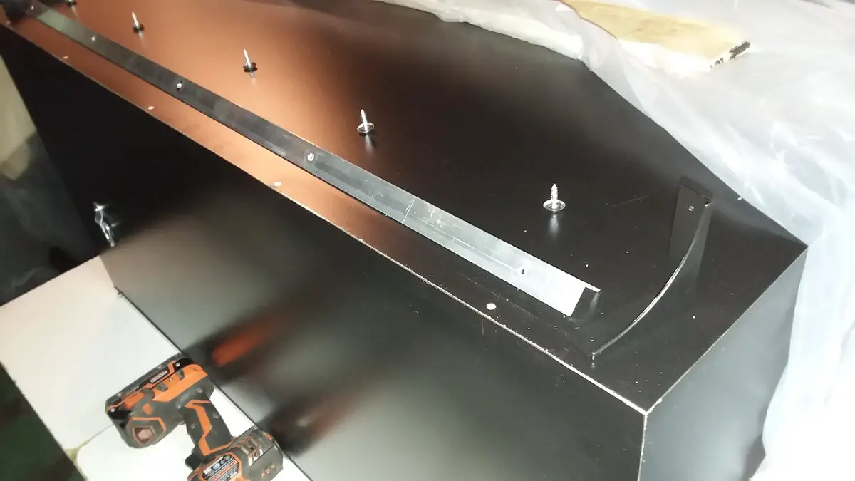

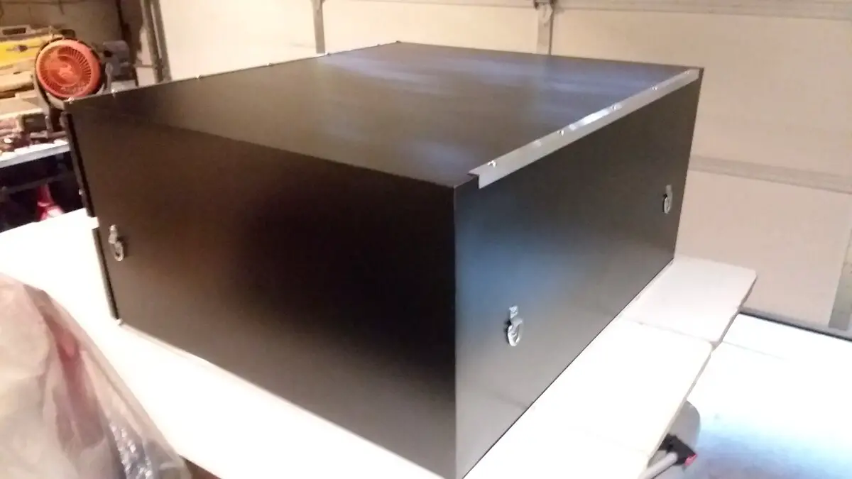

Next step was to flip the box over, and install 3/4" Aluminum U channel on the wall edges. These will act as feet, and keep the lumber off the floor, plus give it a nice smooth solid even base. The box will be secured to the rigs floor with HD straps, as I wanted it to be removable. So 4 strap anchors was installed with 1/4" Tee nuts. Two on the front sides, and two in the rear. The rig has E track on the floor for the rears, and a couple new anchors was installed onto the floor for the fronts.

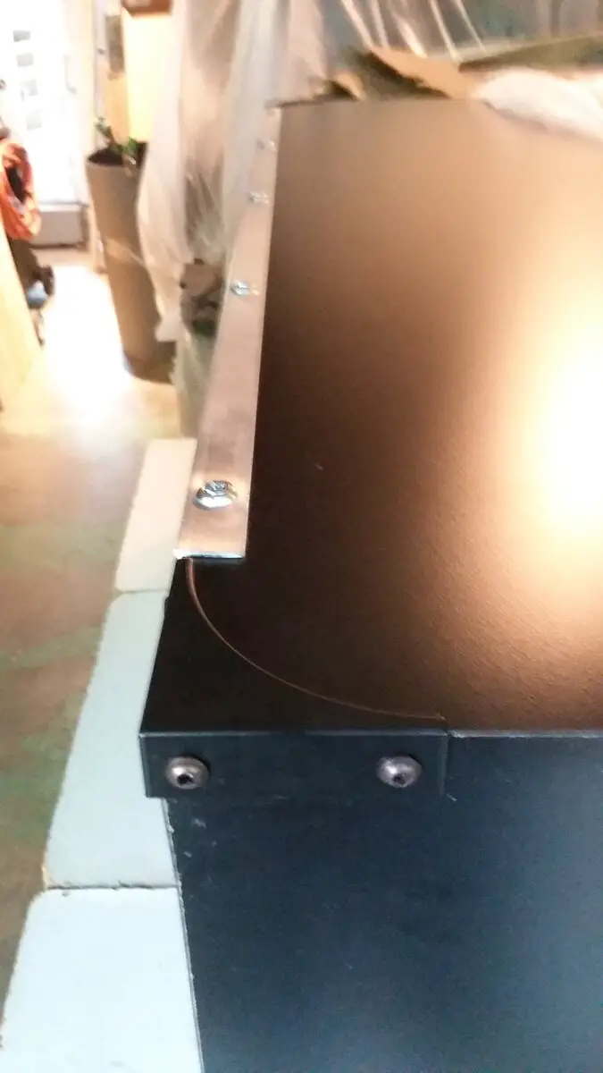

Flipped back over now, the upper edges was trimmed out with 3/4" aluminum angle, and the rear corners with metal corner guards.

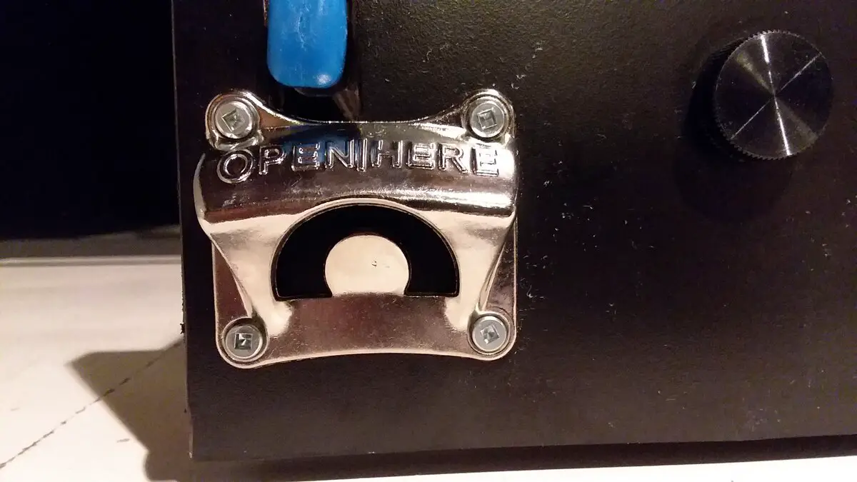

I wanted some door pulls, but wanted something different. I re-purposed these bottle openers for just that! I mean, they say "Open Here"! Makes perfect sense to me.
Odd placement, but they are below the slide locks, so you can use them as you lift the thumb lock, to assist in opening the drawer. Matter of convenience, not really needed, but gives it a personal touch.

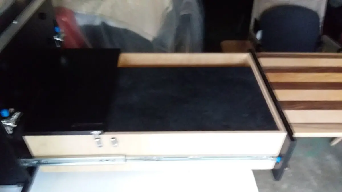

Grill Drawer:

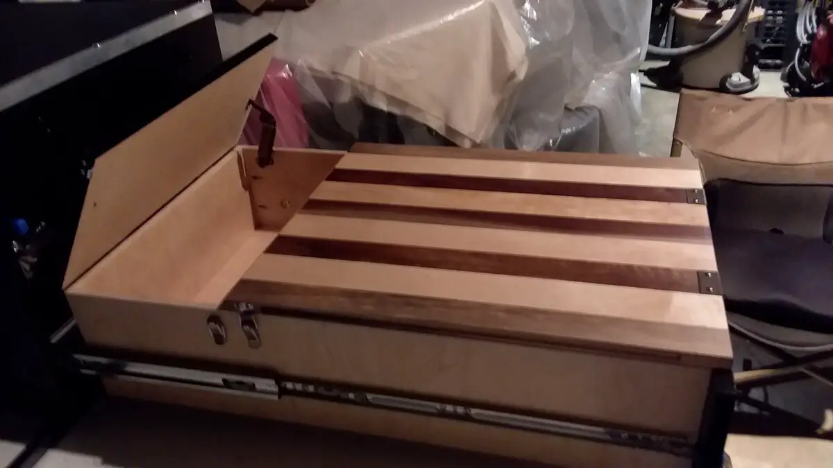

To make this box a bit more than just open storage for this and that, I decided to make it more functional. This drawer is where the build takes a turn, then veers off into the weird, and wonky.

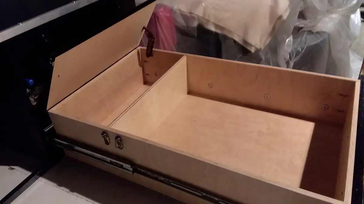

Inside has two storage sections. A small section with a lid to contain cooking items, and the other to store a grill, plus some.
I was undecided on this build for a long time, and went back and forth with different ideas. Time was getting the best of me here, and I needed to get this done like yesterday. There are other mods/work needing to be done to the rig for the upcoming trip, and this build was eating all my time up. So, for now, this is what I chose to do, but might change it up over next winter.
A divider wall was added to the Baltic Birch drawer, based on the width of a propane Coleman grill. The lid was added using hinges on the back, and a spring lift arm. A slide bolt was inset into to the top as well. As shown in the previous pictures, this lid got sealed, edges painted black, then the top laminated.
Found a local guy who made real nice cutting boards from scratch, at his home based bizz. I gave him the dimensions I wanted, and he built it right away. I had it within a weeks time. This board he made is from Hickory and Walnut. He made a nice smooth finger handle on one long edge, and treated it with Salad Bowl finish. I will need to re-coat it once a year with use. Not a big deal to me. It's 3/4" thick, and thinner then he normally makes, but I needed it that thin to work with this build.

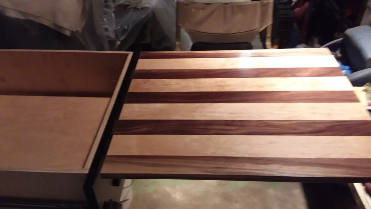

This is the thing that makes this build stand out from all the rest. At least I think so! lol

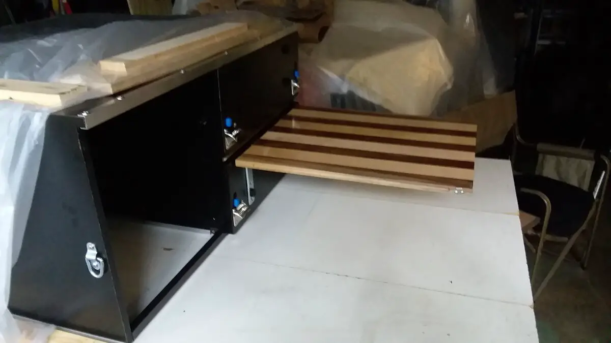

It is a lid for the grill storage, and a working cutting board when closed. Also a side table when opened.

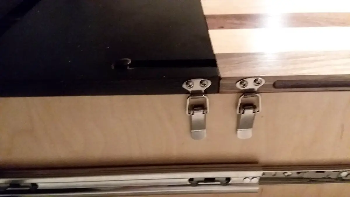

Lids held down with stainless spring latch closures.
Lids closed, drawer open.

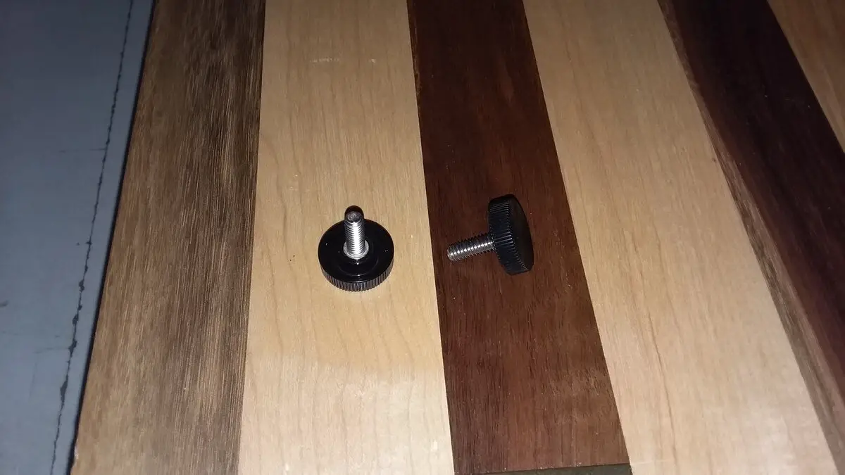

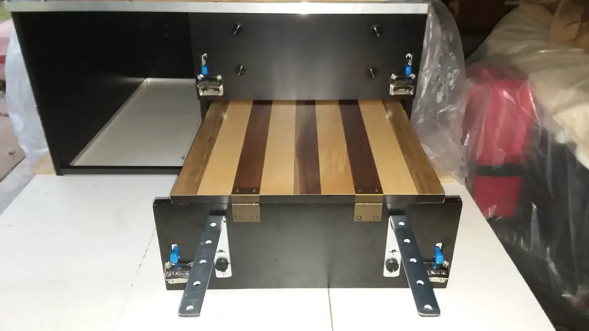

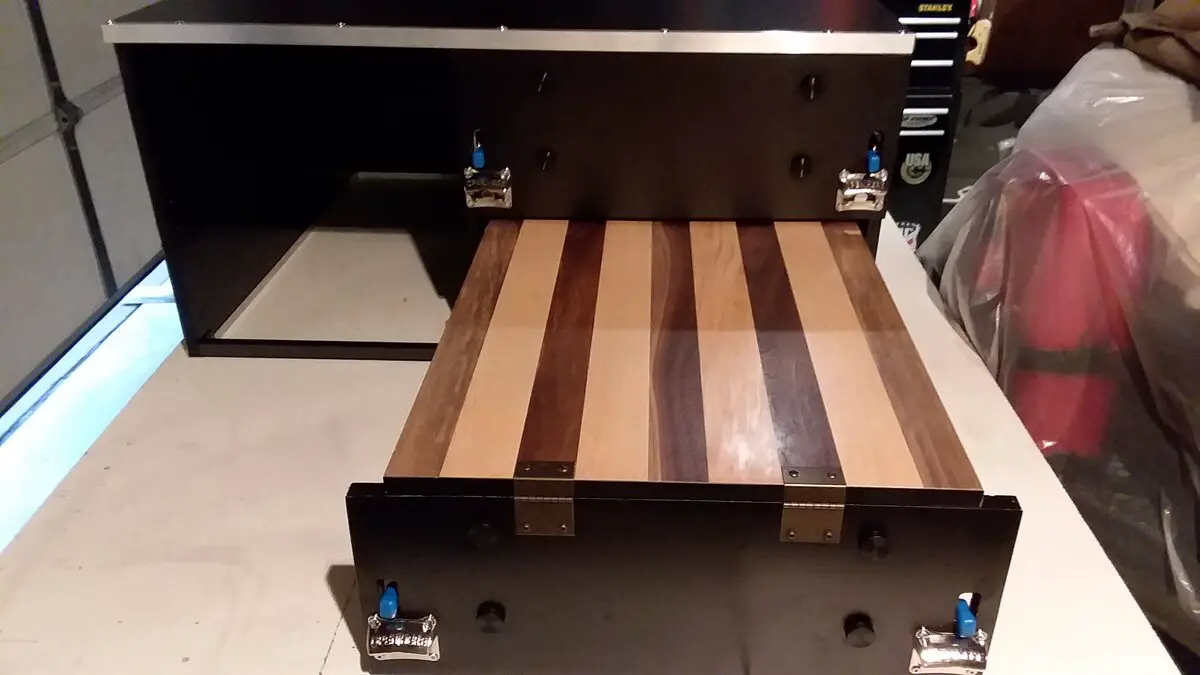

Ok, so those round black knobs on the drawer faces......
These are actually thumb wheels with stainless 1/4"-20 studs. These go into the Tee nuts installed into the backsides. These are for holding support brackets on the lower drawer, and other items on the top drawer.

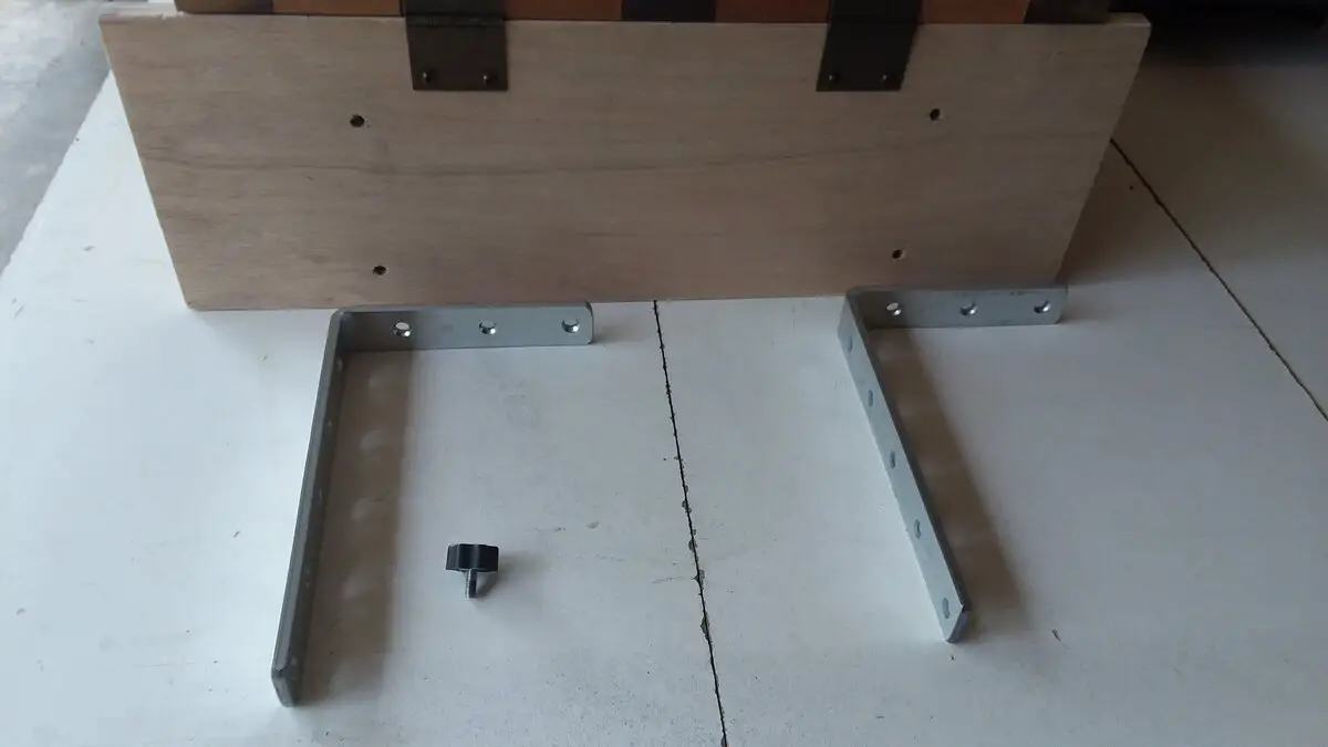

This setup is just the mock up, and not the actual bracket or drawer face I will be using. The support bracket is still being fabricated. I used these to figure this out, and can be used for picture purposes to show this in the set up mode.
Using some 1/4" thick brackets, I was able to measure and mark where to install the cutting board supports, when used as a table. Idea is to simply unscrew the knobs, slip in the table bracket, and turn them tight, holding the bracket in place. I had an old thumb wheel I used for this mock up, but bought new ones (with extras) for it later.
Can open it and push the drawer closed too.
