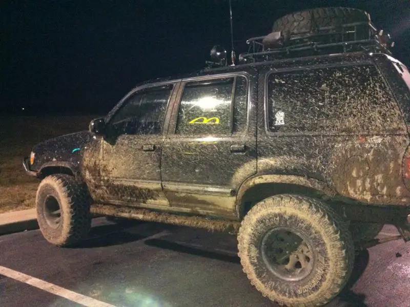

I have been leaving them square on purpose. I tried a round one and it looked like a cat's butt. Lol!! If the corners lift that's ok, as they get replaced yearly.
It's not crooked. Just the camera angle. This style deff says the true meaning behind the name. Just a money sucking black hole!! Lol

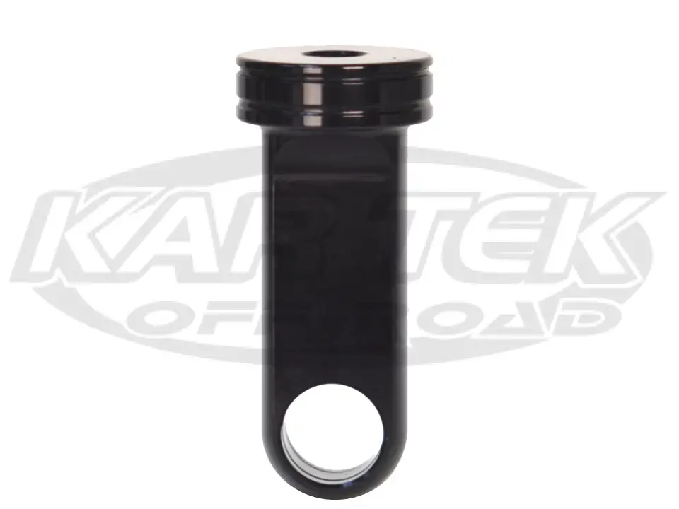

Fox makes 3 different length eyelets for the 2.0 5/8" shafts. Some people run these 2" longer eyelets on front coil overs, when they do the mod on RBV's to clear the CV boots, so I know they work. The longest being a hair over 2" longer than the shortest, which I have now. So these will give me back the 2" I lost with the new leafs. Expensive little boogers at $65/ea, but $450 less than a new pair of 12" travel shocks. So this is the solution.
Now I just have to find them in stock from a supplier, and figure out how to clamp the shafts tight to remove / install them, without damaging them. Red locktite is used on these, so a fair amount of force will be needed, even after heat is applied. I do not own the special Fox shaft jaw clamp, used for rebuilding shocks, nor do I plan on buying one for this either. lol

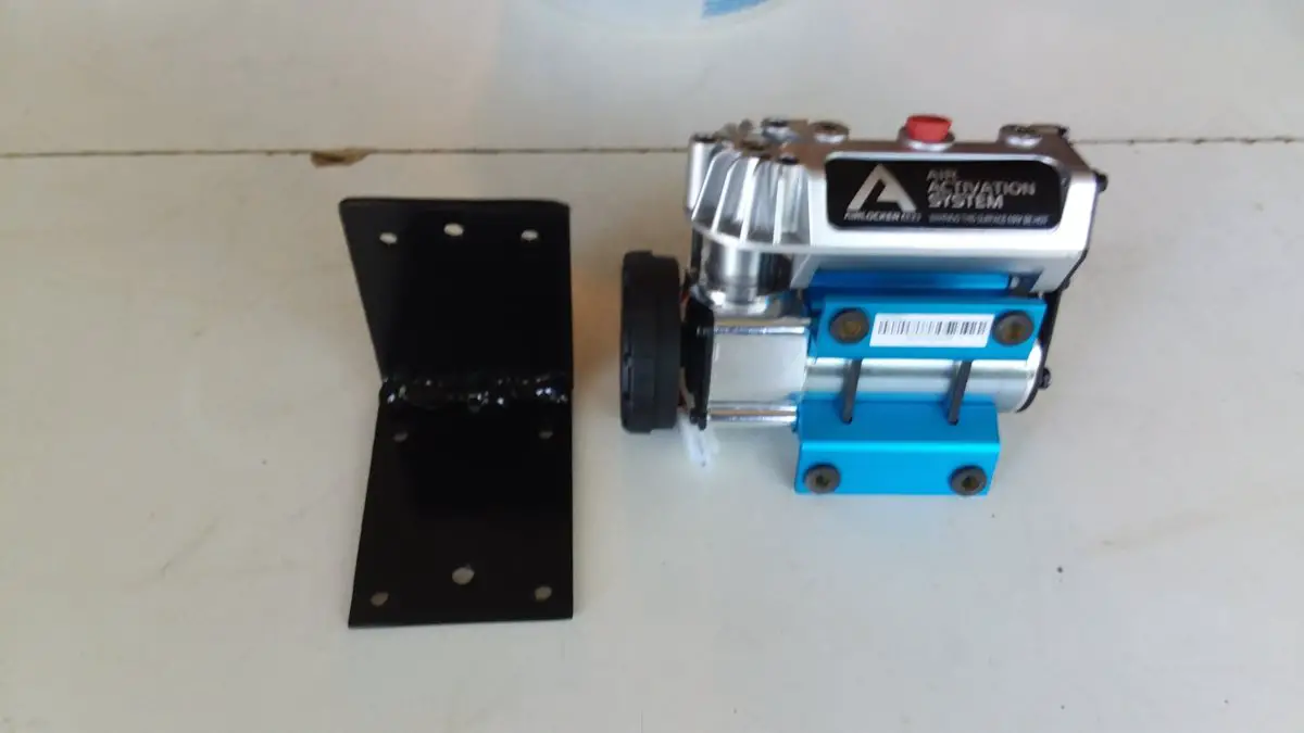

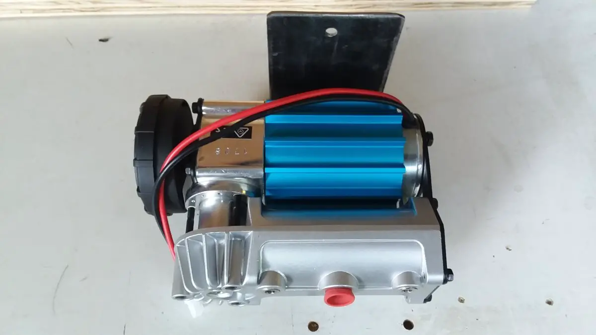

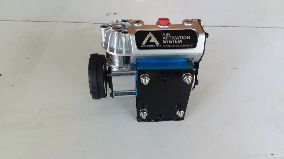

To mount it, I made a simple wide angle bracket out of 1/8"x3" mild steel stock. Drilled the holes using the ARB mounting plate as a template, and used stainless 1/4" hardware to bolt it to the painted bracket. The pump has rubber dampener sleeves in the bolt holes for vibrations, and they work well when tightened down.

After drilling a some pilot holes into the rigs inner fender, the whole kit & kabootle was bolted in place with 5/16" treated self tappers.
I turned the pump sideways on the adjustable pump bracket, so the manifold solenoid, air line, and pressure switch faced towards the engine, and not up to the hood.
