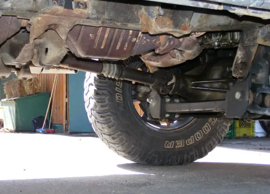

Like these?
I think these will just get in the way like the t-bars do.
Actually, that design with pivots on both ends attached to what is supposed to be a fixed assembly provides no structure support. If the box moves back the support bars will merely swing down.
That is how I see it anyway---
I think they'd help, but maybe not as much as you would think. Perhaps if one side was welded it'd help out a bit. Could probably make a mount on the front cross memeber with supports welded to it, and then bolt the other side of the supports to the chassis where they bolt on.
Only thing I don't like is they mount where the torsion bars used to be. Clearance issues all over again... Why not make a custom cross member and bolt it on, somewhere higher up...
or put them at a steeper angle, and locate them higher,

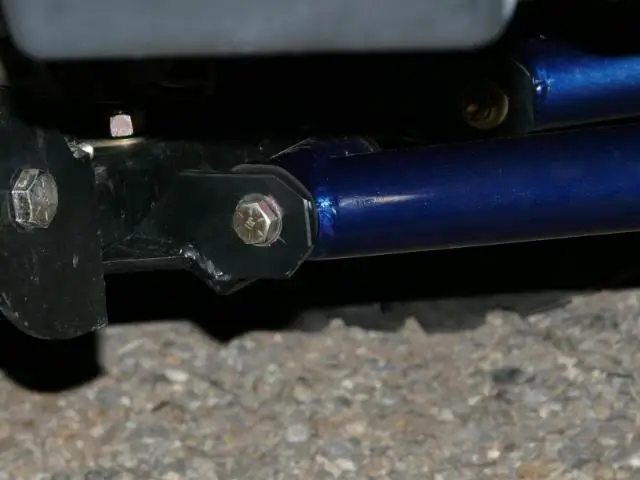

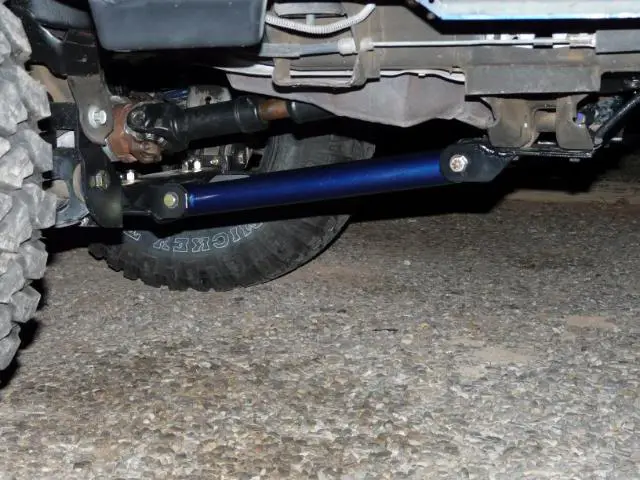

You can use it on a stock setup, I was planning to. It's also not expensive at all. The only thing is it wont help keep everything from pushing backwards, which the arms greg posted above (painted blue) would.. Now, that dixon bros cross member, with some arms welded to it that also secure to the chassis.. THAT would be the ticket =]

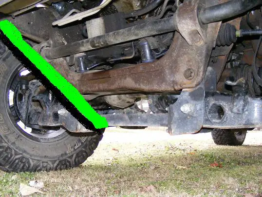

what about doing it at the front ??
it would go up from the front at a steeper angle, and keep it from going backwards as well,
kind of like this,
